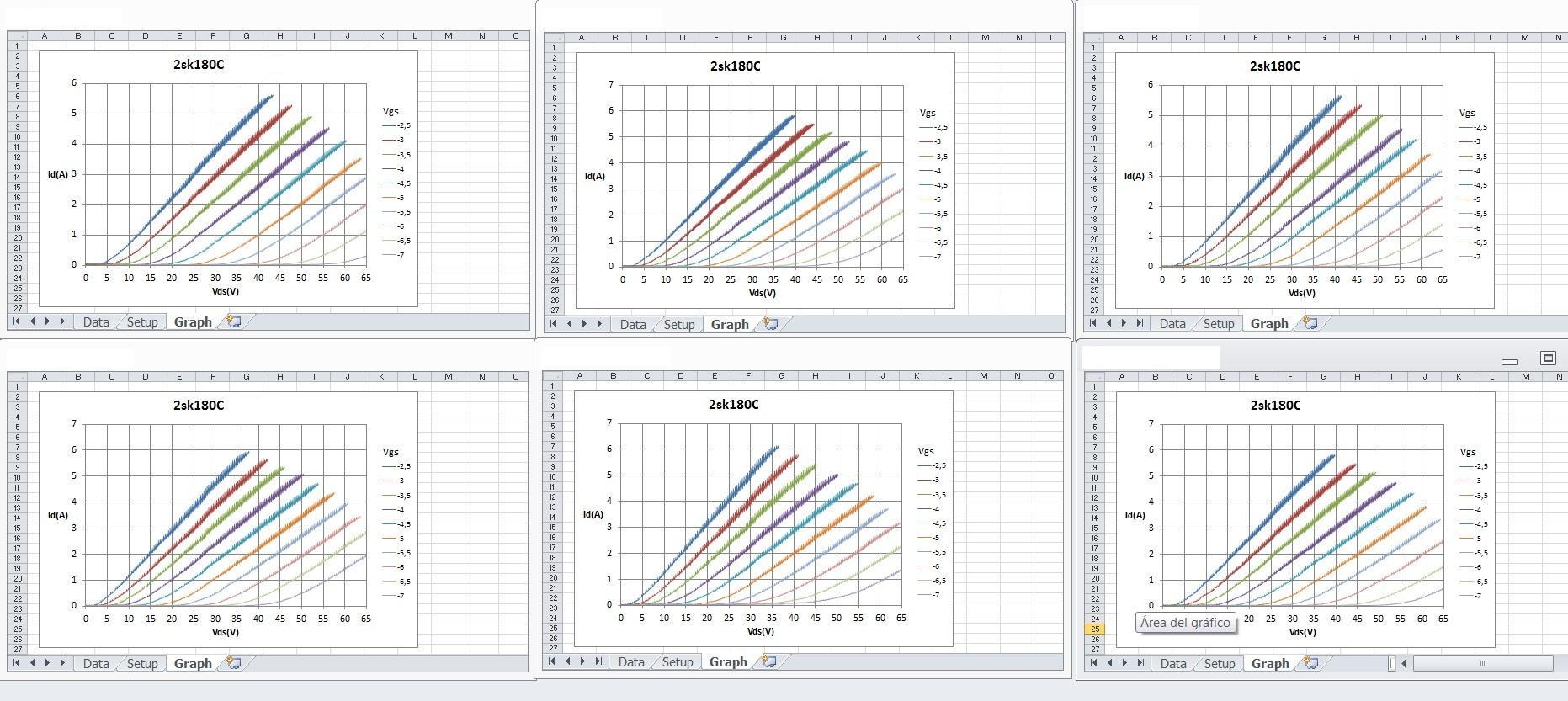

Hi Mr. Pass,
If looking to purchase 2SK180s, should we aim for a specific rank? Will it be relevant?
Thank you much,
Cody

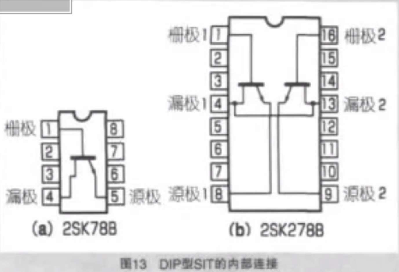

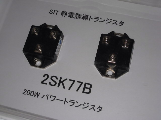

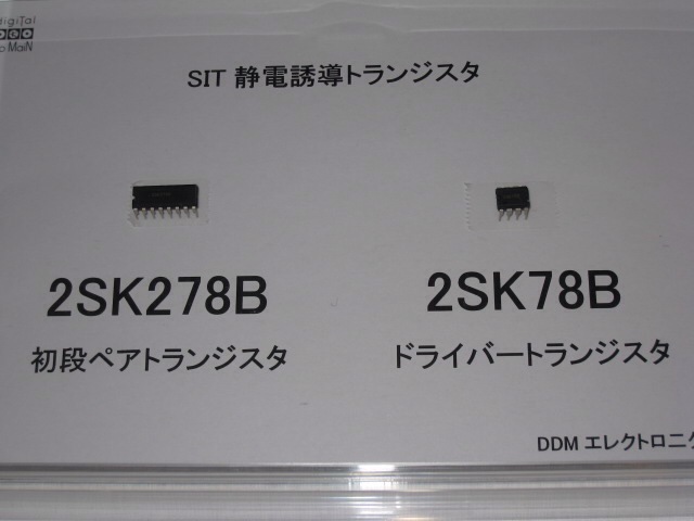

2SK77B's, I don't know where you'll find them unless you know the guy who
owns Digital Do Main. I got a few as a gift.

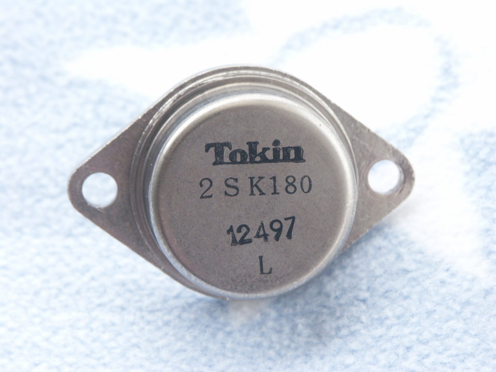

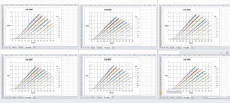

In the past, some kind DIY'er posted a pic of collected SK180 curves. From what I can tell, the C and D ranks seem to be more tightly grouped with regard to curves and higher Vgs/pinch voltage (-3 to -4V range) vs. the non-graded 180's which were more sporadic or random. Relevant? Dunno... not enough experience here, other than to say non-graded 180's would probably benefit from being match paired.

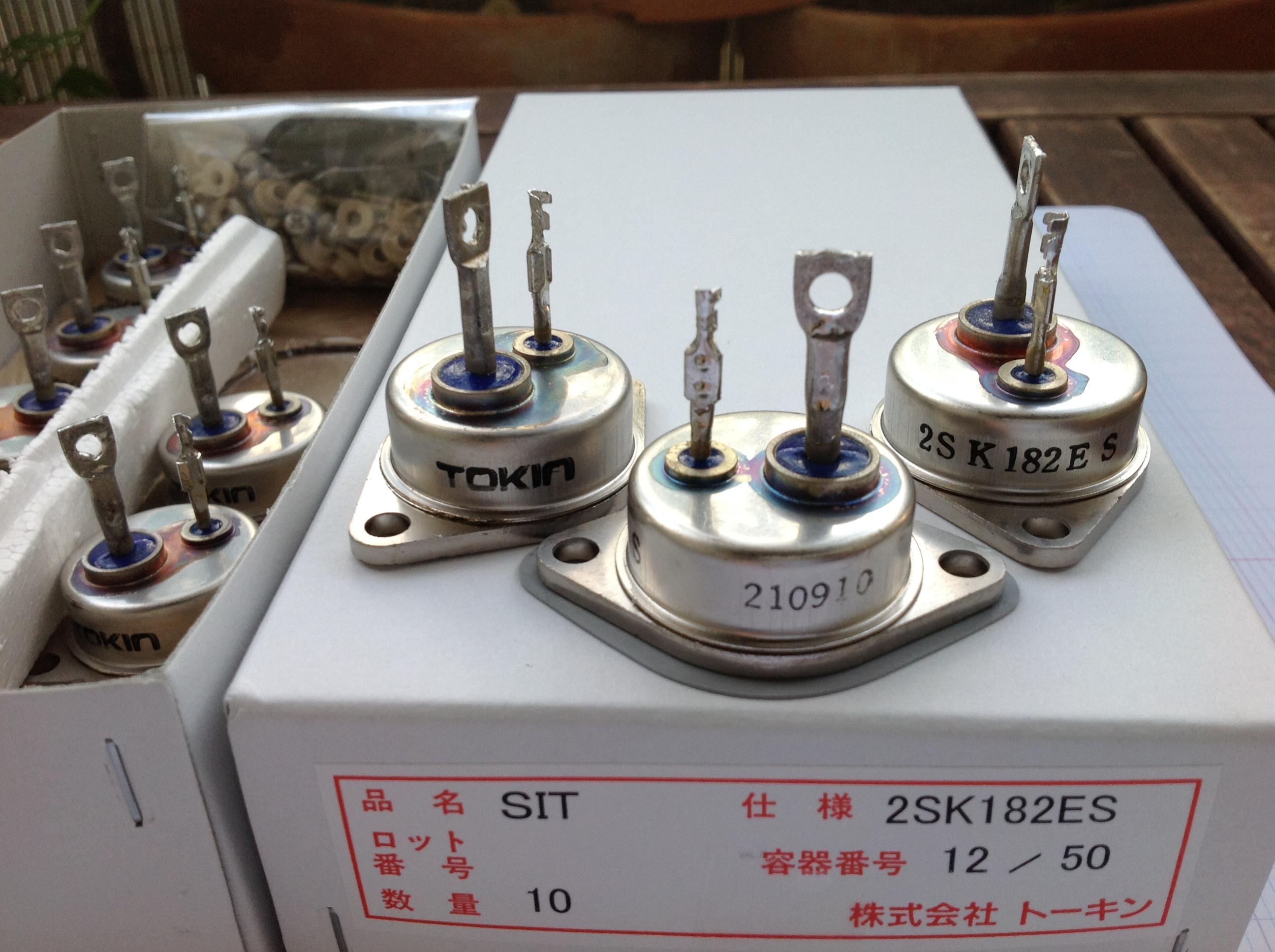

Yes was made by Jama for example. C or D are ok but X, Y, Z probably strange. More vintage series Tokin was nice as well :)

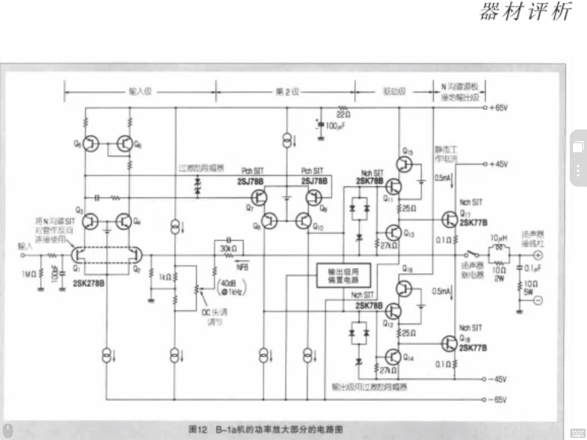

I've got your toys right here....
It's Papa toys actually :D

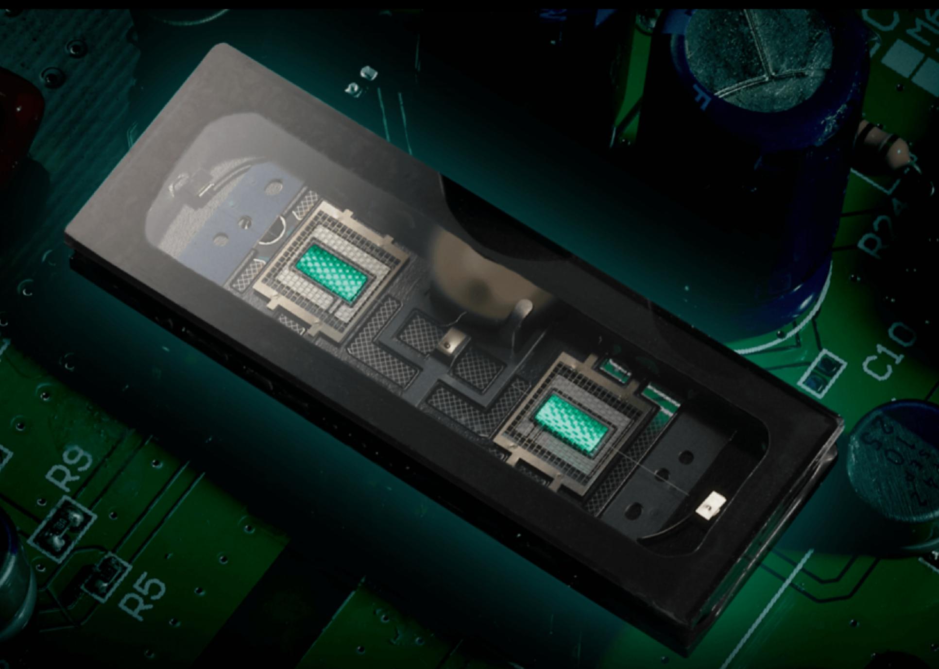

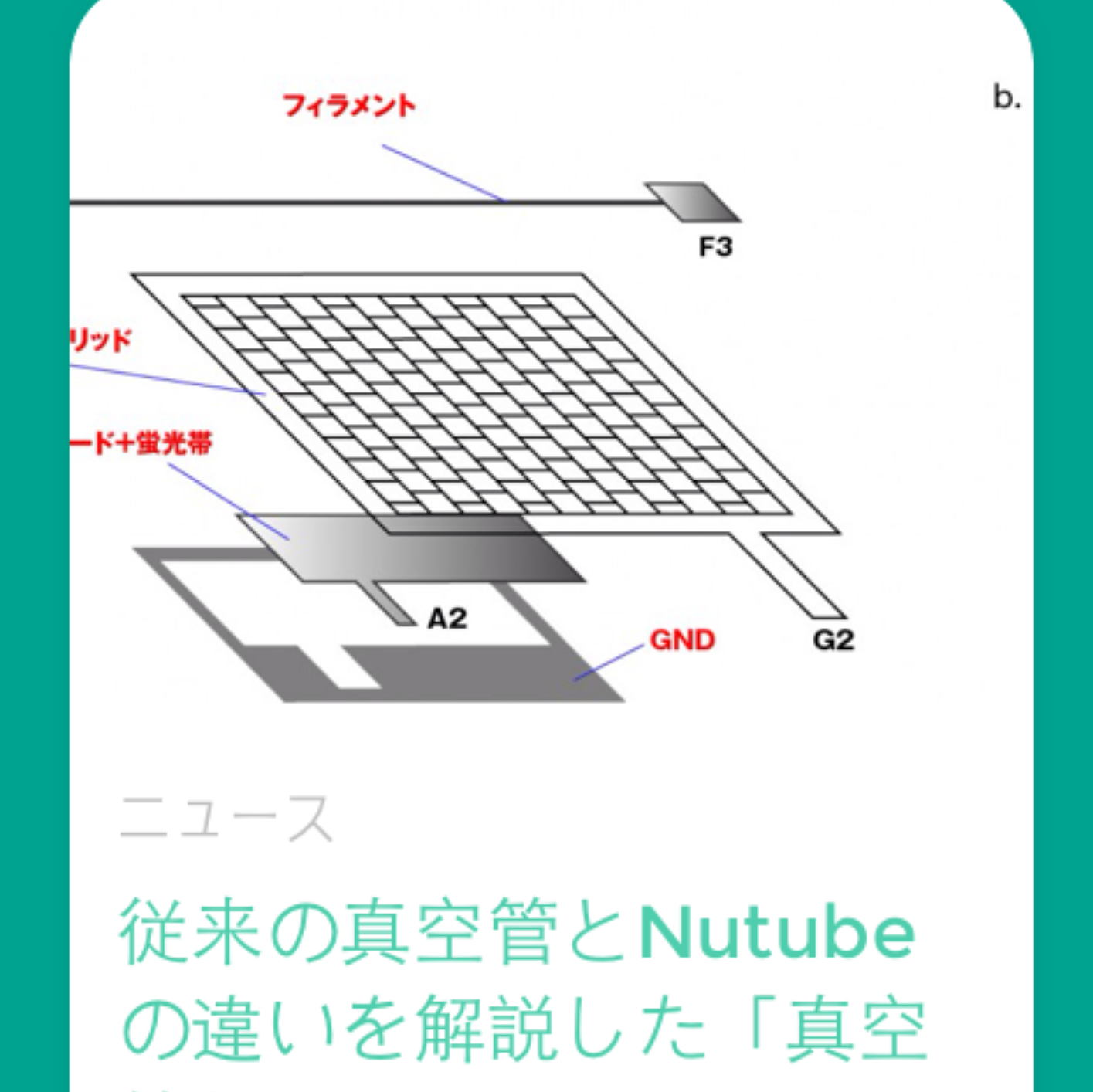

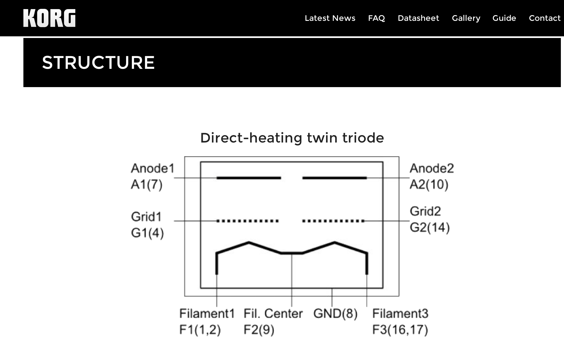

Do Mr. Pass play with hi-tech Korg & Noritake Nutube triodes ?
Delicious news if mix them with hockey puck´s or Pass Sit -1 transistors into one amplifier circuit.
:lickface:

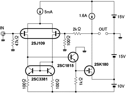

I bought some 2SK180 recently from diyAudio member Joshvi, in the swap meet forum. Haven't done anything with them yet as I have been busy playing with phono amps and DACs. in my mind, I have a vision of building out something like my current class A Mosfet amp
http://www.diyaudio.com/forums/solid-state/212424-balanced-class-fet-amplifier.html#post3018407
I obviously need to invert the polarity of this design, I have a stash of 2SJ74 at home so this takes care of the input stage. And I will also need a higher supply rail for the input stage - if the output is running on 20V rails I need to set the DC operating point at top of jfet at around 22-23Volts to achieve a bias of -2 or -3V on 2SK180. Which implies a voltage rail more than 30V (-30V actually). Maybe I will need to cascade the input j-fet to cope with higher voltage.
Other question is - how best to drive the gate of the 2SK180? The input capacitance is quite high, over 2,000pF IIRC. And since the device is in common source mode, there is miller effect to consider. I may need a source follower between input stage and 2SK180, and probably needs to be a reasonable current to maintain slew rate.
What other circuits are folks around here pursuing?

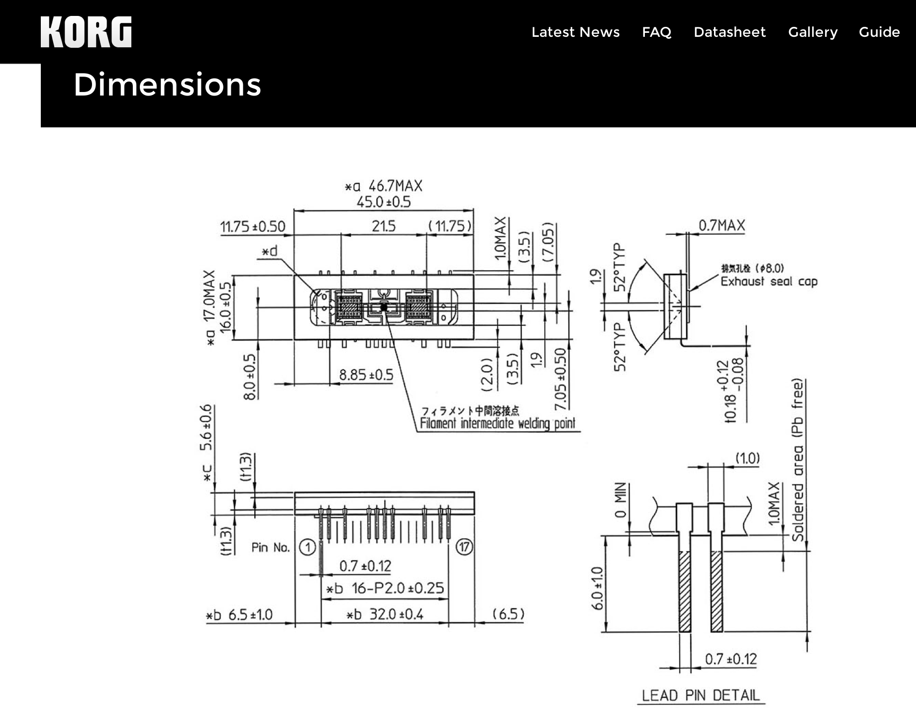

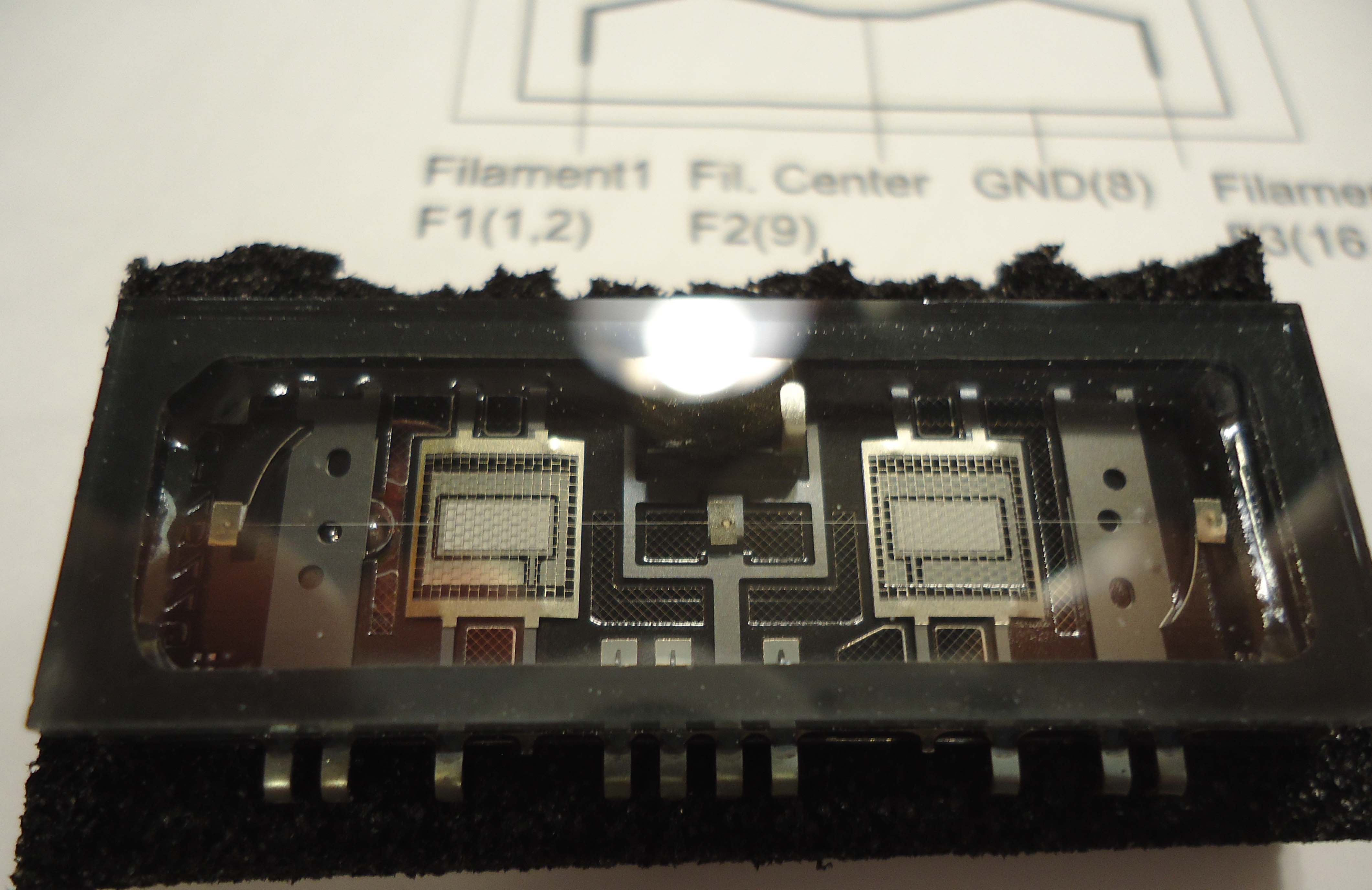

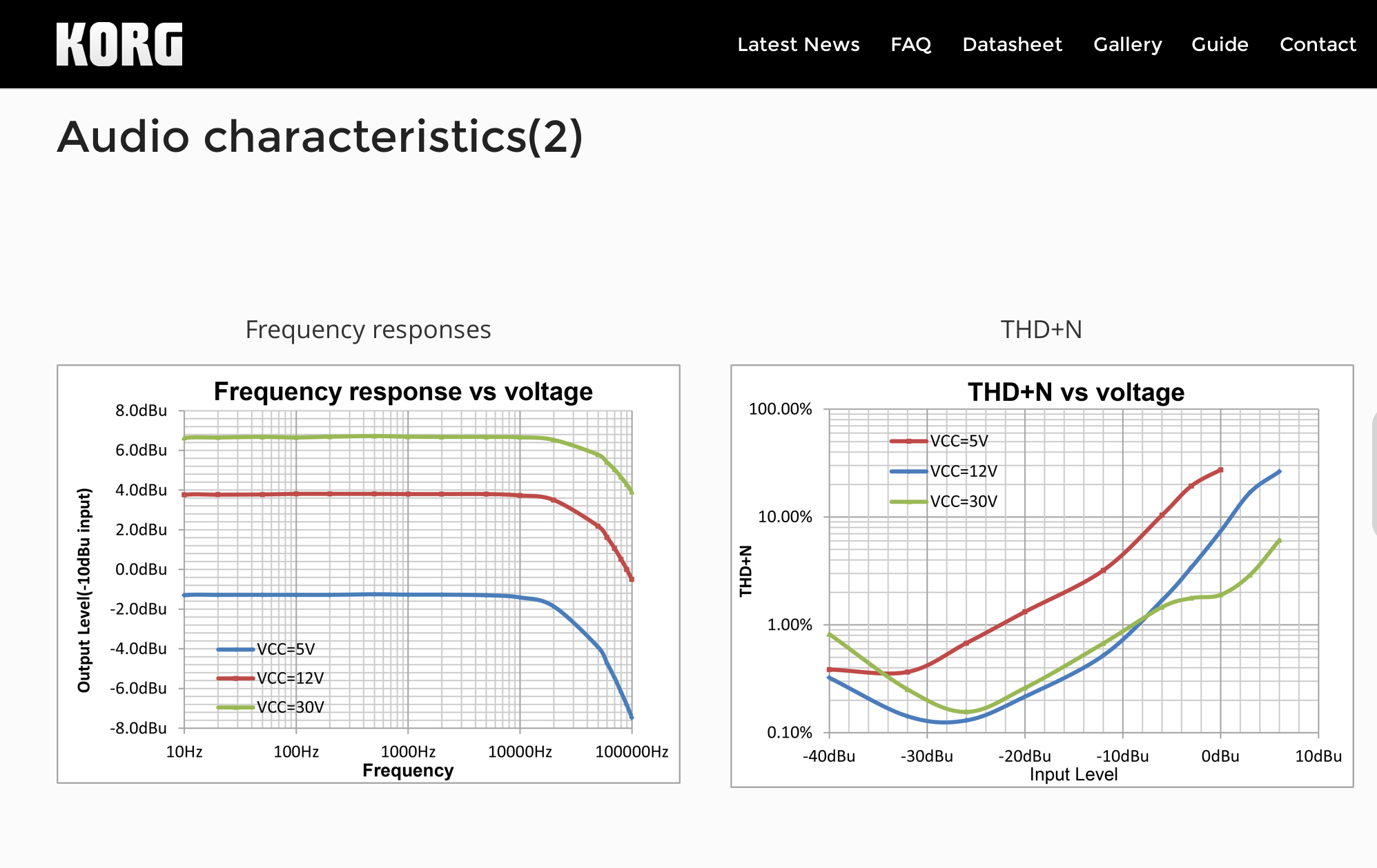

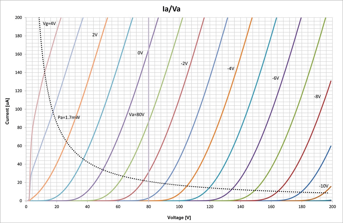

@ Mr Pass and Diyers
2SK180 data sheet say is kind of higher input impedance transistor.
We know Nutube have this usual triode high impedance output.
Could we connect them togeter without buffer for example :
http://www.njr.com/semicon/PDF/MUSES8920_E.pdf
or small iron interstage impedance converter ?
Matched directly heated triodes in small package , linear with lot's of nice characteristic
and life time around 30 000 hrs. Japan high quality component.
What else ? Greetings
