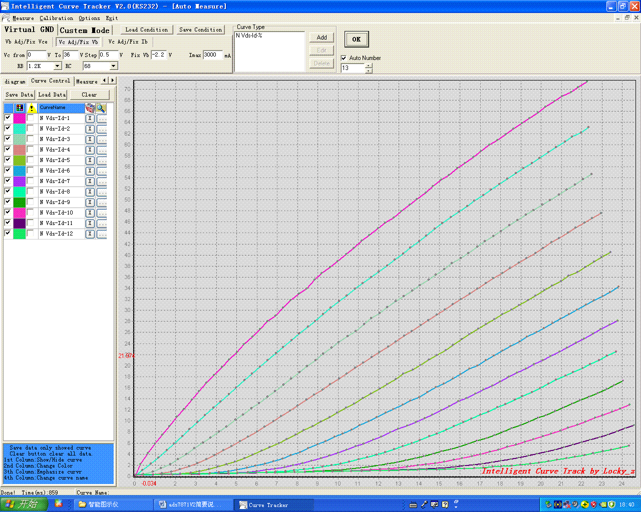

What specifications should I need?Thanks, but for SPICE, you need more than basic specifications.
If you understand what a spice model is, what it looks like and what the abbreviated data is, you wouldn't ask that question. To prepare models, you would need to run accurate tests to determine the parameters such as the one shown by the curve tracer graph, but that is only one. When you a have a full set of parameters, they can be converted to terms that are compatible with spice data files for the software program.
Unfortunately, no datasheet = no model possible.

Ian, even a basic model based on the curves without propper capacitance simulations should be possible. If i recall, someone developed a curve capture program that was originally intended for tubes (triodes). This may be useful. I am not sure but i think it generated a polinome based approximation of triode curves. It will not be accurate down at low voltages and currents but may well be usable enough.
