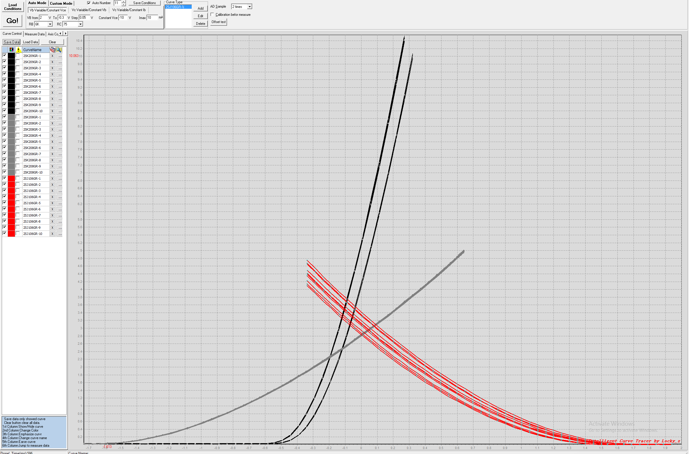

Here's some data that might be useful.
I made a model with the first curve in that data, using the BL model as a base.
.model 2SK209GR NJF ; keantoken 2020
; Data from luvdunhill at DIYAudio.com
; Id is low below <-450mVgs due to model.
+ Beta=21.85m Vto=-0.5359 Rd=12.194
+ Rs=13 Is=2.613f Cgd=14.58p Cgs=14.78p
+ Pb=0.3754 Fc=0.5 N=1 Kf=0.014f
+ Lambda=6.15m Mfg=Toshiba
