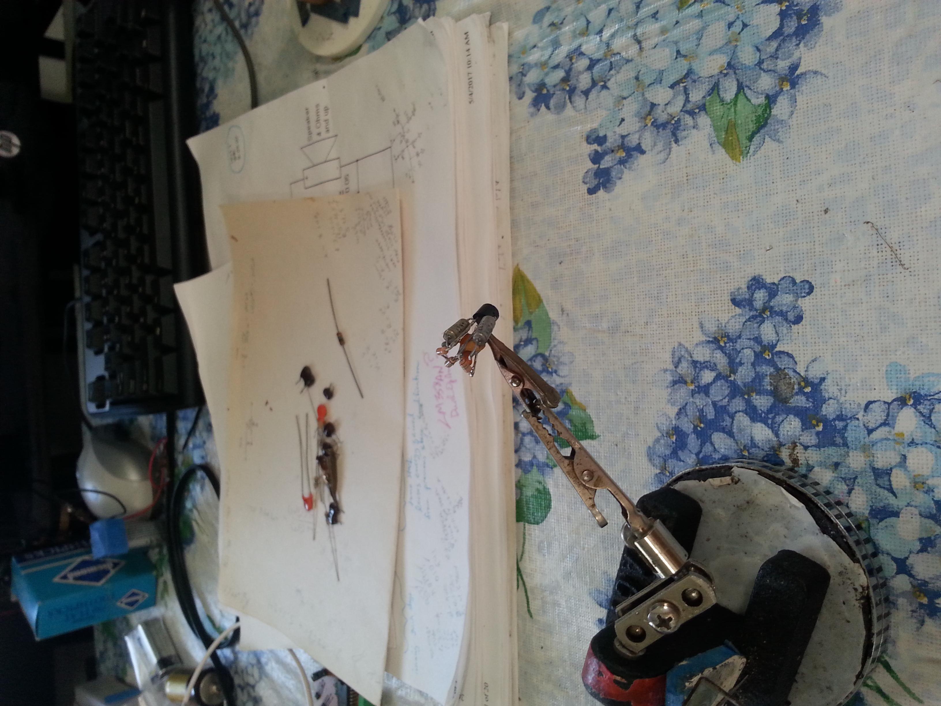

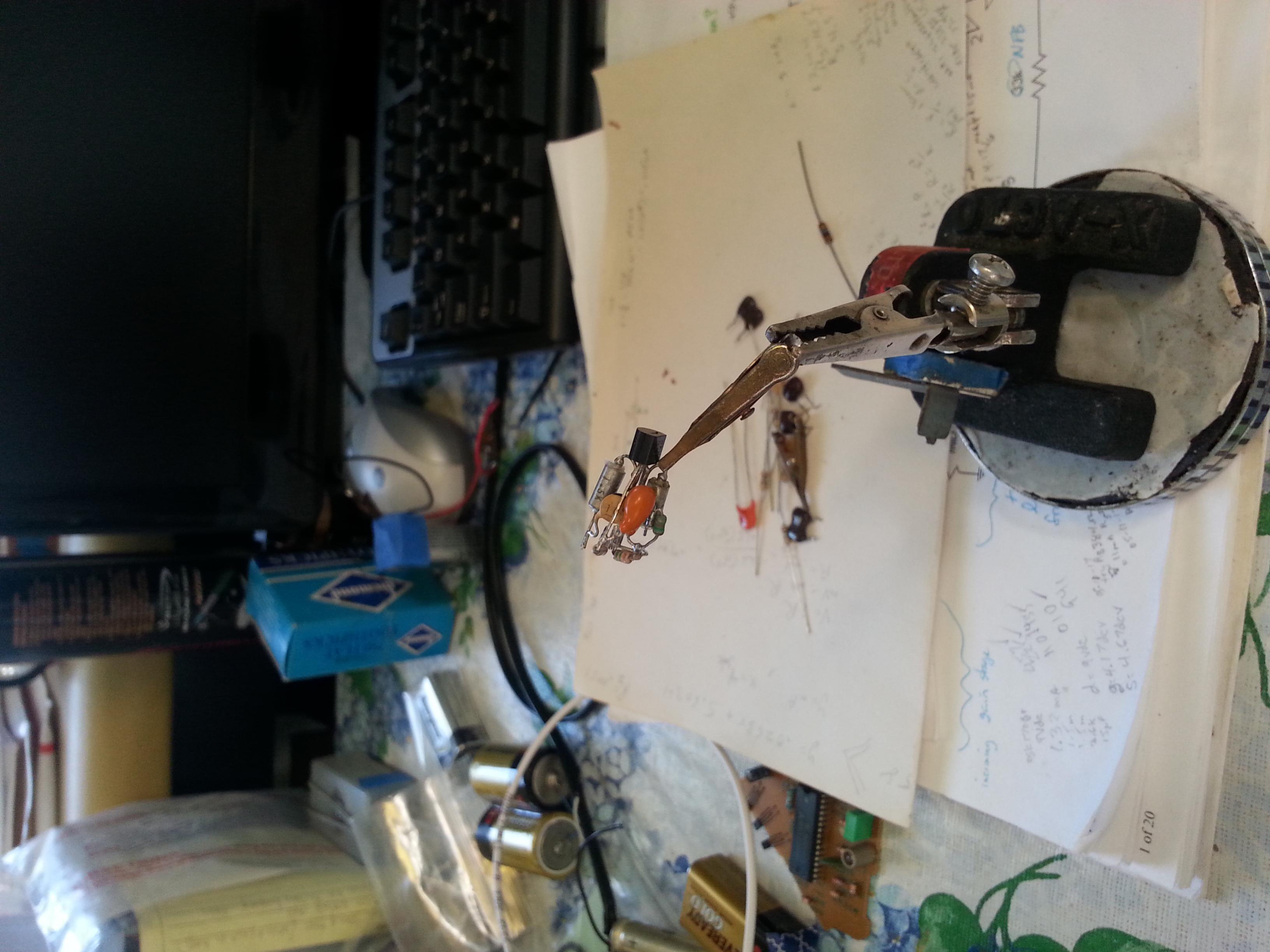

greetings,
1. 2SK170GR from japan Idss 5.63ma with 7809 regulated voltage applied with gate source shorted to earth
2. rigged two C batteries for max -3vdc negative biasing adjustable via 3/4watt 1M Bjorn ten turn trimmer set midway. Bjorn trimmer wiper fed to gate, -3vdc (upsidedown) battery earth connected to source. -3/2vdc negative gate must be applied before applying tension in next step. use dvm to confirm presence negative gate voltage applied
3. 7809 regulated power applied to drain (+) and source (-) with ammeter view active. there is no feed resistor! fluke ammeter directly measures Id
4. Id won't flow yet, excessively negative biased (-1.5vdc) gate wrt source
5. dial Bjorn trimmer to initiate Id flow (threshold) is the pinch characteristic. record negative pinch gate voltage for threshold Id~~zero
6. dial Bjorn trimmer incrementally recording corresponding applied negative gate voltage versus fluke ammeter Id
7. eventually Bjorn trimmer maneuvered into minuscule negative gate voltage causing Id asymptotic approach to Idss
8. attached data record of findings. looks like Rs is calculated by graphing the ordered pairs, trashing the nonlinear portion, least squares line fitting the linear portion. the line slope is the resistor value of Rs with Y-axis as negative gate bias volts and X-axis as Id. But Rs came out 7.9 ohms!
9. please help, something is not correct here, properly biasing the 2SK170GR as a buffer with 7809 power, desired 1M guitar input impedance, desired line level output impedance, desired guitar frequency spectrum

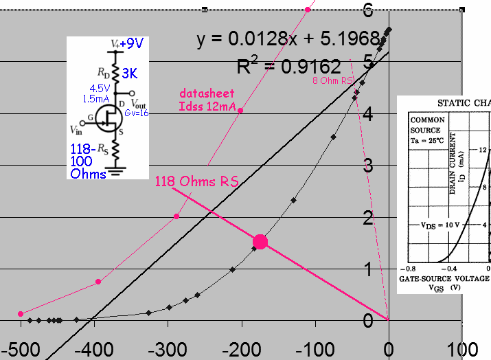

When making test rigs, "always" put some resistance in there, so an accident does not blow-up the device being tested. Reverse (normal) gate resistance is "infinite", so you can use a very large resistor. You want low enough that meter-loading is insignificant (so 100K for a 10Meg meter) and high enough so no handy voltage can exceed the 10mA gate current rating (so 1K). 10K seems fine.
> power applied to drain ... there is no feed resistor!
I would put some resistance in there, to save me from my mistakes. 1K is very safe but will cause big Vds errors at 6mA. Worst-case with resistor and 9V supply is at 4.5V. 0.4W dissipation rating on FET. (4.5^)/0.4 says 51 Ohms is safe, 100 is safer and will still be small error at 6mA.
> threshold Id~~zero
What is "~~zero"? Micro-Amps? Nano-Amps? Femto-Amps? Current can be incredibly small, there is no "zero".
Toshiba takes the reasonable value of 0.1uA as "cutoff" for data purposes, because that is as small as can be measured without specialized equipment.
Your data says 0.1uA is somewhere below -0.5V, which is in-the-middle of the specified 0.2V-1.5V range.
You knew from datasheet you should only need 1.5V to get "off", so starting from 3V makes it trickier. A quick turn would show more like 0.5V, so I would use a 10K pot and 10K or 15K in series to spread-out the desired 0V-0.5V range.
The meaning of "mV/mA" is not clear. It is of course static (not incremental) Gm, but I don't see how that helps initial bias.
And the curve is nonlinear ALL the way.
Not sure what your goal is. To bias one specific 5.6mA FET to "half" of Idss?
You can't do that in production.
We almost never need more than around 1mA in small-signal audio stages.
JFETs can have rising hiss at low current. Some study of good FETs and the thermal hiss of an electric guitar says we may never hear JFET hiss. However the '170's hiss rises below ~~1.5mA, so let us use 1.5mA.
Interpolating your data, for the specific part in your hand, you need -0.177V to be near 1.5mA. 0.177/0.001,5 is 118 Ohms for RS.
To set the Drain near half of 9V, we need 4.5V drop, at 1.5mA, is a 3K Drain resistor.
Input and output bias and coupling should be added.
Is 3K OK? Well, guitar-cord loads tend to be 50K and higher, so 3K is exceptionally low. This is also the output impedance. If 3K is loaded with 3,700pFd (123 feet or 37 meters of typical cable) response will be -3dB at 15KHz, -1dB at 7KHz, which is just good enough for great guitar. If you need longer lines, I suggest a push-pull circuit (so probably a chip).
BUT. What is the gain and the overload? Squinting your numbers, incremental Gm at 1.5mA is about 17mS, or like a 57 Ohm added resistor. So 175 total Ohms in Source. Almost 3K in Drain. Gain is like 16. (You "never" want that much gain between guitar-cord devices.) Maximum output swing is not even 4V peak. Maximum input is less than 0.25V peak (we could have guessed from the 0.5V total swing at Gate). Maximum RMS input is 180mV. This is a medium guitar signal. Many hard strums will exceed this and go "splatt".
You really do not want gain over 3 from guitar to 9V amplifier.
The simple hack is to AC-couple the grid (with a cap), cut-up the 3K and put 1K in Source, 2K in Drain. The 1K goes under the 118-100r bias, the gate resistor returns to this junction. Gain is now 2, mav input near 1V peak. Also the distortion which may have been 5%-10% THD at clipping is now near 1%.
Or put all 3K in Source. Unity gain. While you could keep a 118r bias resistor, it is really simpler and much more device-tolerant to use a bias-splitter to set the Gate near 4.5V. Then "any" device with Idss>3mA and Vto<1V will drop-in and work good.

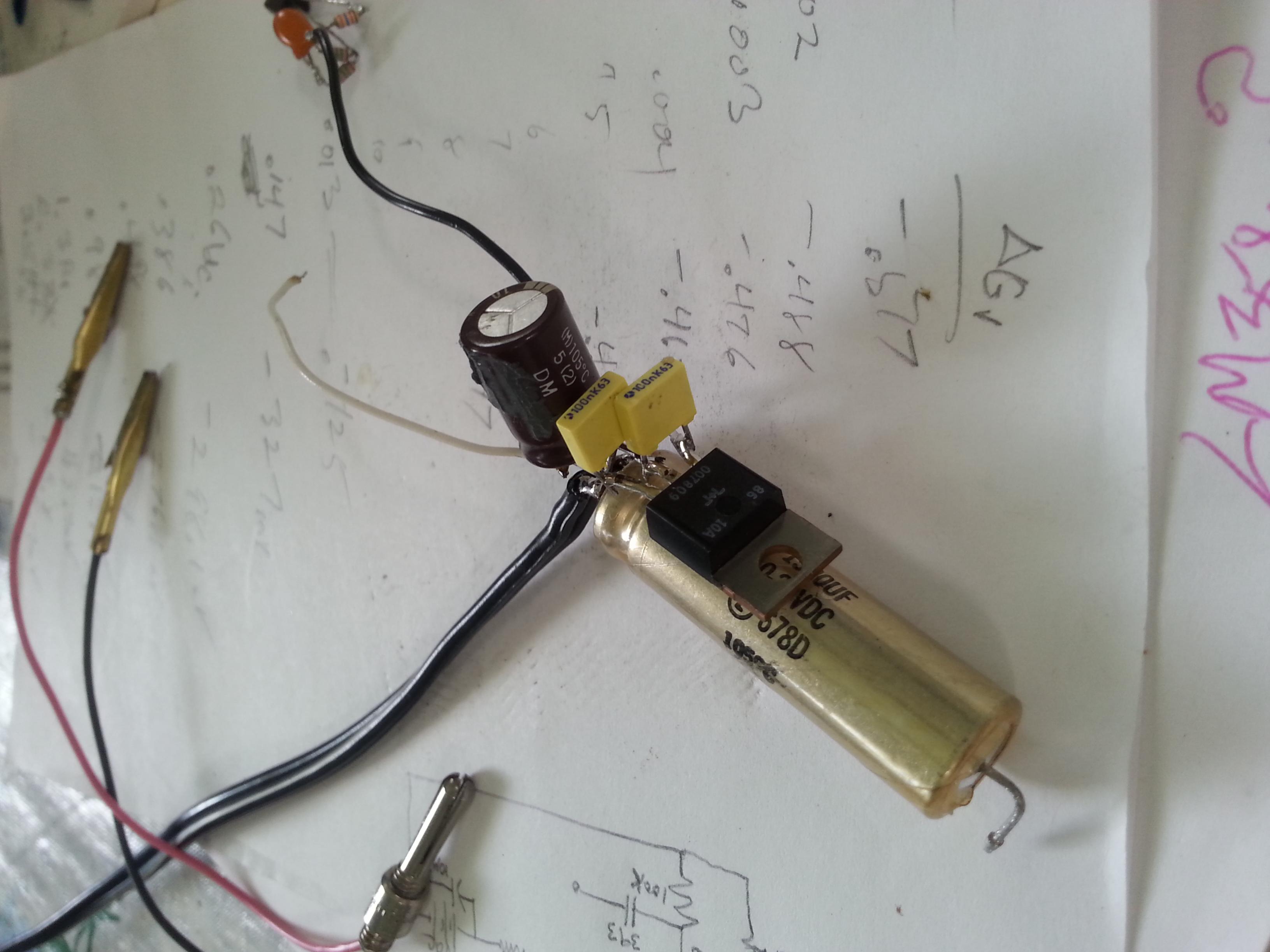

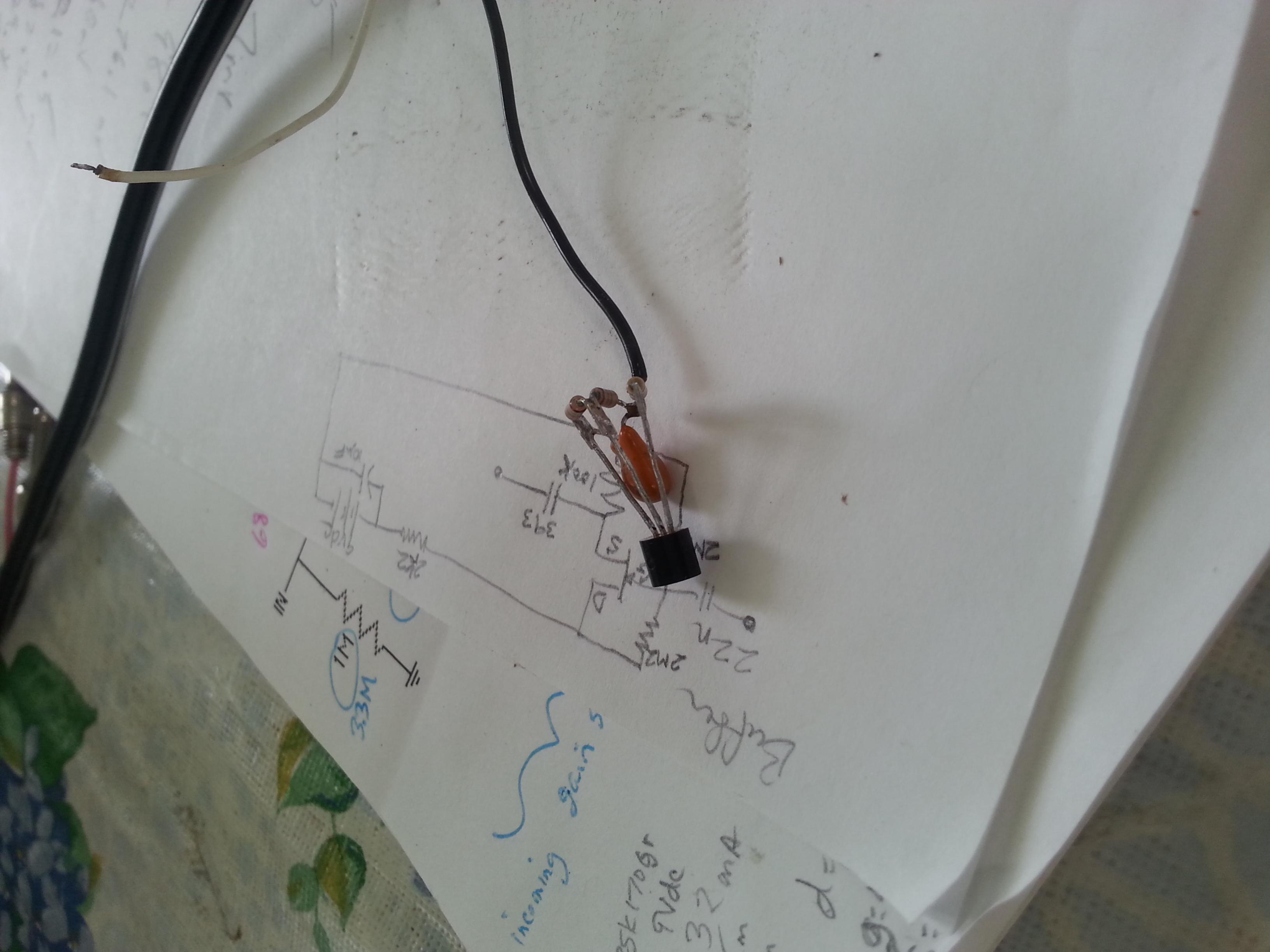

2sk170gr intended for moving cartridge phonograph transducer 1st stage or initial stage eq so it is for signals significantly tinier than telecaster stock pickups?

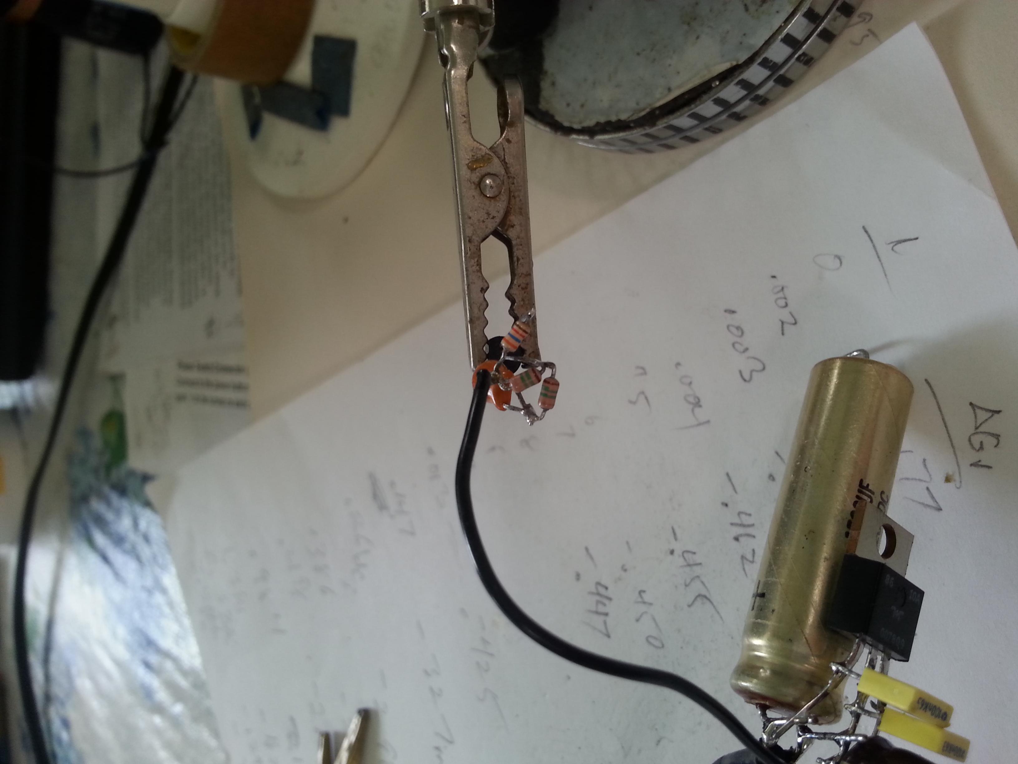

resistor source at 3.6k at source voltage 4.67 of gate 4.17 of drain voltage 9
1.5m drain resistor, 1.5m gate tie down resistor, unchosen signal input cap (none, danger), picture prehistoric american tantalum really good there 15uf20v.
supply 9.00, lucky regulator i suppose,
but alas, current is idling 1.32ma
so fuel flow ! shrink resistor source substantially to power orders threefold? that's kilo shrunk to hundred shrunk to ten !
and why three orders of power? why? try source resistor 360 then 36 then 3.6 !
source current raise to 3ma from 1.3ma
okay, got it at half powering voltage on that source resistor, 4.57 volts above earth. Gate voltage remains same as before 4.16 volts above earth since both drain resistor and gate tie-down resistor are identically 1M5. i don't know why gate voltage above earth is not half powering voltage from the 7809. the craftsman pocket multimeter 82351 does not have meter connection receptacles for test leads so lead lengths are antennae long 18" each. the fluke 76 multimeter has 6" leads and measures milliampere thruput 2sk170gr. the 7809 powering voltage sags when measuring gate voltage above earth, why, because of craftsman aerial antennae leads, gotta scope the jfet's output ac signal waveform W/OUT_ANY ac 1khz nominal 5mv rms signal injected. this should reveal test leads infiltration noise extraneous? quiescent milliampere is now 3.146 as long as gate is not craftsman probed by test lead to measure gate voltage above earth. whenever gate voltage above earth is measured, milliamperes fall somewhat to steady
2.931. so obviously the 7809 power supply is being fingered for more current and it's powering voltage does sag downwards to 8.97 which is trivial but why should current fall 3.146-2.931=0.2ma? shouldn't it go the other way, upwards instead, since we're demanding noise signal injection buffering in lieu of no injected noise from craftsman test leads noise intrude? since i'm on the desk workbench open to world noise, should i coax the 7809 powering umbilical into the 2sk170gr substrate?the other bothering question is whether gate voltage is good enough at 4.16 since web literature request centering gate voltage to half of that of powering voltage, 4.5, meaning precise 1M5 resistors must be employed to achieve 4.5 gate voltage? additionally, you don't know whether the gate voltage measurement is actually erroneous owing to test lead probe intrusion into gate which has extreme sensitivity (huge antennae? 18" unshielded red test lead of pocket craftsman multimeter). must visual wave form on scope of 2sk170gr output w/ and w/o signal inject for unwanted noise infiltration. trouble is test leads noise introduction might be counterproductive by introducing test leads noise which 2sk170gr buffers.
one last report, tried source resistor 385 ohms and milliamperes soared to 11ma! immediately disengage 7809 powering. Idss (gr version) says max 6ma. so, is it ok to exceed this as in 11ma? did jfet get wounded from thruput 11ma split sec?
jfet rated at .4watts, so (i^2)*Rs=watts= .0465 watts

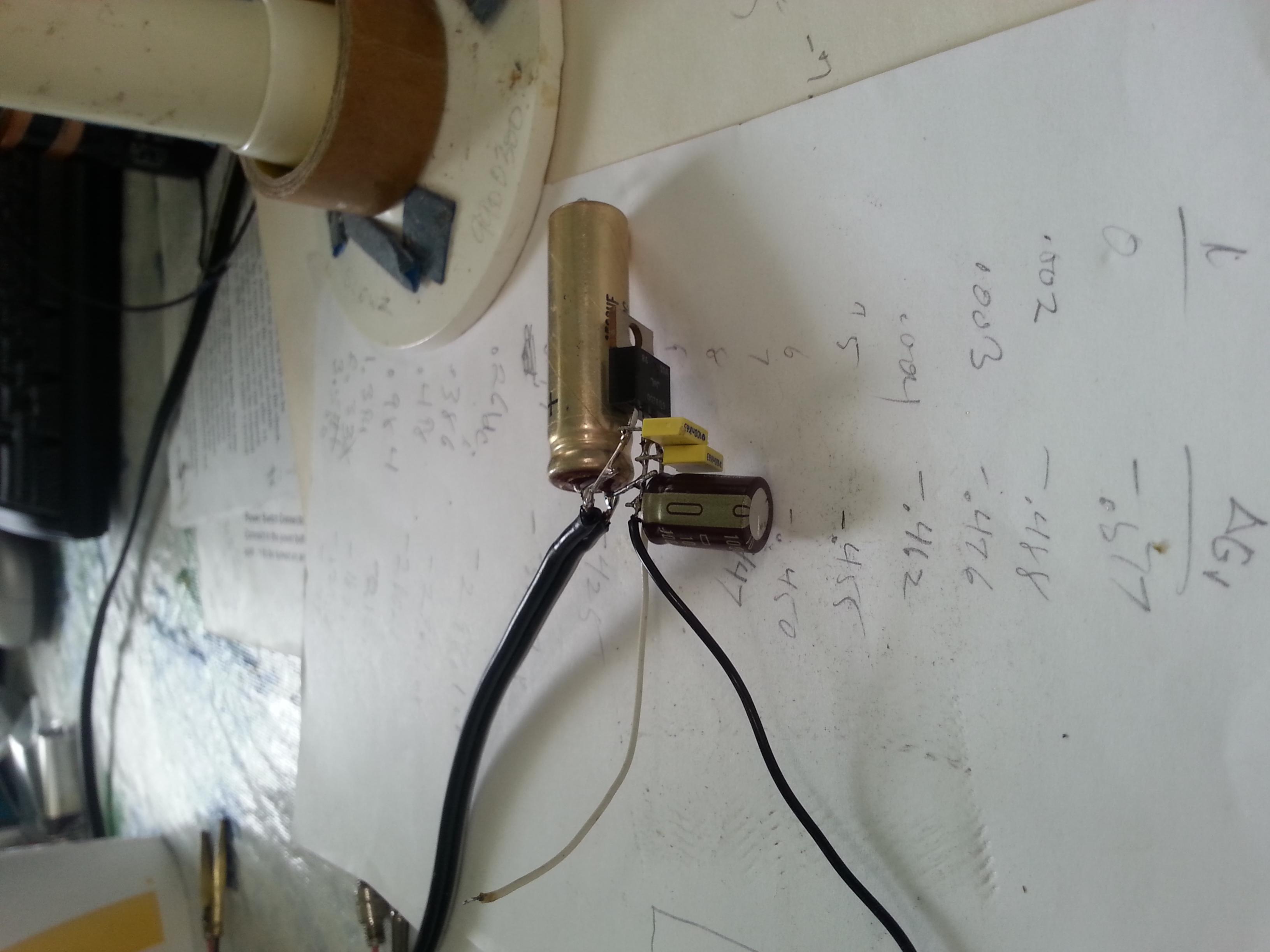

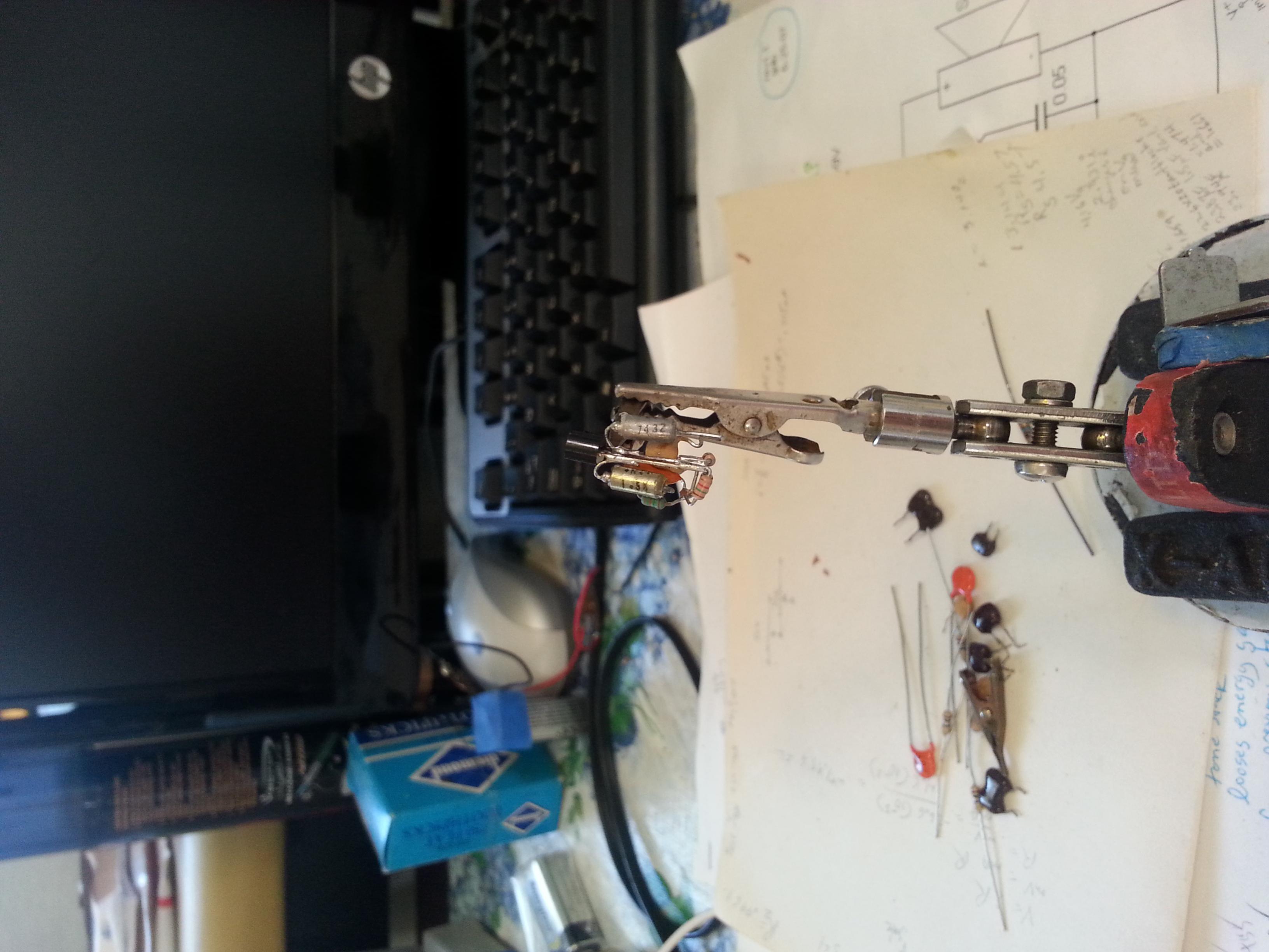

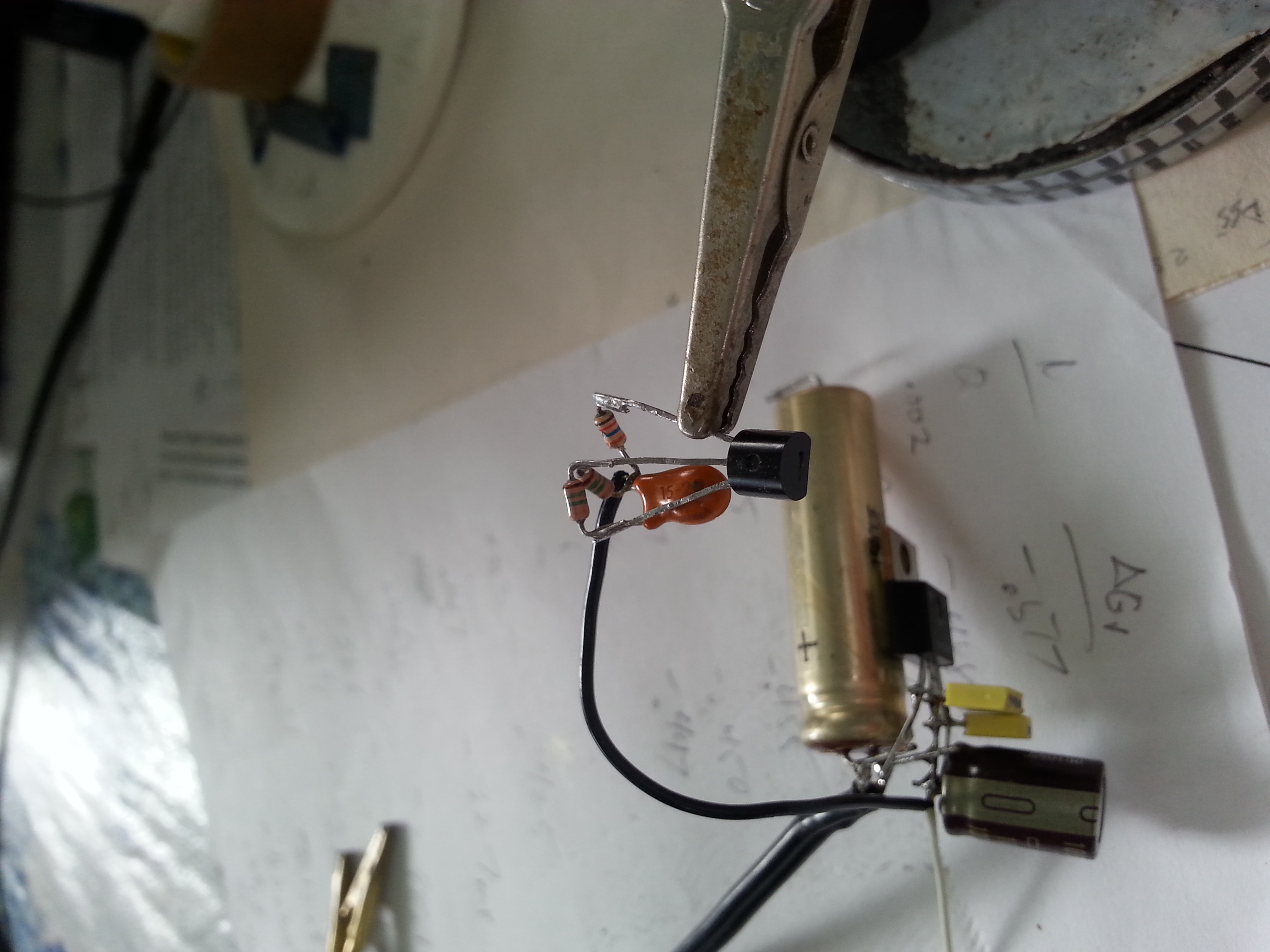

Trial run
I can not center gate voltage to half powering voltage. It stays at 4.16 and appears to be dropping insignificantly as Rs is decreased to increase quiescent current toward the high end.
I don't know if the disparity is acceptable, until scoping output waveform and listening too.

Pics
Here's the finale, still unenergized because dunno which way to orient polarized wet tantalum input dc blocking cap
> Gate quiescent voltage was erroneously measured 4.16vdc. But what's the comparative magnitude voltage on the upstrm side node that is telecaster?
Zero.
You figured the right answer. I do not know why you think it is non-intuitive.
It REALLY would make sense to breadboard or hay-wire it with low-cost parts, first, before you do your Final Build.
