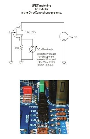

You can find the schematic here: http://user.faktiskt.se/RogerGustavsson/telinga.pdf
It is not tested. A friend is trying to analize the circuit. Input is about 8 mV at maximum. Maybe the gain is to high. A total gain of 50-100 with the SSM2142 (which has a gain of 2), would suit fine.

Excuse me for delay but the time is always few. I open the MC pre telinga and by examine it is :
From left to right, only the first jfet amplifier, the up id load active ( current generator ), the third is a buffer and adapter the load but no amplifier ( is gain is 1).
Now all is only two stage active in cascade, I think ( if SSM2142 gain 2) all gain 20/30 , if necessity of more gain is necessary change circuit o plus one stage active.
The type of 2SK170 correct is GR small current of Idss.

That micamp has come a bit further: http://www.ruschkowski.se/tmp/Audio/MicAmp/3/Sigge - Schematics REV A.jpg
Simulated gain is 28 dB and the distorsion is also on the low side.
The circuit will need some matched 2SK170. Borbely Audio is a good source.

Have come to this solution.
http://user.faktiskt.se/RogerGustavsson/Sigurd_Roger.pdf
Any comments?

A simulation by a friend, gave a gain of 25. That is with an Idss of 10 mA. How much difference would an Idss of 15 or 20 mA give?

GIPIONE said:The schema is o.k and don’t have problem, but the total gain isn’t 80/100 about is 20/30.

I think that the simulation is correct, I say that the total gain , is only two stage, is 10/15
The first is a common source and usually gain 10/15, the second is e operational amplifier and, I don’t know the connection, you say that gain 2 ; the total is the product.
