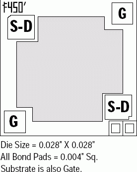

May be a little off topic, but I would like to point out that the drain and source of some of the Japanese-made general-purpose N-channel JFETs can be interchanged in a circuit without ill effect, or for that matter, much difference in measured performance or sound quality. I am currently holding a Toshiba 2SK30 in my hand, and the interchangeability of the source and drain pins is definitely true for this critter.
The reason is that for low-frequency general-purpose N-JFETs, the Japanese manufacturer often built the semiconductor die symmetrically relative to the gate.
This observation does not apply for high-frequency N-JFETs, very high Gm N-JFETs, and P-JFETs. In these latter cases, a symmetrical die construction is seldom used, due to the need to optimize the performance of the FET for its more specialized purposes.
Knowing this trick can make your life easier when you are designing a pcb layout. But do test this out on a breadboard prior to finalising the layout. No sense in taking unnecessary risks!

This is very interesting and I wasn't aware of it. It is interesting that a certain schematic of a certain very low noise phono preamp (anyone who has seen it will know which and don't ask. don't tell to avoid really annoying a very respected member of the forum) using the K147 and J72 shows the drain and source swapped.
In this reverse engineered schematic, the drain and source for two paralleled K147s are show as connected, that is, the drain and source have been swapped for one of the pair. The same is done for the pair of J72s. I assume this would be undesirable to connect asymmetrical die jfets in the manner.
Not having seen the PCB I can only assume this connection might been made to ease PCB layout or to couple the jfets together along the flat face surfaces for thermal coupling.
Are the J72 and K147 not asymmetrical? Which high transcondutance Japanese jfets are? I also notice the die for the second source version of the K147 appears to be symmetrical. I have also
been told by another usually reliable source that the drain and source can be swapped for the K170.

I do not know if it always works, but I used some 2sk170 (pair) to bias the opamp in a disc player once. I got mixed up and hooked them up reversed. Latter I noticed my error, but found the circuit still drew the desired 2 ma. I thought it was a fluke.
BTW, I use a cheap DVM to match the fets. It uses a 9 volt battery and on the 200 ohm scale it will measure the dc resistance across the source to drain. This is a cheap and easy IDSS match, but is not super accurate. If burn it, the fet resistance measurement is stable and seems to follow current draw in a circuit.
But the resistance measures the same from source to drain and from drain to source. This was not expected.
George

Before some ask.......
I am of aware of asymmetrical jfet design
but was only curious if the particular devices I mentioned were designed in this way. I wonder if I should cut one open to look at it? If understand the referemce below, DS reversal will work for some asymmetric jfet designs but not as well as in the prefered direction.
