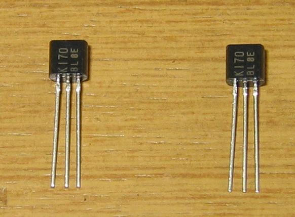

I just measured my quadruples of SK170 and SJ74 I got from Spencer
http://www.diyaudio.com/forums/swap-meet/131284-toshiba-2sk170bl-sales-56.html
Exactly 10,2 mA for all! Good work, Spencer! Keep on selling the real stuff!🙂
I also have quadruples from Spencer...genuine stuff, all measure as you say.
The 2SK170BL are not a problem it seems, i have plenty, all tested and matched.
It's the 2SJ74BL that are much more scarce that are the problem.
He delivers J74 too....🙂
When I meant quadruples I meant two SK and two SJ, ideal for UGS!

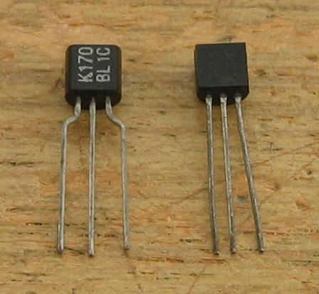

I've bought mine from a Chinese supplier at DH Gate webside.
Range is from 3mA to 22mA.
Thanks for your image, masag1. The 2SJ74BLs bearing the code "7C" have already been described as fakes by @h_a here:
http://www.diyaudio.com/forums/pass-labs/121228-f5-power-amplifier-1033.html#post2476459
Now you can guess that these "High Idss 2SJ74BL" offered here
20 X 2SJ74BL (10 Matched pairs) - HIGH IDSS | eBay
are also fakes (Seller says: They were manufactured in Malaysia)
Yes Nelson there must be somewhere genuine parts but in past weeks i bought 2sj74BL from schuro, utsource and NIKKO and they all measure between 17ma and 20ma Idss......
They would be most certainly fakes, I am afraid. I bought parts labeled as '2SJ74' from one HK supplier, as a trial. They also measured some 17 - 20 mA Idss. But have low transconductance AND noise higher about 20 - 30dB at low frequencies. I test the parts in my discrete preamps and noise spectrum + FFT distortion measurement are the best answer if the part is fake or not.
@CeeVee and PMA:
What's the batch code of your fake 2SJ74s?
Thanks for the information!
Mine was 'BL'. Obviously 20mA is a nonsense then.
The package marking seems to be overwritten. Those guys just took some P-JFETs and wrote '2SJ74BL' on them.
