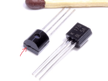

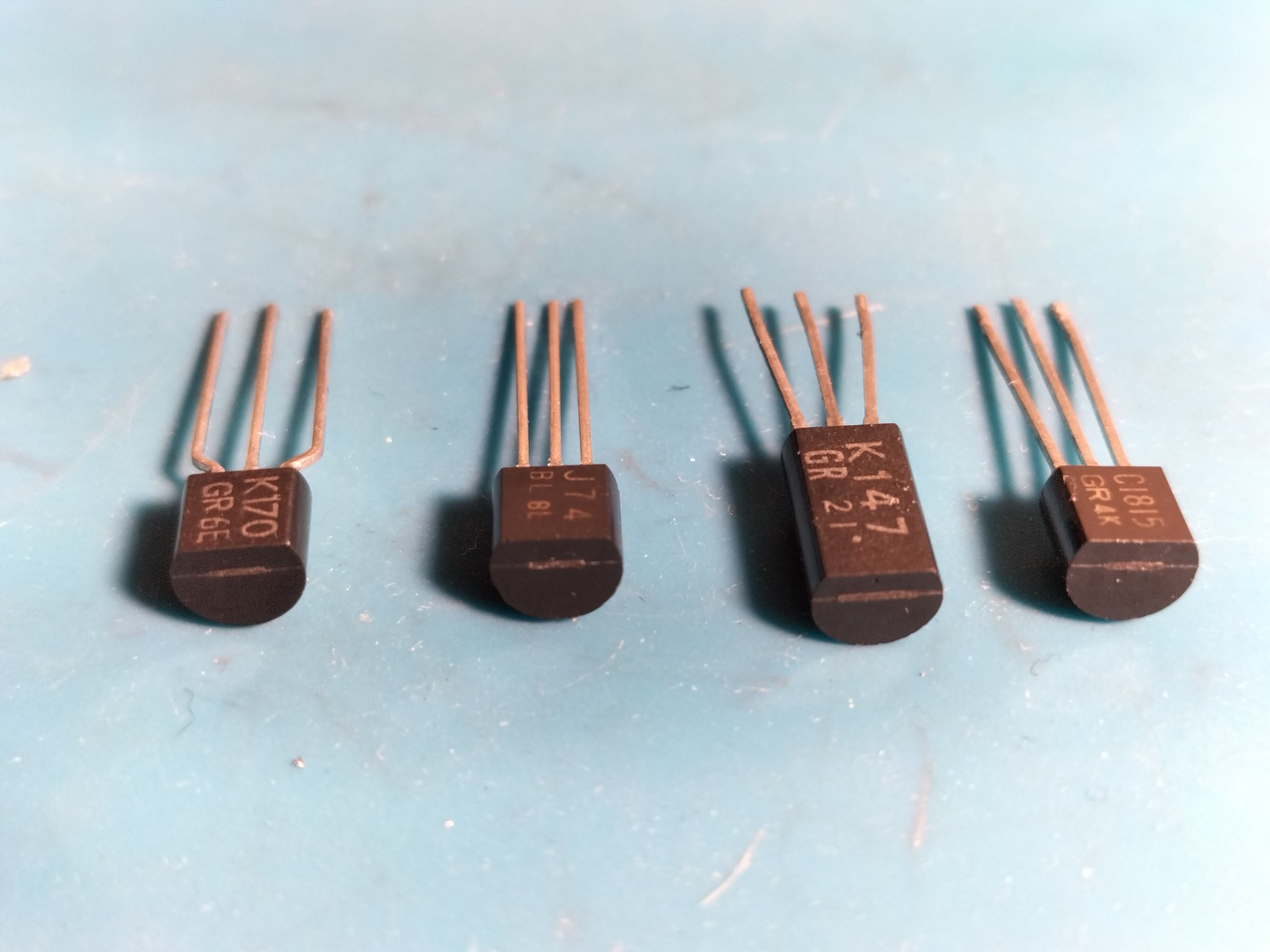

Wait a minute! Perhaps we should be a little more careful.
As far as I know, the mold gate marks on Toshiba's TO92 package are centered and the burrs have been scraped off nicely.
Segor's photo seems more likely that the one in the picture is a fake.
Even if the Segor is conscientious, their suppliers may be suspect.
I would ask the OP what the actual item received was like.
