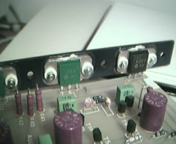

2sk227 2sj83
Does anyone know anything more about these transistors? They seem to be similar to 2SK135/2SJ50. I can't find any datasheets.
2SK227: 160V, 7A, 100W
2SJ83: 160V, 7A, 100W

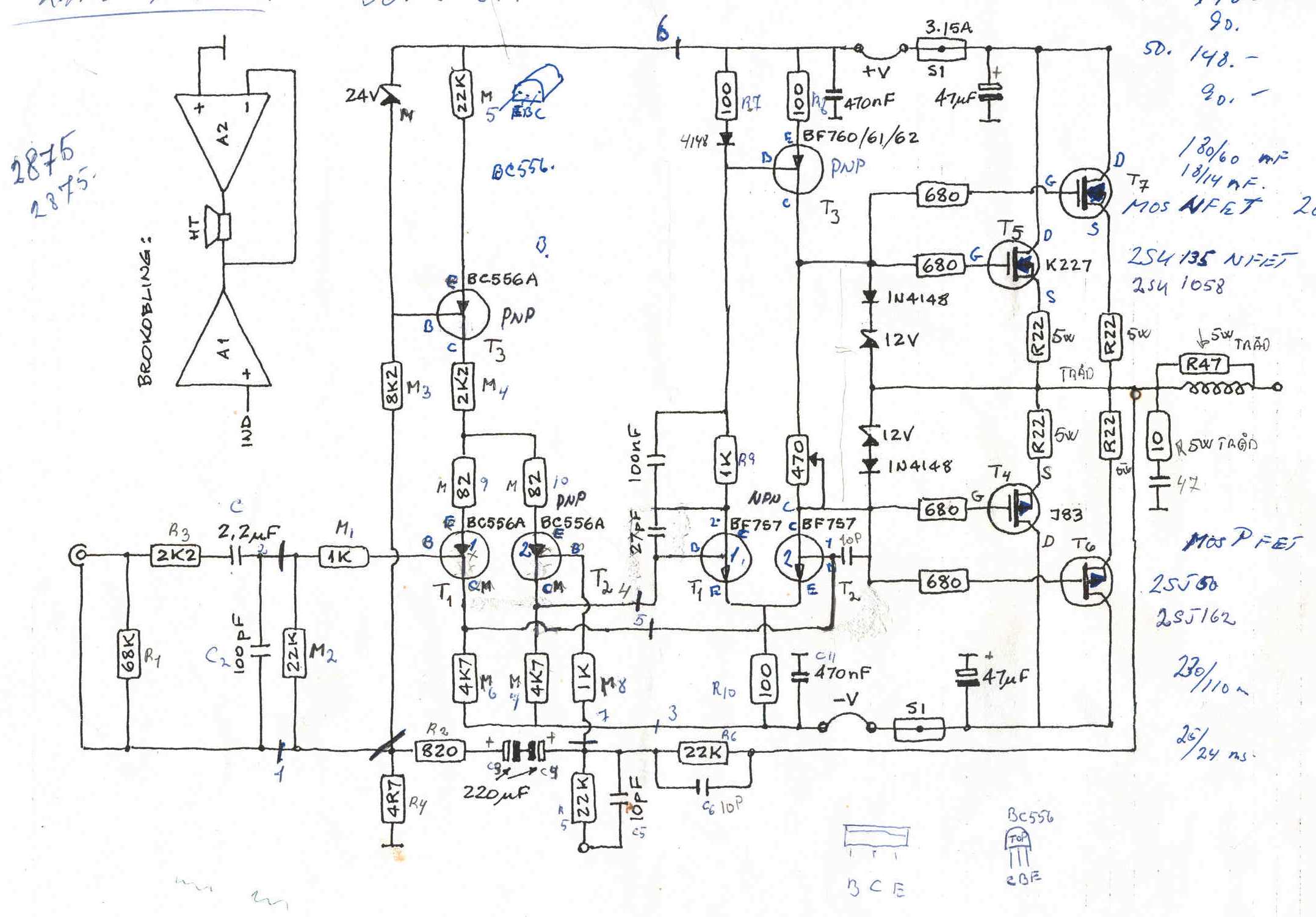

Working with valves one old amplifier with SJ50/SK135 turns up in the memory all the time. I have bought 8 pairs of mentioned Hitachi's mosfets. I attach a copy of the old circuit - it sounds very good and I just want to hear your opinion of the schematic.
Kim, Denmark

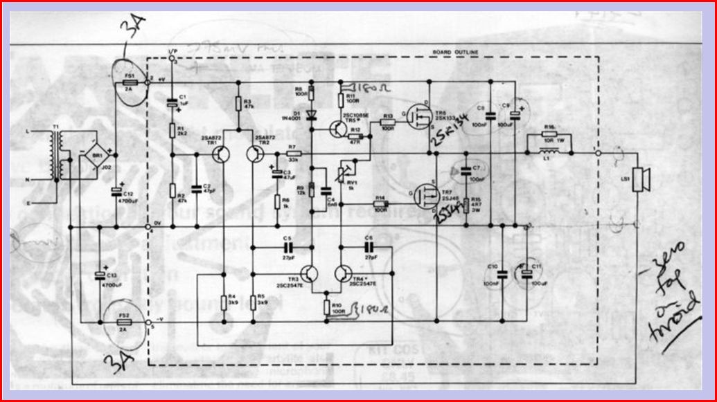

It looks to be a variation of the old Hitachi application notes... there were many offerings at the time and kits too.

Here's the Hitachi variation as an old Maplin kit... this had a real following at the time.
I have looked at the schematic of your mosfet amp. Looks good and symmetrical to me - with rails of +-45Vdc and servo feedback - I am not audio engineer.
My friend is and he claims that: 1. power fets should be driven with stronger drivers than expected. 2 He do not like power fets because of the different act of N and P fets.
I say : I like like the mid-and highrange sound better from mosfets than bipolar, but would like to have a little better attack in the low frequence area.
I have tried with +-45Vdc on the attached schematic of mine but I reached better control of the 12" woofer with +-70Vdc on the double pair Hitachi 2SJ50/2SK135.
I have found ( for me) the best sound in midrange and highrange in L58A with the sj44/sk163 but lack of control because of only one pair 34/149 powerfets.
The intention is to make the Luxman drivercurcuit with a doublepair powerfets. It is hard to find the sj44/sk163 today.
I think that the BF760/BF757 in my circuit drives the powerfets very good - one might find better drivers today than the old Motorola types.
rgds.
