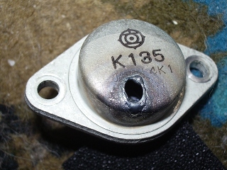

I wonder how many of them ended up like this one from a Perreaux 3150.

WOW!
was that a real 2SK135?
i was using those for years since 1981 and abused them in all kinds of ways as i was learning about them. i only destroyed 4 by accidentally applying 65V gate to source voltage. 😱 😱 :dead:
none of mine ever opened up like that!
Yes. When I measured them unpowered in situ, it was shorting gate to source and pulling down the other 5 gates.
But still playing OK for a couple of weeks. The owner hadn't noticed anything was wrong.
Until he noticed one cold heat sink which gave him the clue that something was not as it should be.
