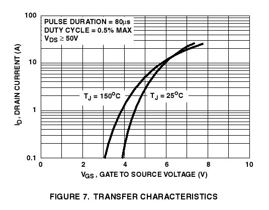

WHY everybody claim that VMOS: vertical mosfet has TERMAL RUNAWAY problems :
VMOS has NEGATIVE temperature characteristic more heat less current !!!
This graph (taken from IRFP240 datasheet) seems to show the behaviour you describe only at very high currents.
In a real application you aren't going to use 10A bias per fet...thus the tempco is positive for the operating conditions and it turns negative once your fet is already cooked.
Cheers
Andrea
medogrizli said:WHY everybody claim that VMOS: vertical mosfet has TERMAL RUNAWAY problems :
Everyone claims it becaue for the range of currents in question it's true. You need to work on understanding datasheets.
Thats from Biljanovic book 😀
ok you are right I have to check the datasheets thoroughly😀
But if the current exceeds 10A the current will stop inceasing : shall the mosfets burn?
10A*70V 700W / 4 mosfets = 175 W maximum per mosfet : if the fuse is 5-6A fuse will burn first before mosfets heat up

Er no, 10A per MOSFET so that's 700W it tries to pass before the inbuilt burn resistance works...
richie00boy said:Er no, 10A per MOSFET so that's 700W it tries to pass before the inbuilt burn resistance works...
no 10A per ALL mosfets
