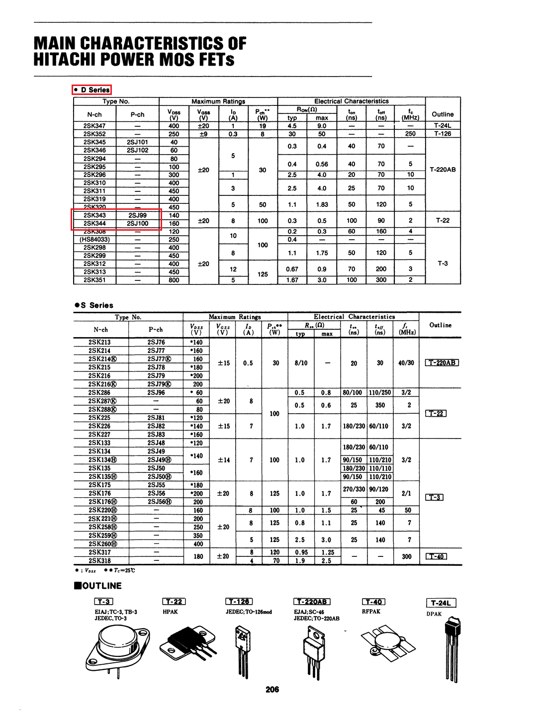

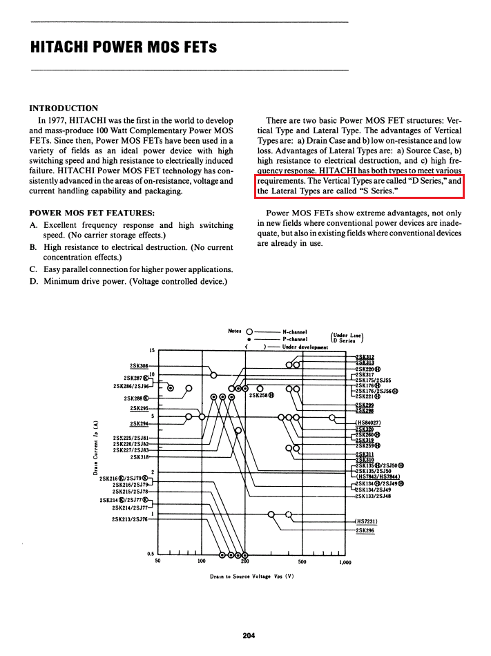

Hi, I am looking for replacements for 2SJ99/100-2SK343/344 Transistors
I've been searching for info on the internet but finding conflicting information.
I found someone recommending 2SK1058/J62s would be electrical equivalents, although the mounting would have to be modified, but elsewhere seen them listed as being Vertical Fets, so the 58/62s would not be suitable.
Checking the reprints of Hitachi datasheets, they don't appear to mention what type of fets they are.
Can anyone please help me out?
2SJ99/100-2SK343/344 are verticals - see attached. Can't really suggest any replacements though...

Hi thanks for your reply.
Question answered.
Not the outcome I was hoping for.
I've got several Hitachi and Exicon Enhancement Fets.
I'll have to dig around and see if I can find any of the early Hitachi Vertical MOSFETs.
For what it's worth, a reference on The Datasheet Archive suggests the following substitutes:
2SJ99/100 ==> IRF9241, RFM10P15
2SK343/344 ==> IRF231, BUZ35, BUZ35A, MTM8N15, MTM10N15, PM1506M, SDT32, SFN231, UFN231
Not sure if any of those would fit electrically or even physically (TO-3), but you could try resolving the latter by switching to a different type of package (IRF ==> IRFP, MTM ==> MTH, RFM ==> RFG/H, ...).
Hi Petoluk, thanks for the info. Checking availability and compatibility now.
It appears that the RFM10P15 would not be suitable, as it's an Enhancement fet.
I came across a currently available pairing, IRF240-IRF9240, I'm wondering whether they'd be suitable replacements IRF240-IRF9240?
Maybe someone can advise?
