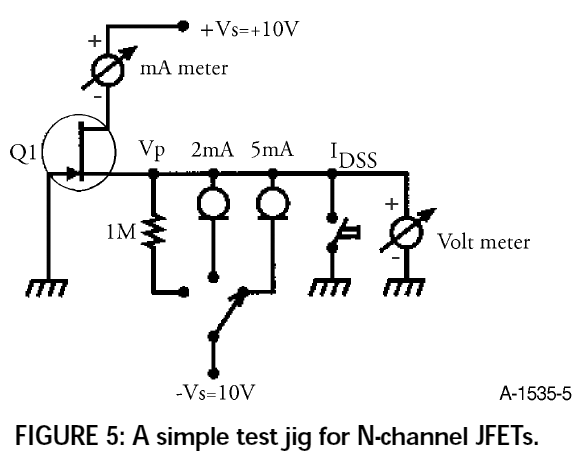

Measure the Idss and the Vpinchoff.What’s an easy and sure way to verify the part is behaving like a genuine?
Then use the calculation given by Borbely to find the gm.
Those three bits of data can be compared to the j74 gr datasheet.

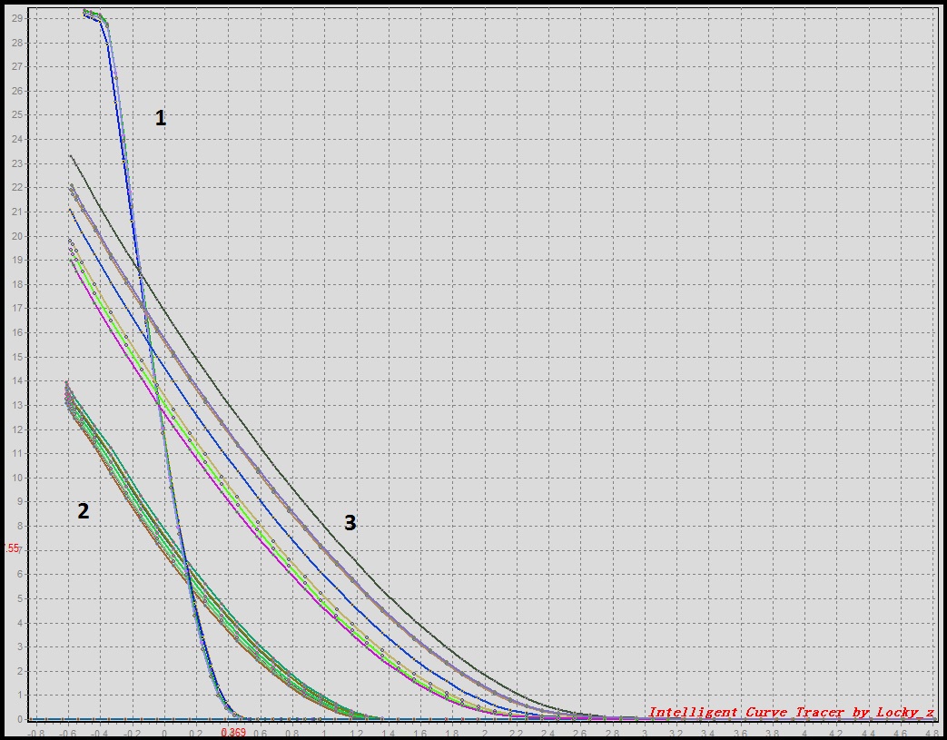

I just ran test and got this:
http://www.diyaudio.com/forums/pass-labs/241729-aleph-illustrated-build-guide-236.html#post5288623
Idss = -10mA At -10V
Vp = -2.131V
Yfs = -2 Idss/Vp = 9.4mSiemens

Vp = -2.131V is very high.I just ran test and got this:

That is what is giving the low gm calculation.
I would expect 0.7V to 1V for a 10mA jFET that claims to be high gm (similar to an sk170).

Idss = 10mA is not GR.Even if they are genuine, they have GR rating. :-(
