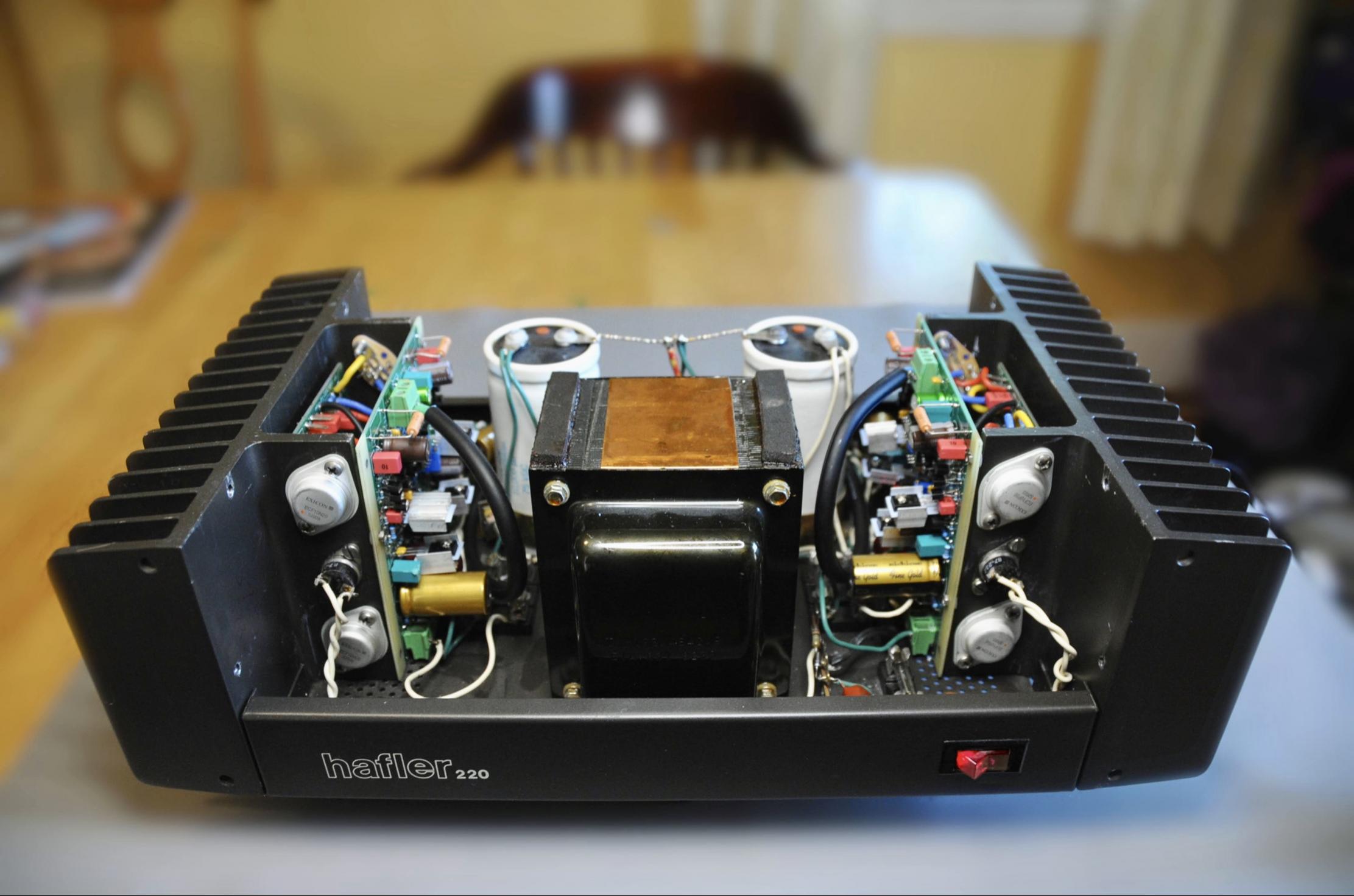

I did that very thing with replacing Hitachi original TO3s with Excicons. It worked wonderfully. I don’t have a scope or technical measurement equipment, but I’ve been very very pleased with the outcome.
