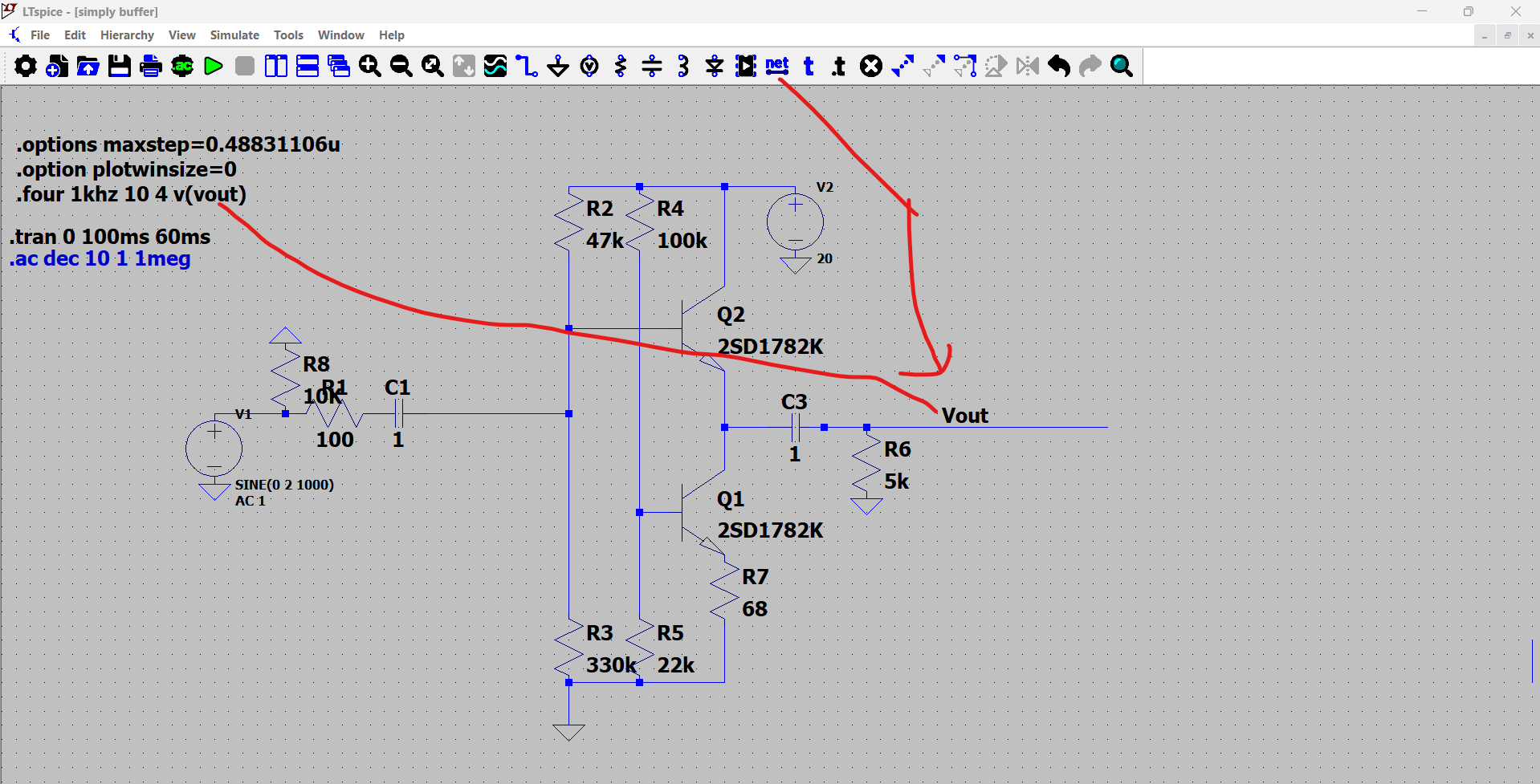

If you just want to simulate the circuit use the default 2N5550 (NPN) and 2N5401 (PNP) in LTspice. If you want to build the circuit for real then look at the total supply voltage (for a split supply add both together) and pick a real transistor with at least voltage plus 20% more to use. The common BC series are good and would cover most small circuits.
If you post the circuit we can tell you suitable transistors.

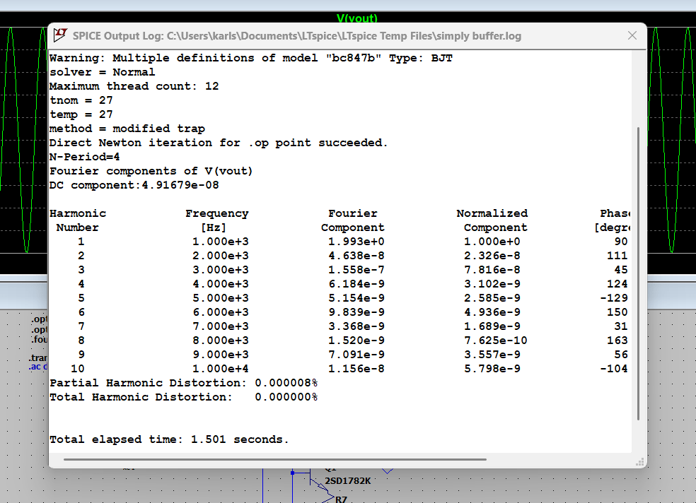

That looks pretty good. Almost zero distortion.
If you delete your 'OUT' on the sim and add a new 'vout' using the NET option (to label that trace or net) and if you run the sim but this time right click the circuit area workspace and select 'View Spice Output Log' you can read off the distortion. Whatever you label the net as must match the vout in that .four command although it is not case sensitive. Vout or vout is fine.

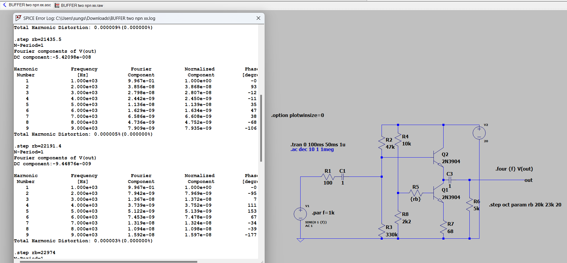

This circuit is interesting. So far, I have found that the unexpected low THD relies on a balance between the relationship between the load and the EF transistor, and between the CCS transistor collector impedance and the CCS bias impedance. The follower has a log component that is ~cancelled by an exponential component of the CCS. This means that the THD will not happen if the total load is not exactly 5K and is highly dependent on transistor behavior. More work is indicated to refine the implications.

It's not unusual for a specific combination of component values to give a spectacular result in LTSpice, but things become "normal" as soon as you touch even slightly one of the "dials" of your simulation. You've just come upon a combination where, in simulation, some non-linearity is cancelled exactly by some other non-linearity, but this is a simulation artifact and very unlikely to reflect in the real circuit.
For example, if you increase the load resistor to 20k (this will always decrease distortion in a real circuit), THD jumps from 0.000008% to 0.000124%, more than an order of magnitude worse. Or replace the transistor with pretty much any equivalent model (there's nothing "special" about the 2SD1782K) and things start to look much more realistic.
