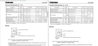

I am bringing this back, but....According to the seller only tray pack has 'Japan' marking on 2sc5200/1943 transistors & there is no mention of 'Japan' in the strip pack(see attachment). I believe these are 100% authentic, what do you think? 🙂
Best Regards!
Datasheet says that the transistors will have Japan on them if they were made in Japan, d’oh! the boxes show Japan on them , but your transistors DON'T!
Hi, yes later i convinced that those are not original but good quality chinese copies. I have genuine 5200 with JAPAN marking on them.
