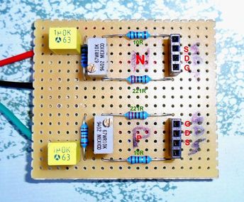

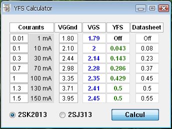

To check 2SK2013 & 2SJ313 I use this little montage (Fab Schematic) with a small program that I developed.Do you have links on how to build a test rig to measure these things? Looks complicated.
The schematic must be requested at Fab, it is part of the USSA-5 manual.Do you have a link to schematic? Looks like for FETs. Is this also applicable to BJTs?
Yes this little assembly is specific to these two references mosfet I think but should certainly be extended to other references.
If Fab does not go through here, I will contact him to ask.
