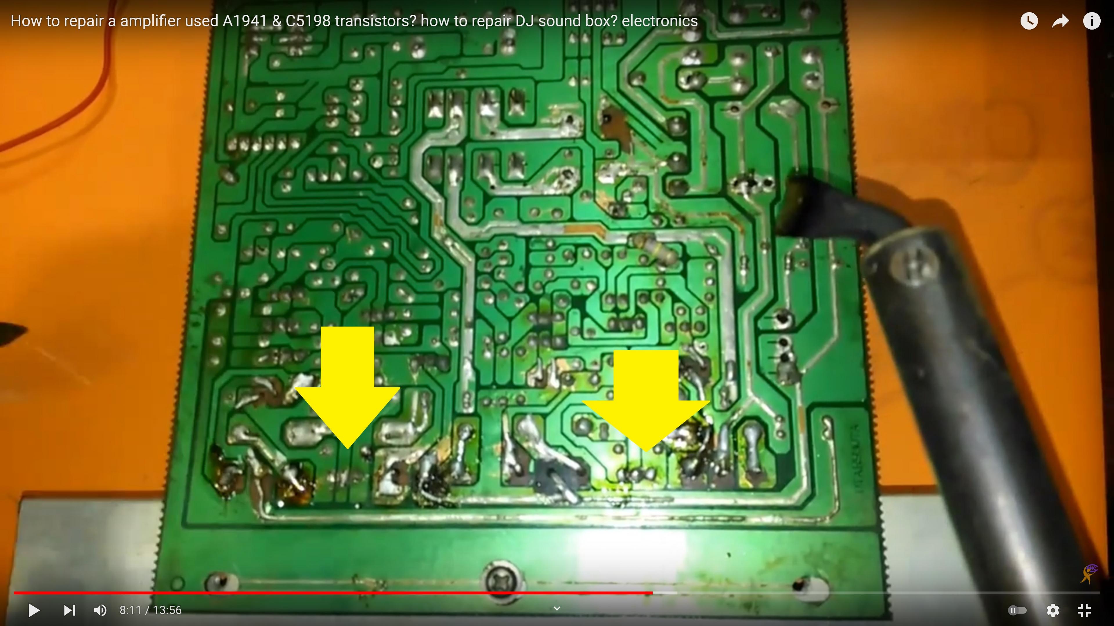

The bias generator is usually a transistor that is in contact with the main heatsink. It could be any shape or type.
Thanks it has two of S9014 transistors
Yeah , the third man 😀 - here for instance:

You would have to be able to identify the bias generator and determine how to initially link it out and then when/if you fix the amp how to alter the values to get a suitable bias current.
See pic - I've arrowed them
