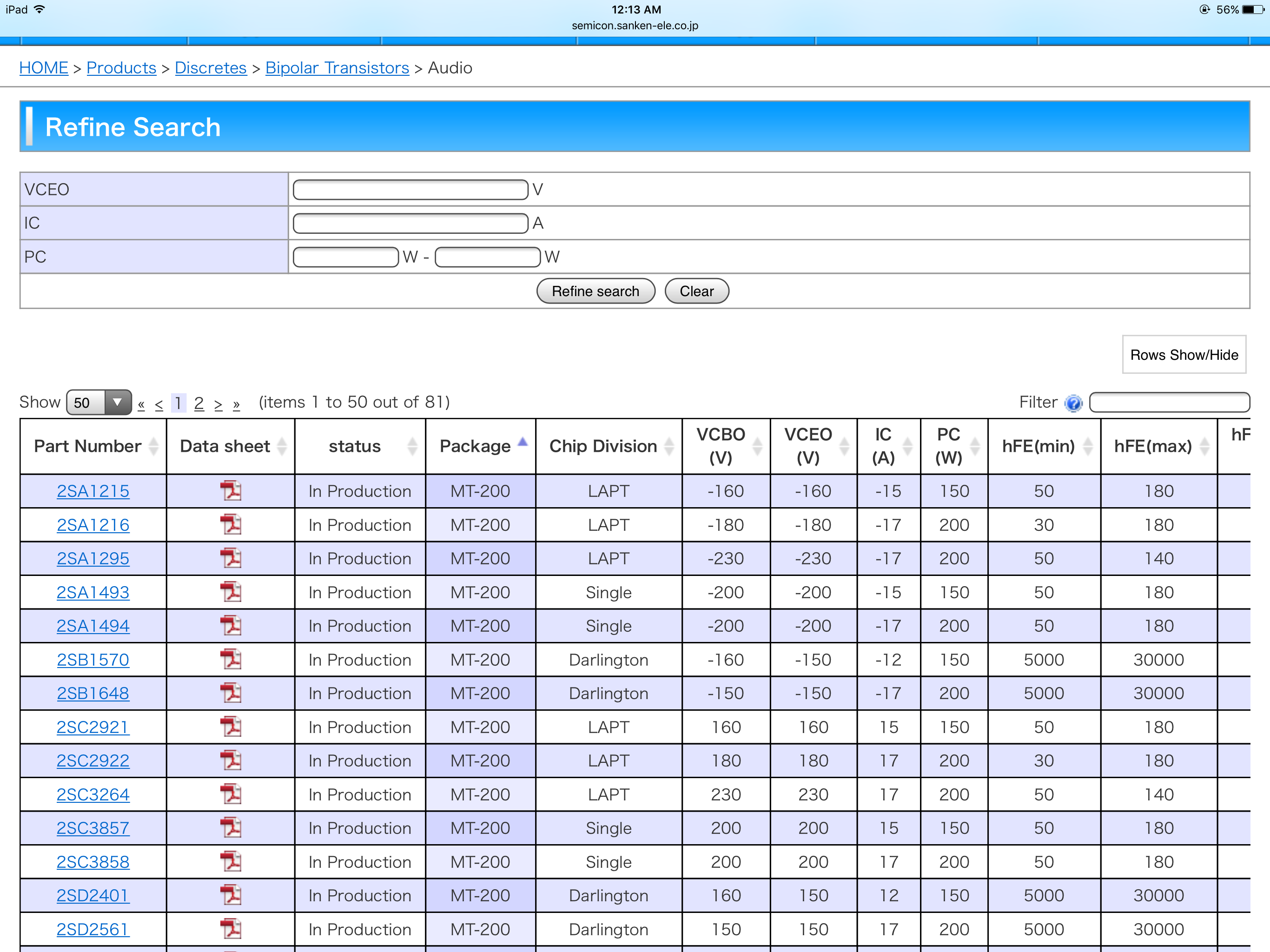

A1491-1494 and C3855-3858 are single chip power devices
1215 and 1216 / 2921 2922 are LAPT
That is the main difference in topology
Here is a quick look at the big SanKen offerings
