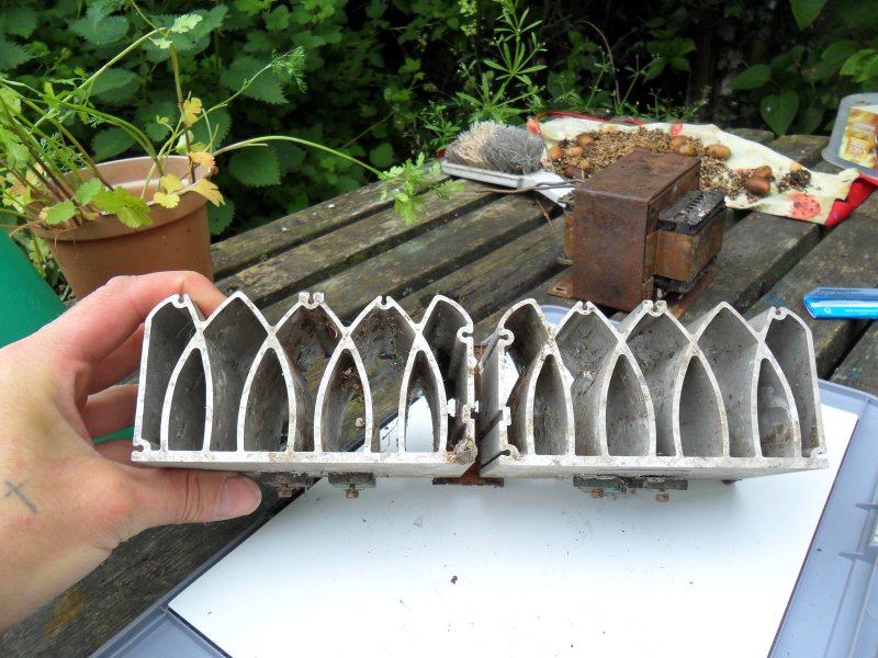

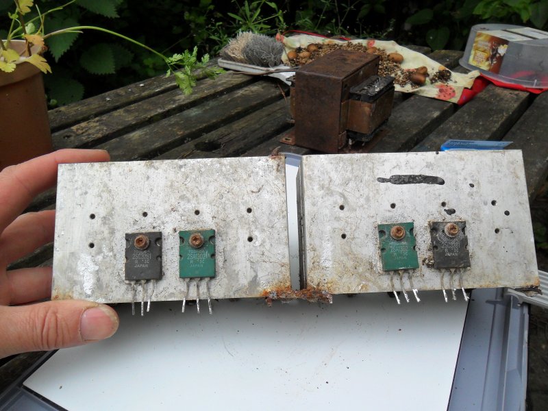

Here's some pics of the transistors in question. AFAIK Pioneer are still using these transitors in current domestic kit, like the VSX series of recievers etc. Therefor they must still be making them.

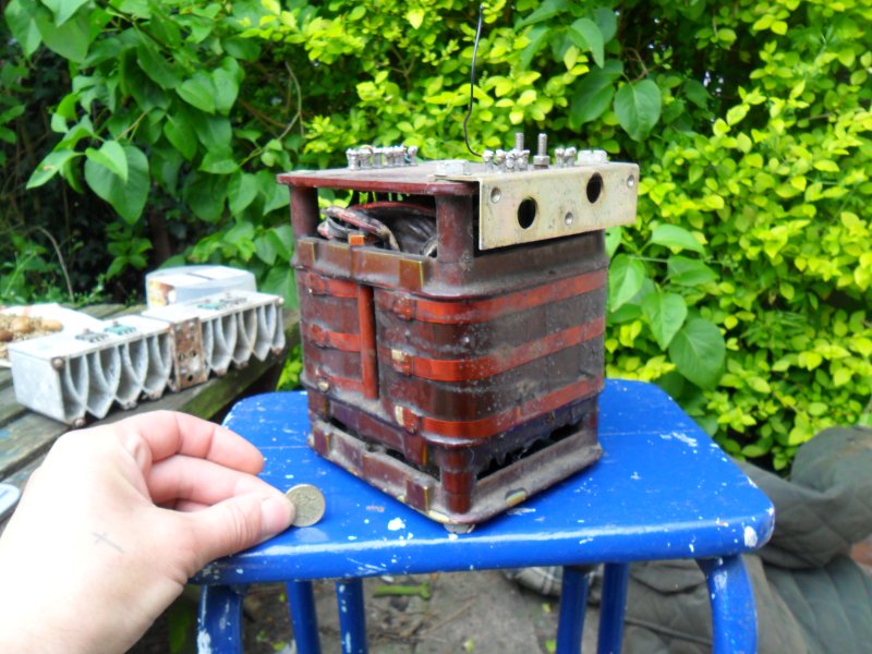

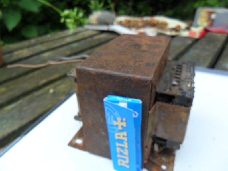

Here also is pics of some other vintage transistors ( Mullard 8 New x 29'sOC, Hitachi 2SB337's and some early Sony 2SC895's I have stashed as well as a huge 80v 10A Partridge transformer which could make an interesting amp.
Thanks again for all your input,Andy.

No, the 2sa/c went obsolete about 20years ago.
Their replacements went obsolete nearly ten years ago.
I think Toshiba obsoleted purely to outfox the fakers.
But faking seems to be big business and some big business is prepared to invest in any illegal methods to generate profit.
