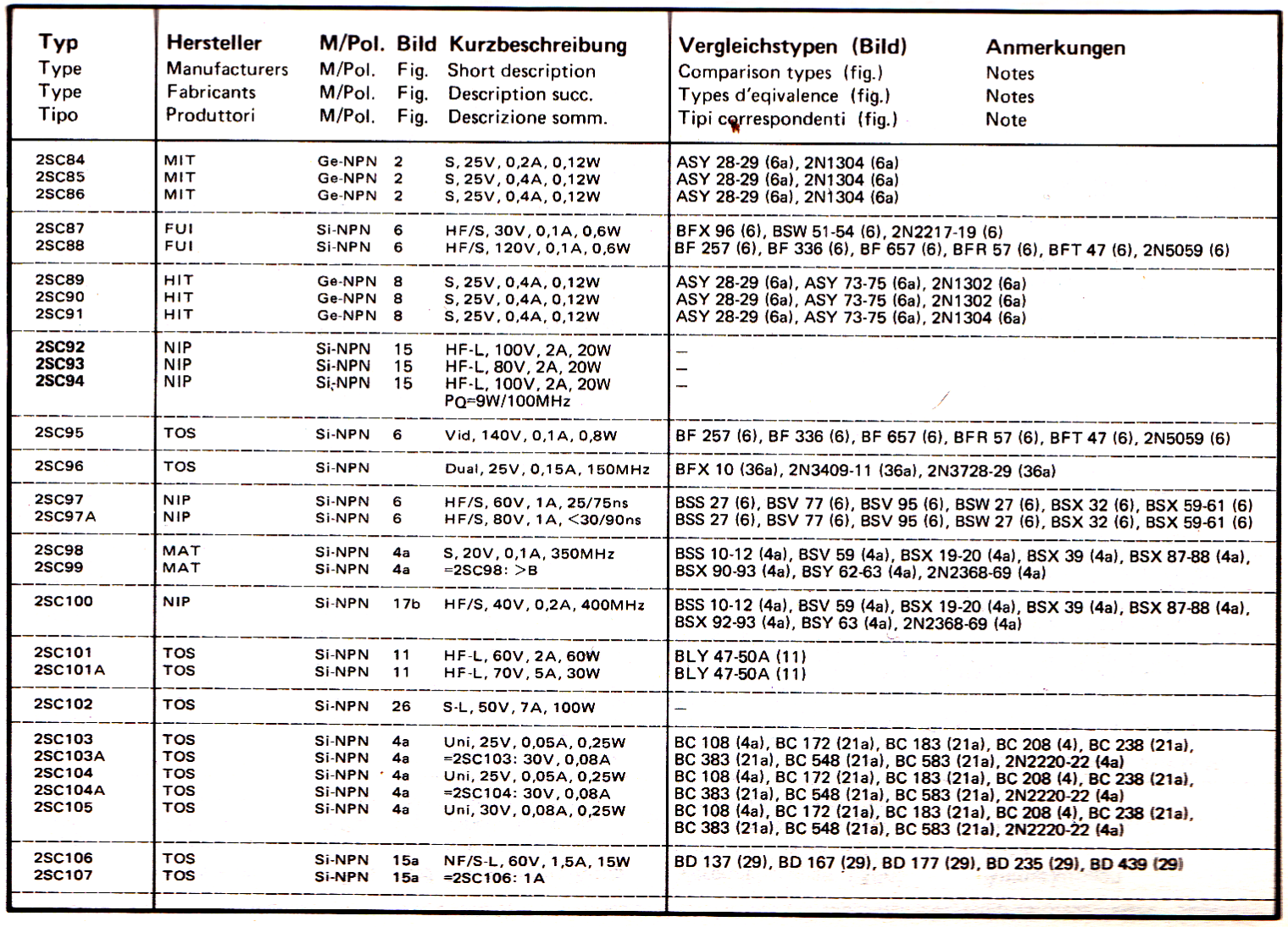

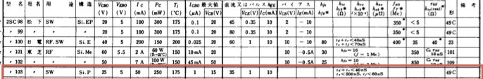

I'm fixing a transistor guitar amp for someone, and found the culprit of the problem to be an old 2SC103 transistor (base to emitter is OK; collector to base fails the diode test on my DMM).
I'm having trouble finding decent info on this one (or a NOS replacement...). The only thing I found is from a page of an old Japanese reference book. (see attached image).
According to those specs; would a general NPN like a BC547 be suitable?
