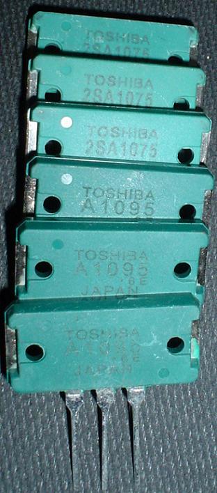

Original A1075/C2525 RET manufacture was by Fujitsu.
Surprise surprise : Toshiba releases the higher powered A1095/C2565 years after the introduction of the Fujitsu devices, and for some reason the series numbers look like close cousins.

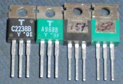

Still pretty cool devices, especially the 200Vce B-type.
Don't judge a book by it's color.
Toshiba changed the logo for all of their devices in the later production phase, and the cases to All-Afro.

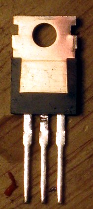

Only way to find out is to measure the things with a capacitance meter. (there are schematics and kits for simple cap meters on the web)

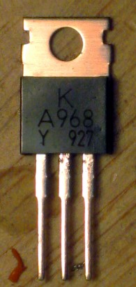

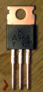

I don't have a picture of the 968s yet. Not sure what they are, but they have a K A968 on them.

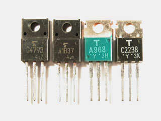

I checked Toshiba's web site and the replacement for 2SA968/2SC2238 pair is 2SA1837/2SC4793 which has the same SOA. As pointed before by AndrewT, 2SA1930/2SC5171 pair doesn't have comparable SOA to 2SA968/2SC2238 pair. My bad...

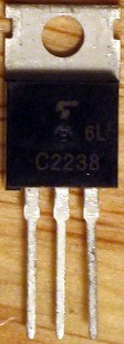

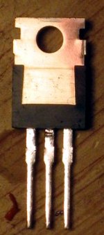

The logo on Filburt's 2SC2238 is the same as the one on all Toshiba devices I purchased in Japan in recent years. My 20 years old 2SC2238 (and others) have the logo same as what jacco posted. One concern about Filburt's 2SC2238 is the order of markings:
Many of TO-220 devices (if not all), like 2SA1837/2SC4793, has markings as follows:
T (new Toshiba logo, as seen in Filburt's image)
Device name (with omission of "2S")
Lot #
Line for Pb free device
I only checked the spec sheets and acutual devices for a couple of TO-220 devices but all were the same. Does anybody know more on this issue??

Sing a Gershwin tune :It ain't necessarily so.
Could be a Korean KEC manufacture version, Toshiba has a stake there and some of the oldies are manufactured legit in Korea nowadays.
I haven't seen a KEC 2SA968 version face to face yet though.
2SC2238 can be genuine with some luck.
2SA968 may be KEC, FEC or SEC (but not NEC) who knows.

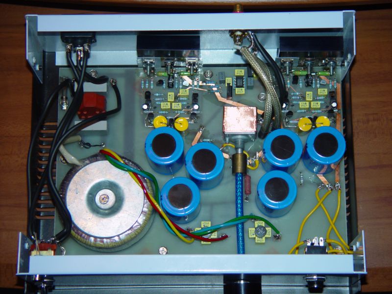

Filburt,
no, Q10/11 set the main properties of the output stage.
Very nice design indeed. I just cannot understand why 2SC2238/2SA968 were chosen since 2SC5171/2SA1930 are better (if genuine). In any case, I would use large heat sinks.
Better how so? Considering the myriad of contradicting statements one sees when trying to get an idea of what is a good choice to use, I'd say most choices are less-than-obvious. I tried my best to pick something appropriate 🙁
Filburt,
sorry, I did not mean to blame you, just was wondering why 2SC2238/2SA968 were originally chosen here. 2SC5171/2SA1930 are faster, have lower Cob, widely preferred and surely better sounding. On the other hand, with 2SC2238/2SA968 you don´t risk running into oscillation problem.
These are original Toshiba 2SC2238/2SA968.
The newer 2SC4793/2SA1837 are very similar. They spot the updated logo. No longer the old "T"
