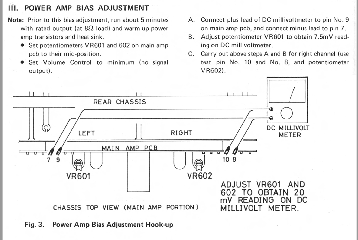

Adjusting bias on the Rotel RA-913 which is now working!
So, an adjusting bias question...
Service manual says:
"adjust to 7.5mV"
AND
"adjust to 20mV"
DC offset reads:
3mV Left
6mV Right.
I’ve just replaced all four output transistors with:
MJ15022 (formerly 2SC1403A)
and the drivers on left channel with:
KSA1381 and KSC3503
Naturally still feeling cautious given that I’ve only just got the amp working again.
Currently at bias is 7.5mV on both channels.
Please could anyone advise on most appropriate bias to adjust to?
