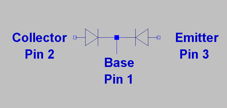

That is the way they should test, with no connection between the collector and emitter.
(see attached for the way they should test on diode check)

RJM1, thank you for the image! That makes perfect sense, and quickly tells me that my testing method was wrong. I was using the test based on Transistors and testing all 6 possible connections. My folly was that I somehow forgot that the C to E junction should test open both ways. While incredibly helpful, I'm afraid I've just jumped out of the frying pan and into the fire as now I have no clue what could be the real problem.

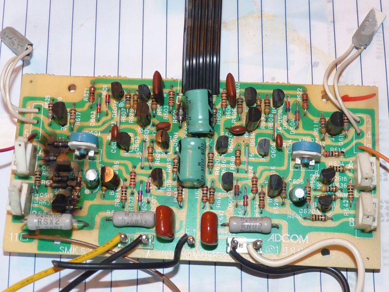

embrown057 (Dr. Emmett Brown?), I was given this amp by a co-worker. She said it was powering some electrostatic speakers of some sort (she didn't specify and I didn't ask). The left channel has never worked for me, and the amp had repair service tags on the cord so I assume it's been worked on before. I used it happily as a mono-amp in the basement hooked up an old (70's era) Jensen speaker. The good channel sounds quite lovely. When I finally got into inspecting it, I found heavy damage on the input board. R601, R633, R635, R637, R639, R661. Q601, and Q611 were all very destroyed (leaving scorch marks on the board). The board itself does not look like the image in the service manual. The front is silk-screened "SMK S394V-0", "016X-1037A01", "Adcom C 1986" and uses horizontal inputs in the back. I can post a picture of just the board, if needed.

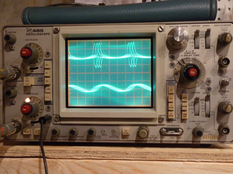

p.s. Attached is the board as removed from the amp, and then my scope trace at 50VAC after repair attempt one. No real reason for posting the pics, everyone loves photos-even of bad repairs.

I would also suggest using the Vishay/Dale “RL or RN or even the CMF line of resistors on that board. They will not burn and scorch like the old ones did and are very low noise. Just my option, I use them a lot and they are inexpensive. I have seen a lot worse than your board restored to working condition. I would have liked to seen the view of the foil side just out of curiosity. The other point is watch out for parametric damage to sounding parts, that can really bite you if you’re not careful. The fact that there is damage from the input resistor R601 through the differential pair Q601 & Q603 and onward I would be quite suspicious someone installed some transistors incorrectly (wrong polarity) and or just the wrong parts altogether. The only other time I had seen this was lighting /power surge damage. I would also replace all the electrolytic caps on the board. I see you have more than adequate equipment to facilitate this repair and Shure enough knowledge. Just take your time and patients, as one technician I highly respect told me “follow your inner voice” if you’re not comfortable or have doubts (after testing of course) “Swap it out”. Keep us posted how you’re doing, these are great amps regardless of others hacking them with questionable upgrades.

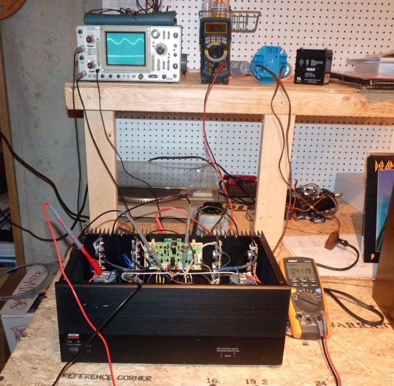

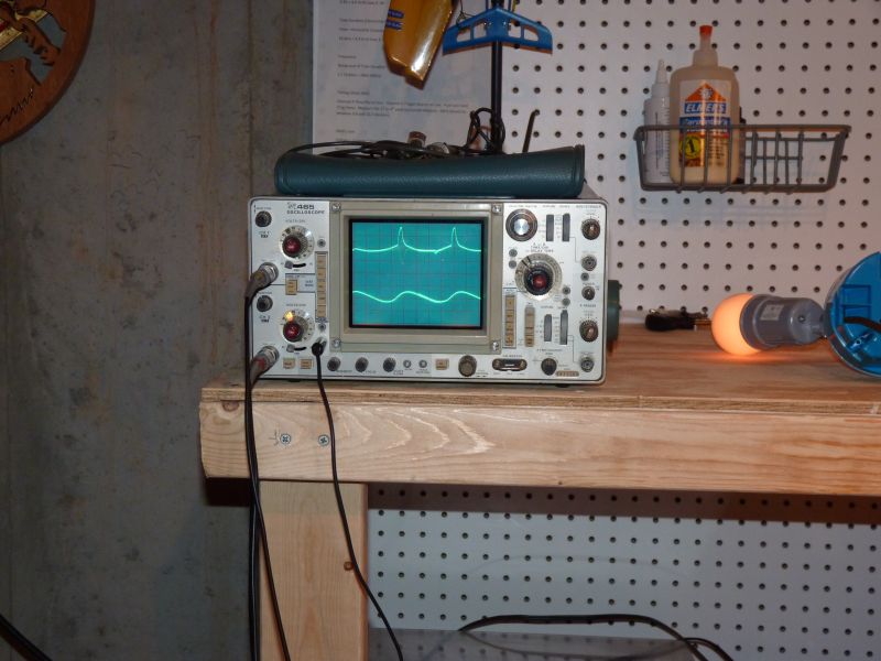

So... On to where I am tonight. I figured before I dissembled everything to test every component, I would do some testing under power with everything connected. I feel the Variac was invaluable here, as I can keep the amp at 50VAC without any smoke or hot components. I went through every component with the O'scope testing each lead with power on and comparing it to the speaker out trace. Most of the circuit exhibited the same oscillation, although one half of the paired input transistors was relatively clean. When I got to Q3 and R14 (Is that the emitter???) I got a very strange trace. I've attached some pictures, sorry for the blur - I was trying to capture the full wave and needed a longish exposure to do so (needed a tripod).
My question: Does this indicate that Q3 is bad? I intend to remove/replace/test regardless, but if someone can say "THAT IS IT!" I would be very happy.

I would suggest you not even power the unit back up at this time due to the catastrophic damage to that one channel. The amp has fuses on the output boards and if you want to check to make sure the one channel you believe is working, remove the fuses from the dead channel and power it up. This amp will show sign of oscillation if the power is not up to threshold. Just watch your amp meter on the variac for over current draw. I still would not power the amp up till you straighten out that mess on that one channel. There is no way to realistically evaluate the different stages on that circuit without all the parts in place. I know it’s a lot of work to pull all the devices on that board and test them but you have no choice. The one good thing is you have parts that will not require testing like the burnt ones. You need to just replace and the caps also (electrolytic). I would also order a small batch of each transistors so you can match the Hfe as close as possible 10 or so is all I ever order of each. The drivers and predivers 4-6 for each should be fine unless your pockets are deep order more. I order my original transistors from http://www.bdent.com/ make sure you get the correct gain group (Hfe) of the transistor. I would look at the good channel and check which Hfe class was used and just order the same type. The resistors and caps you can get from Mouser Electronics if so inclined. My main point here is first and foremost, repair the input board first. Even if you ordered every part on that channel the cost would me nominal. The real money will be in rebuilding the outputs if needed. The output sections will still have to be evaluated. Even if all the transistors and emitter resistors are fine I would still dismount all the outputs (both channels) and replace the mica insulators and thermal grease. The grease dries out after a period of time, take caution if you considering using silicon insulators, most are unsuited for this application. Laird Technologies has a T-Gard 210 that has a very high puncture/tear resistance but may be hard to obtain. Just take your time, use your DVOM and transistor tester to look at every part in that channel. I would also suggest start a log and copy the data from your finding s, that way you will have a reference to order parts also. I still would like to see a picture of the foil side of that board. Keep us posted.
