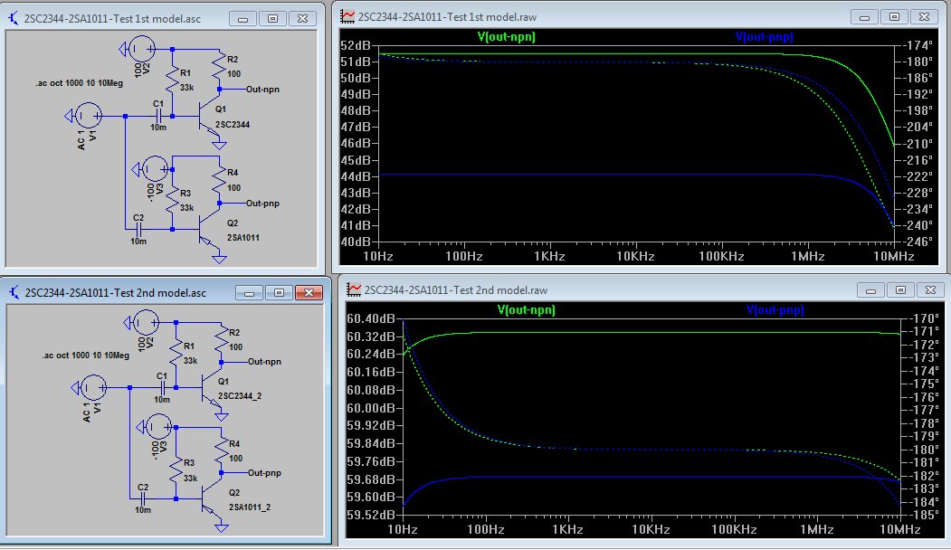

i see that CJc and Cje values are quite slower in 1st model than in 2nd, and (see my screenshot) AC analysis are acting different, with a strange "band-pass" behaviour on the 2nd model..or it's not strange? 😕 😉

this is the 2nd model set (don't know how was born, except from data sheet graphs)
Code:
.model 2SA1011 PNP(Is=6.734p Eg=1.11 Vaf=100 Bf=106.7 Ise=6.755p Ne=1.328 Ikf=2.481 Nk=.8564 Xtb=1.5 Br=8.268 Isc=6.734p Nc=1.167 Ikr=.9435 Rc=1.155 Cjc=483.8p Mjc=.3806 Vjc=6.248m Cje=500p Tr=181.1n Tf=1.603n Itf=1.08 Xtf=4.227 Vtf=10 Vceo=160 Icrating=1.5 mfg=Sanyo)
.model 2SC2344 NPN(Is=26.94p Eg=1.11 Vaf=100 Bf=333.1 Ise=192.6p Ne=1.488 Ikf=2.436 Nk=1.017 Xtb=1.5 Br=216.9 Isc=241.8n Nc=2.259 Ikr=482.5 Rc=.6049 Cjc=250.5p Mjc=.4004 Vjc=11.36m Cje=250p Tr=33.47n Tf=1.526n Itf=13.13 Xtf=41.6 Vtf=10 Vceo=160 Icrating=1.5 mfg=Sanyo)

"out of whack" means "is very wrong". it's an "americanism" that has it's roots in the fact that the old rotary TV tuners often got dust or oxidation in the drum contacts. the tuner would develop intermittent faults that could be temporarily fixed by whacking the side of the TV set. so when the TV started getting poor reception or had a blank screen, it was "out of whack"
the CJC and CJE values for the second set of models is around 350pf which is very high, the 45pf or so in the first model is closer to the truth.
no i did not design the APT-1, Tom Holman (THX, Audyessy) did back in the late 70's. i worked there for 5 years as an amplifier tech.
the .subckt part of the first two models is the stray lead inductance and capacitance of the TO-220 package. the .model portion of the transistor models can be added to standard.bjt and this adds the two devices to the drop down list of transistors in the Change Transistor dialog box.
the models were generated from the parameter dialog, but reading through the models, they aren't completely identical.
the "bandpass" that you are seeing is because of the 10m cap in the test circuit
