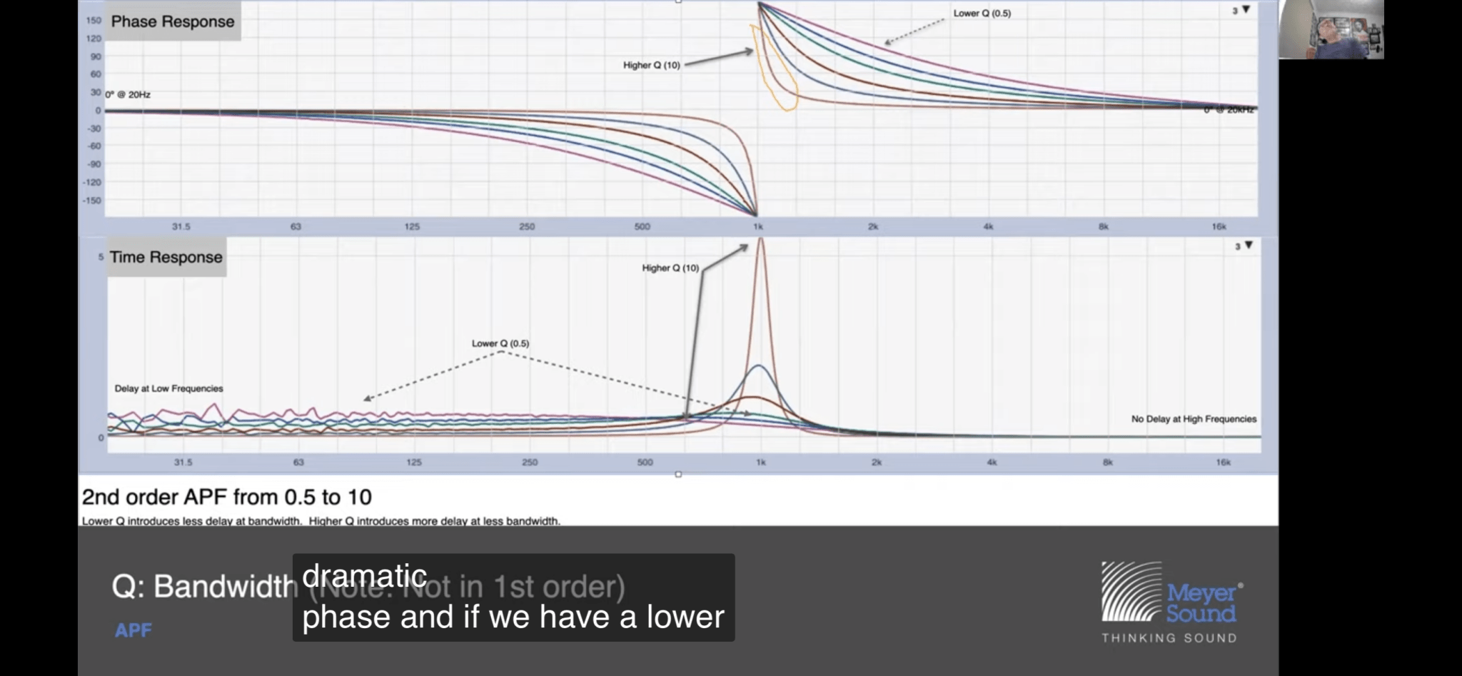

I recently took a look at allpassfilters with a few webinars and now I’m wondering if you could possibly „change“ group Delay with a 2nd order allpassfilter with high Q factor.
Allpassfilters shift the time delay of the lower frequency’s where the filter is applied.
If you use a high Q factor it would shift the time at the frequency where the filter is applied even more than below that. I attached a picture to show what I mean.
Yes the overall phase shift characteristics (and therefore the group delay) of an existing filter could be changed by using an allpass filter in cascade with it.

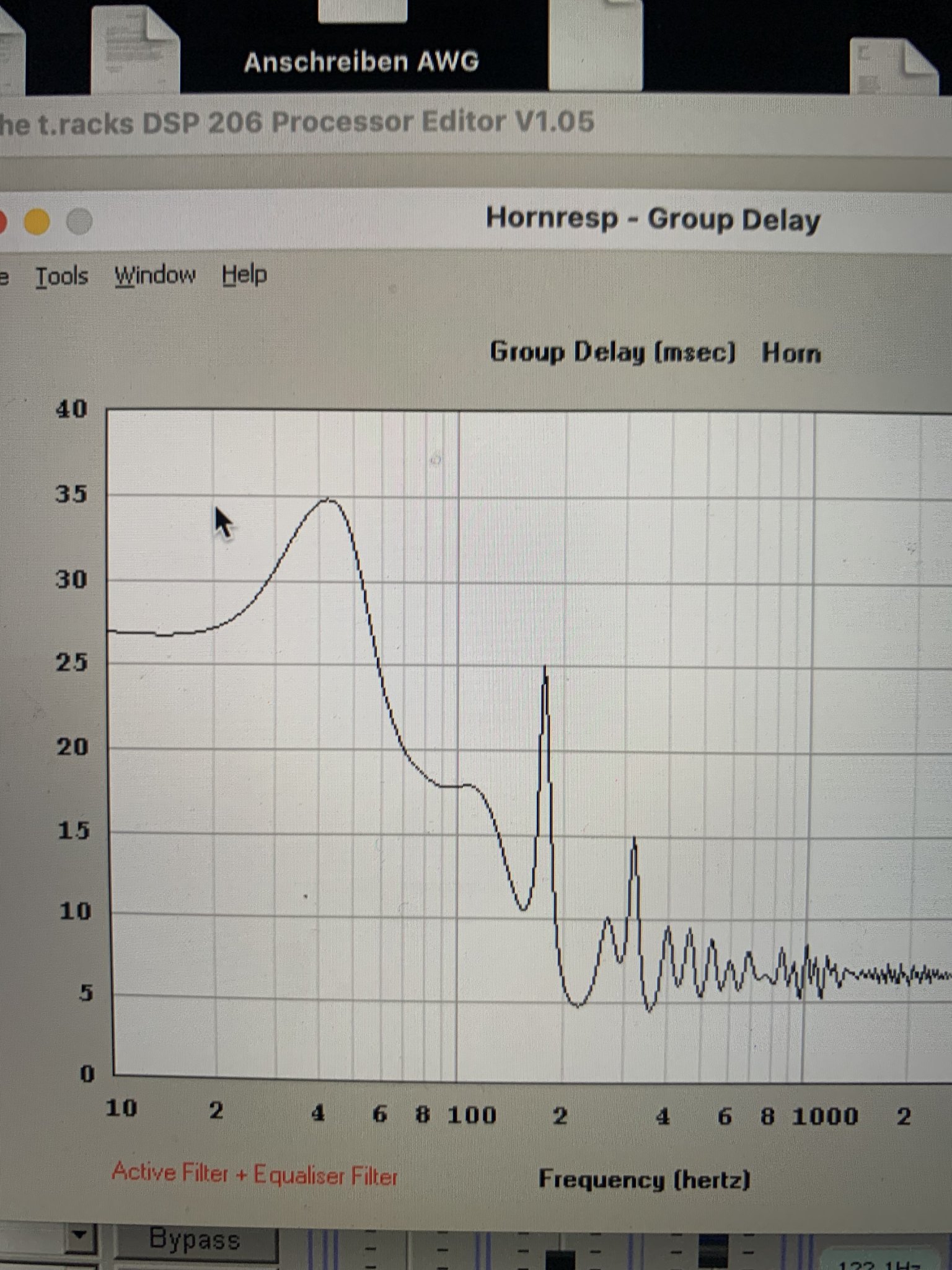

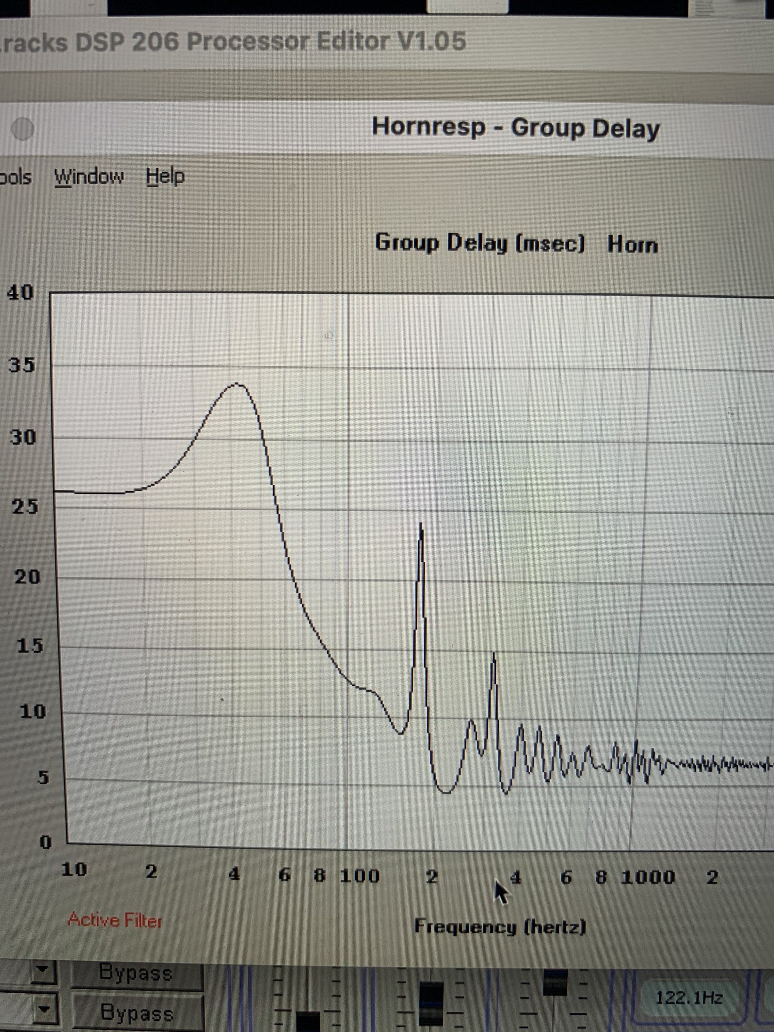

just wondering about the subs response when for example playing a kick only to the subs.
Imma post 2 examples. The first picture is with only a highpass and lowpass Filter Applied.
The second picture is a highpass, lowpass and an allpass applied. With the allpass set with a high Q factor so the frequency’s at 80hz get delayed more than those at lower frequency’s. If you’d play a single kick through both of those subwoofer with different settings, shouldn’t the second one sound tighter? Or are there any major disadvantages on allpass filters that I miss?
I know Hornresp can’t set allpasses but since we’re only looking at group Delay and not magnitude a normal filter should do the same to Phase and group Delay.
