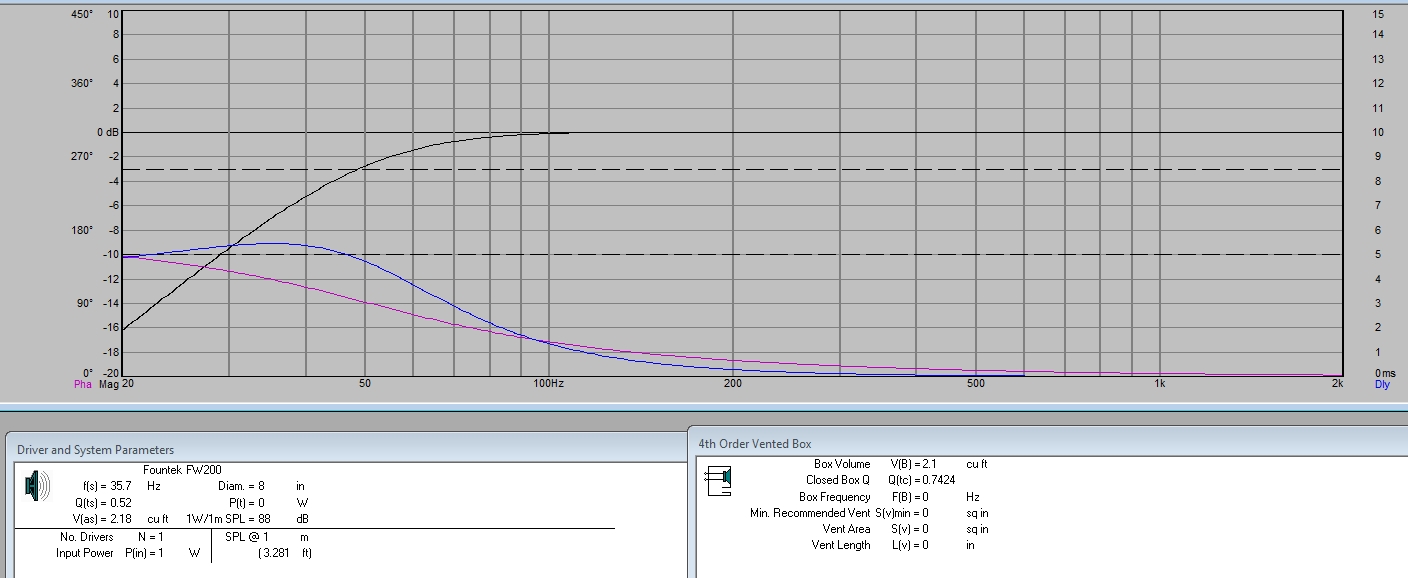

Thanks...that clears it up a bit. I'm trying to use WinSpeakerz to help design this thing but it only lets me put in 1 driver at a time..? So how can I determine the best box size / shape by doing 1 speaker at a time..? Not to mention when it gets inot crossovers....now I'm really lost..🙂
The box is determined by the bass unit only.
Sealed is 2nd order, vented 4th order.
3rd order has a series bass capacitor.
Choice of the alignment depends on driver and box size.

This what I get for the 8" woofer
