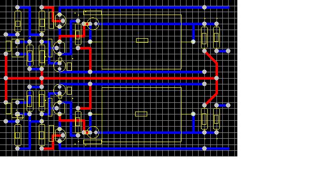

This's my CODA PCB.
A few days it will be able to a DIY PROJECT ! (sorry for my bad grammar)
May be it's a B1's killer !
he he he

Semi completed PCB
This's my CODA CLX PCB cloned.
There's no power supply, in my idea I have Threshold Fet 10/HE on hand and I decide to use its adjustable supply rails.
I don't like PGA2310 or CS3310 because of it made me not a purist high-end solid state !

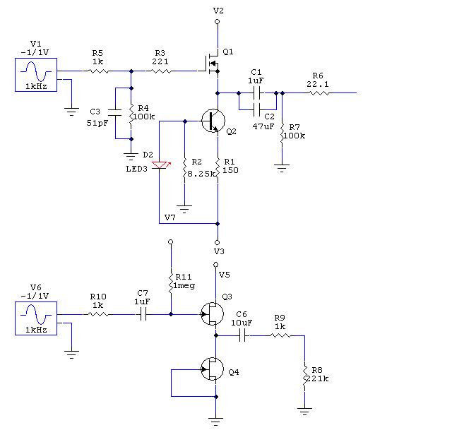

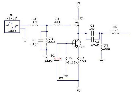

Questions for ANADIGIT
Coda_CL_Preamp
Following schematic what kind of transistors are
Q1 and Q2
Resistors R4 and R7 are 100k (1002) or 1M (1003)
Capacitor C2 (47uF) is Elko or bipolar (orientation)
Led3 (D2) is green ,red or...
Power supply voltage is +/- 15v or ...
can you measure voltage across R1 (150 Ohm)
some input and outputs are balanced , how they made it ?
Thank you very much
Q1 is Zetex mosfet and Q2 is MPSW92
R4,R7 100K (I shown!)
C2 is Panasonic Nonpolar bicap with MITCAP
LED is white
+/-15V with easy regulation 7815/7915
Voltage across R1 is 1.5V
Balanced input and output are FAKE (shorted - to G, some told me balanced input so sweet 😛)
ANADIGIT

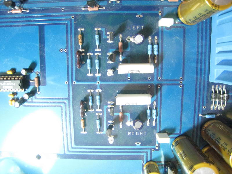

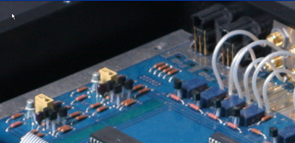

Can you tell me for Q1 what mosfet (Type ,mark)
Q2 is MPSW92(pnp or MPSW42 npn)
What it in the left side of preamp (picture left.jpg)
something like dual fet or...
Can you post a few more pictures of preamp - please clean the dust first
thanks a lot
