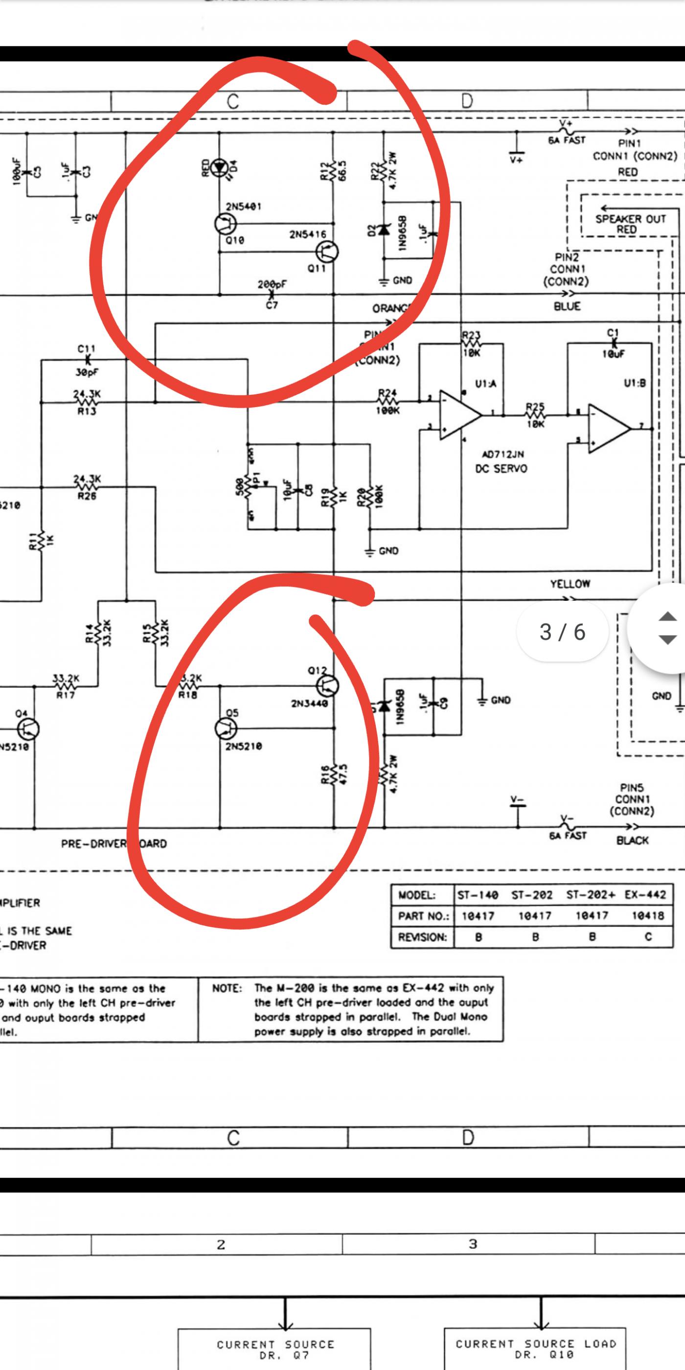

Im currently rebuilding a couple bkm200 monoblocks and i have recapped everything and got them in use at the moment but ive read a few post on here that these bjt metal case resistors did not have enough heatsinking in these amps. They do have the little stamped aluminum fin type that sit over top of them. My main question is i pick some new ones with the same bjt number will they be the same as far a specs go but just maybe bult better. They are thr voltage amplfing stage before the mosfets. These are motorola types and about 30 years old maybe 25. Any guidance would be appreciated. Ill post a pic of thr schematic.

Your approach is kinda backwards. Thermal dissipation is given by operating current and voltage, which have been chosen by the amp designer. There's not much you can do about that.
You'll have to hunt for some TO-39 (TO-5 etc.) heatsinks and see whether they make anything better than what you already have. Those with some metalworking abilities may even want to DIY something (maybe find an old CPU heatsink or similar to saw apart and drill a TO-39-sized hole in the bottom).
Im just starting to learn this stuff. I dont have anyone to to teach me but ive been doing lots of reading. I know im proly backwards but im finaly to the point to where i atleast know enough to ask kinda the right questions. Trying to lean this stuff on your own is very difficult when you dont even know enough to word the question correct so i proly am doing this backwards but im not sure what forwards is lol sorry. I recapped this amp and im replacing the resistors with higher tolerance. A gentleman on here has posted on these bjt used in my amp and stated he has replaced quit a few because of not enough heatsinking. Im not trying to redesign the amp at this point. Im just trying to learn the circuts and how they work and how to match up the old parts with newer better qulaity parts. I guess my ma8n question is that are all bjt transistors either new or old with the same 2n part# do they have the same specs. Or to word it differently what specs of the bjt are most improtant to make sure thay matches up and which specs do not matter so much and will only help the life or performance of the bjt.

I guess my main question is “do all BJT transistors (new or old) with the same 2nXXXX number have the same specs?” (GG - almost always, yes! But, there are so many Chinese Fakes, that you really need to be careful where they're sourced from. Not even Allied and Mouser are 100% safe, tho' they're way better than EBay and Amazon.)
Or to word it differently what specs of the BJT are most improtant to make sure thay matches up and which specs do not matter so much and will only help the life or performance of the BJT. (GG - all the specs!)
Good fellow — you're doing just fine, it seems to me. If I could gently offer one piece of advice, it would be “don't try to reëngineer an existing design” unless it is actually (while being used) showing signs of deficiency. Replacing a couple of little heat-sinks with ones that fit (of course), but that bigger fins, is not reëngineering. It is being prudent. And it is cheap. Do it.

You haven't bothered to list which hemisphere you are in, so those $3.70 heat sinks might not cost you $6.80 each to ship from CZR.
But if you're in the western hemisphere, newark has nice TO5 heat sinks for $1.02 and TO-39 for $2.95. Measure the diameter of your cases and order appropriately. The smaller the number of deg C per watt, the better the heat flows. Shipping is about $8 to IN from SC.
You won't find any major house selling metal case transistors anymore. It is all TO202 or TO220, with the pins in a different order, bce instead of ebc. Sometimes when you twist them around they fall off after some years. Small houses that do ship metal case transistors usually leave most the specs off the data sheet. Vce sat, that all anyone needs to make a switch, right? Why would anybody use a transistor for linear amplification when we have class D? Just because everything modern has to be thrown away every 5 years, that keeps the garbage men employed, right?
