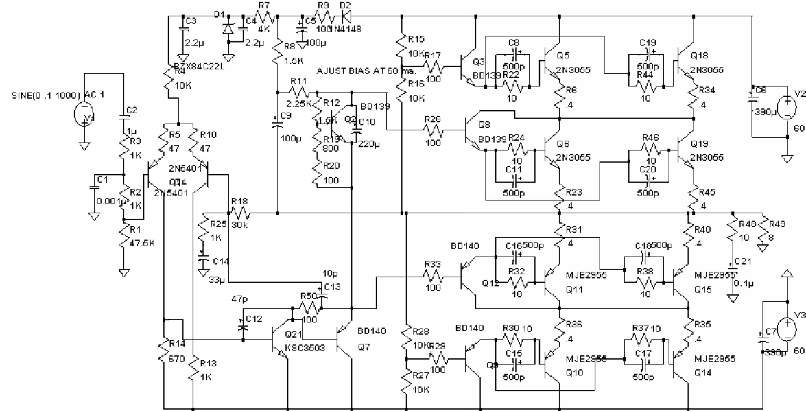

Here is A amplifier with 2n3055 transistors on its output for those of you that are looking at doing a bang for buck amplifier with all those 2n3055 lieing around that as most electronics guys think when they look in there junkbox there must be something i can do with this stuff?????? Well I really don't know for sure if this amp schematic is able to do what is says but even if it comes close thats one way to make use of of those 2n3055's lieing around for a pa type amp even. Can anyone have a look at this schematic and see if it is actually capable of producing what it claims???? I would appreciate it my maths says it would produce around 150 watts but iam not 100% sure. I would like another eye on it. It just looked like a good bang for buck amp. Thanks

Thanks for fantastic response always good to hear all of your comments. But what mystify's me is the Collector to Emitter argument that it won't handle the voltage. Most 2n3055 datasheets will handle at least 60 volts between there collector and emitter the rails in the schematic i put up are 55 +- between ground that means that the collector emitter will not be getting more than what it should so where does this the amp can only have rails of 35 to 42 come from. Unless the data sheets lie. the full +- rail does not sit across the output transistor. So i don't see voltage rails as the problem in that regard. I think where a lot of amps fail in my experience is in cooling. I've come up to some 2n3055 amps at the back where the heat sink is and you could cook a egg on them. I couldn't imagine that would be doing them much good. I had a look at 2n3055 inside comercial famous amps not many schematics plus not many powerful 2n3055 schematics as in you want some grunt out of these suckers as there generally used for either a bass amp or some sort of bang for buck pa application. People generally don't use cheap transistors in hi fidelity amplifiers. I know i wouldn't build a bang for buck amp for my lounge room. But for pa a bass amplifier perfect loud and cheap.

When the output swings to each of the rails under full power signal conditions the off transistor sees nearly the rail to rail supply voltage. There are much better choices for most of the semis in this amp - they were chosen way back when there were not many
devices to choose from. If you really want to use older style devices 2N3773 is what you should use for outputs, bigger die, much higher Vce, better beta.
It is also very odd to be using BD140 devices in the diff pair and the TIP device in the VAS.
I expect that the 2N2955 will fail.
I don't suggest building this, but if you really want to, use 2n5401 for the diff pair, and MJE15032/33 for drivers.
Find something better for the VAS.
Your in the USA. Mother mouser has MODERN njw0281/0302's for under $2/25 , ($2.31 apiece) why would you bother with ancient history ? 4pair-250w = a $16-$18 Op stage @ 250Vce - 30mhz Ft. 😕😕That would be a great heavy duty amp if one where to use 2N3773's in the output stage and in a BTL configuration. jer

Iam fully aware there are better semiconductor devices out there. In fact some would wonder why you would even bother building a bjt based amp anymore. But this is not about better semiconductor transistors its about just using up old supplies in a junk box and making use of them. I KNOW YOU CAN GET BETTER. The thing is they are readilly available and most guys can put a amp together for next to nothing that they basically don't care to much about and use in situation where the care factor is next to nothing. Sometimes at a party you don't want to be sitting there worrying about your role royce amplifier. Does anyone have the Maplin 225 watt schematic that i keep hearing about i can't find it anywhere thanks.
The amp will not work as shown, it is pathetic - you asked and you don't like the answer.
And we are teaching you since you don't seem to know the Vce requirements for devices.
