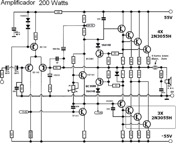

Here is A amplifier with 2n3055 transistors on its output for those of you that are looking at doing a bang for buck amplifier with all those 2n3055 lieing around that as most electronics guys think when they look in there junkbox there must be something i can do with this stuff?????? Well I really don't know for sure if this amp schematic is able to do what is says but even if it comes close thats one way to make use of of those 2n3055's lieing around for a pa type amp even. Can anyone have a look at this schematic and see if it is actually capable of producing what it claims???? I would appreciate it my maths says it would produce around 150 watts but iam not 100% sure. I would like another eye on it. It just looked like a good bang for buck amp. Thanks
It has enough output transistors (with adequate heatsinking) and enough
rail voltage to be able to drive around 200 watts into around 3 to 4 ohms.
The "output protection" looks very dubious to me, being driver based.

I don't really recommend this design. THe 2N3055H (H is important!!!) can handle 100V Vce. And +/-55V is a little bit overkill for this.
I saw 250W amplifier with 2N3055, but it was bridged, and gives 250W/4ohms, with 6pairs of them.

with quality parts and rowbust power supply is very possible .... bryston i think had similar circuit but may be i am wrong ..
the 2N3055 is good for rails up to +/-32volts.....i do not see how it can run safely at rails of +/-55volts.....
The choice of all transistors used is awfull...
Differential pair use non adequate transistors,
the VAS use a low frequency tranny overvoltaged ,
while the output stage use old, slow and overvoltaged ones..

That is what I like cheap simple high power design that does not use exotic parts.
I am sure it will do that kind of power as My sunn concert slave does 180 watts on just 4 of them and 120 watts clean. jer
That would be a great heavy duty amp if one where to use 2N3773's in the output stage and in a BTL configuration. jer

Assuming that the "2N3055" used can handle the voltage. 200 watts from 55 volt rails is possible. It only takes one transistor avalanche to blow them all up!

The max power supply you can use the 2N3055 with is 70V total or +/-35V. That is ignoring any serious SOA issues.
No way you get 200W from this device even massively paralleled.

some, 2N3055, 2N3055A, 2N3055H are 60 VCE
other, 2N3055HV are 100 VCE
also TIP41C is 100 VCE
- circuit shows +-55V = 110 Volt
which is beyond safety margins, even if you use 100V 2N3055HV

what do you consider a safety margin?
As a 55v supply voltage is well below the maxium spec of 60V.
You have to remember that ,that was considered HV back in the day.
Not 80v on some of todays amplifiers and the problem back then as today is when it comes to a low ohm load is how much current can it handle at that voltage level this is Pd.

Its + and - 55 so the max voltage across the device can be 110V....
I did build some amps with 3 ea 3773 parallel in the dim past, and it worked well.
But they are relatively slow so THD above a few kHz goes up quickly due to xover distortion.
