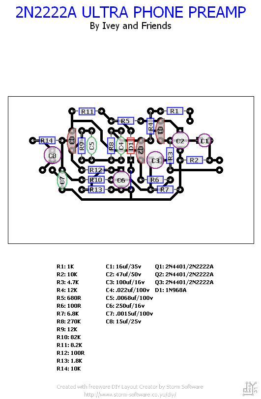

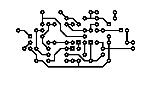

I am posting the beautiful layout of the 2N2222A, with PCB layout, and BOM.

Ivey, being that many of us are tinkerers, I promise to tinker on this circuit.😉
I was wondering about replacing the 15 uF electrolytics at input and output with film caps. Or at the least, paralleling a 10 uF and 4.7 uF Silmic caps on input and output. The Elna Silmic caps are highly regarded. I doubt you ran around looking for audio grade components when you put this together.
I already draw schematics and PCB in eagle and in one weak i will have the board. I will post pictures later. 😀 I still don't know which PSU to choose because the one that you post has output voltage 35 V, but i think that phono will work also with 35 VDC or no? Tell me also, what kind of transformer to use for PSU.

C1 and C3
Ivey,
If you're watching this thread, what types of film caps have you tried for C1 and C3? I'll try polypropylene first....they are not that much $$$.
Ivey,
Capacitors
When we first built the unit we used Sprague's Black Diamonds. That was 1959-60. They were really not that good, if you were to compare them today, with the capacitors from China or Taiwan. They were the new plastic type at 10%. If it was not for their size, we would have used oiled filled capacitors.
The new metal film capacitors today (across the board) are of good qualitly. Regardless as to who makes them.
But if you desire the use of MKP capacitors. Please use them and let me know what your results are.

Steven:
Truly, there is no resistor on the base of Q2.
The 82k feedback resistor R6 and C4. provides base bias for Q2.
Putting a resistor on Q2's base may cause it to become unstable.
But go ahead, do some R & D, and let me know. Maybe with the more modern parts and materials. It may improve our old circuit.

Ivey,
Yes, and I am putting a list together of metal film resistors. Is it safe to say that you used carbon comp resistors in the original?
Many thanks for sharing your knowledge.
Resistors:
Yes, we used the best carbon resistors available at the time. Dale, 5%.
There are people today who still enjoy the sound of carbon comp. resistors.
After years of study, about resistors. I still seek out carbon comp. resistors for three purposes. To use them in radio, power supplies and regulators. They are great in those roles. Because they do not add inductance or change the impedance of those circuits greatly. Some of my old friends, would not even give you one of their carbon comp. resistors. They have the old types, when making a good carbon comp. was an art form.
