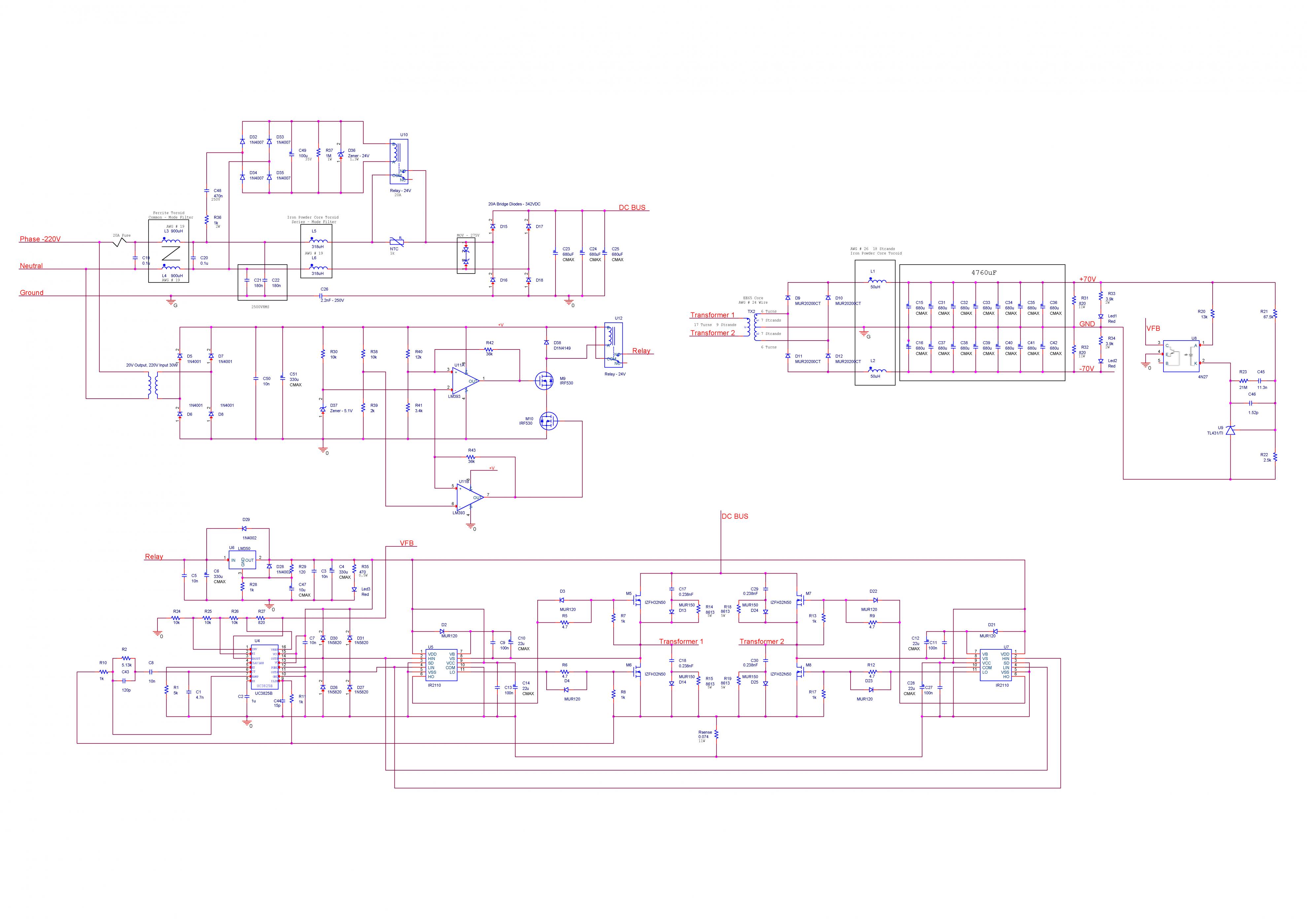

I think the 50W bleeder is overkill. Personally i would use a load of 1 to 2W max per capacitor.
You should add a zener diode from the gate resistor to source to prevent false turn on. It goes between the controller and the gate drive resistor. Almost every ap not for a controller shows a zener there in at least one example.
Your current sense resistor is getting unreasonably large in wattage. Consider a current transformer or a LEM.
For the number of primary turns on your transformer you would need a switching freq around 50khz. You have 100khz now. With a full bridge the controller switching frequency is the transformer switching frequency.
What ohm load are you trying to drive at 2KW
Yea i can use 1W or 2W but in this case, discharge time will be much longer. Actually i dont know which discharge time is proper for discharging. I mean 342VDC must be discharged as soon as possible within certain power loss. I can put a lower value.
Does it have 100kHz ? ı thought switching frequency is half of the oscillator frequency. I have a application note of UC3825, in half bridge it has switching frequency which is half of the oscillator one.
Actually i have calculated transformer turns ratio by the textbooks but they all have different turns ratio. For example i have calculated it as 17:6, another one is 20:7, and final one is 15:4. I really dont know which one is correct. Because turns ratio also determines the flux in the core.
Yea i saw zener for gate of mosfet and i will add it now. I think i forgot to add it.
According to app note of UC3825, current sense resistor was calculated as 9.35W but i added 11W.
As i said before, i have designed it for my friend. I dont have any idea for now for driving 2kW.
I said 1 to 2W because I usually see 2W resistors on large electrolytics.
Half bridge and push pull is 1/2 controller frequency and full bridge is same frequency as controller. You should change your controller frequency to 50khz.
At 1600 Gauss a conservative value for older ferrites you would have 20 pri turns at 50 khz.
you have 17 pri turns, so you are around 1900 Gauss. A conservative number if you are using a modern ferrite.

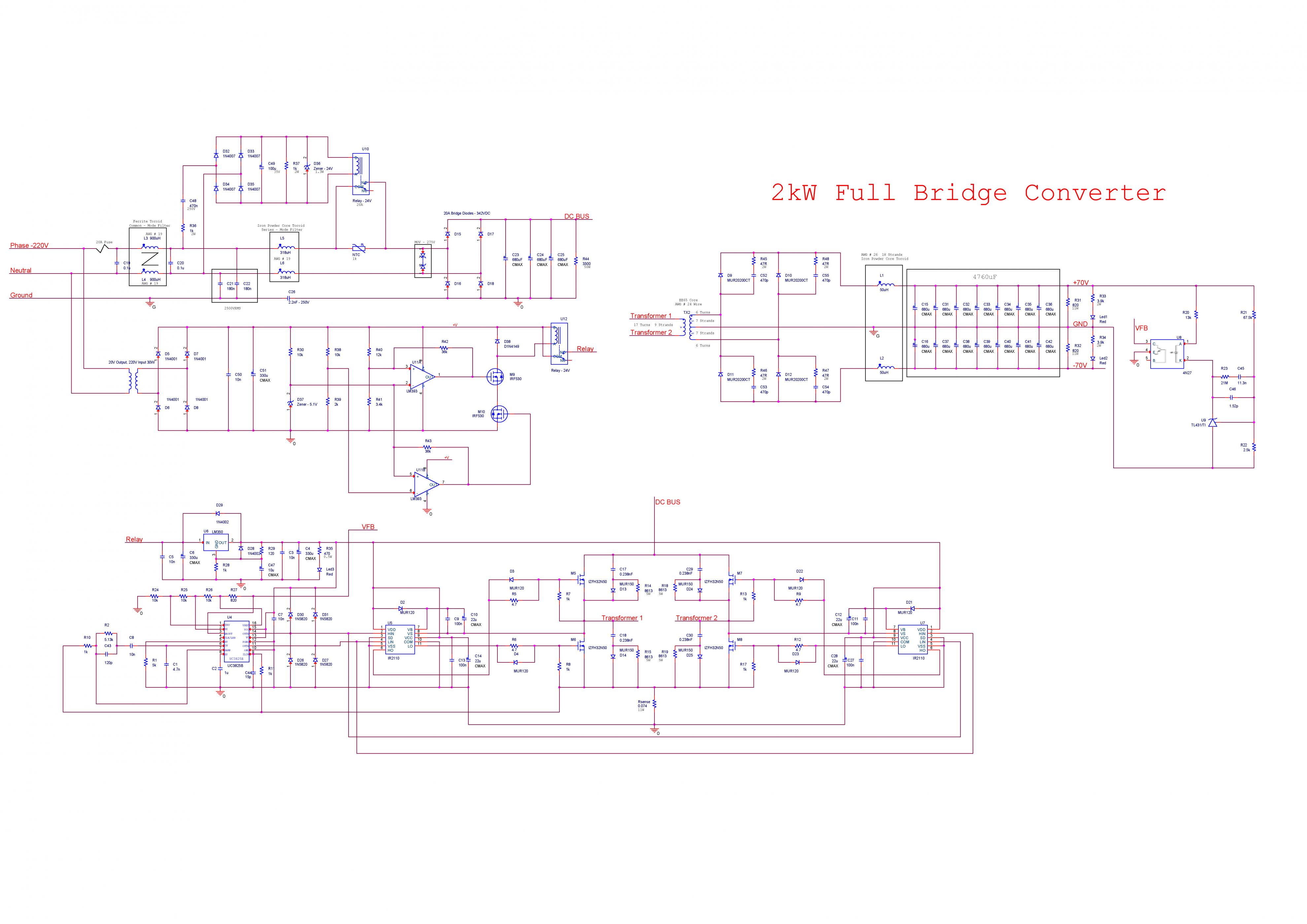

This is the final schematic for now.
