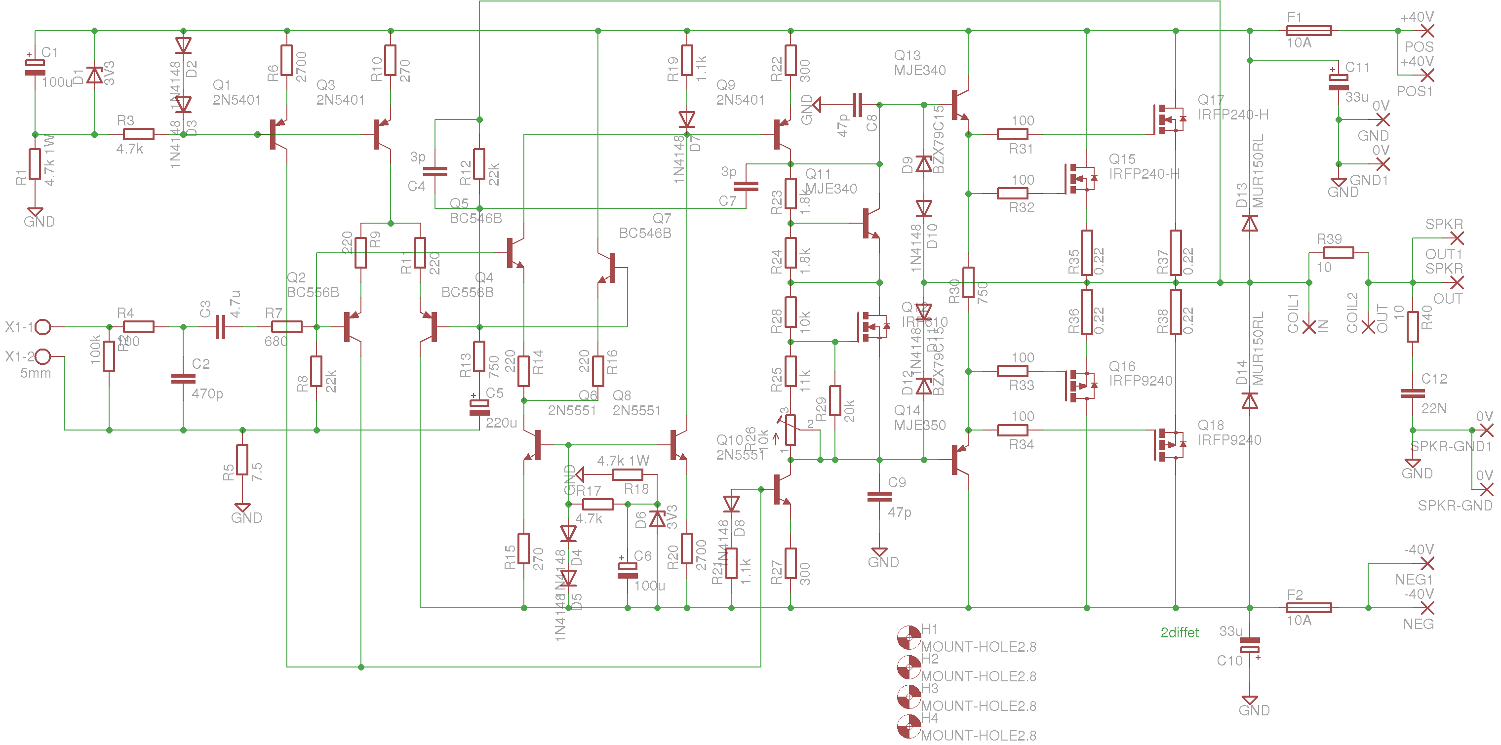

2DIFFET amplifier

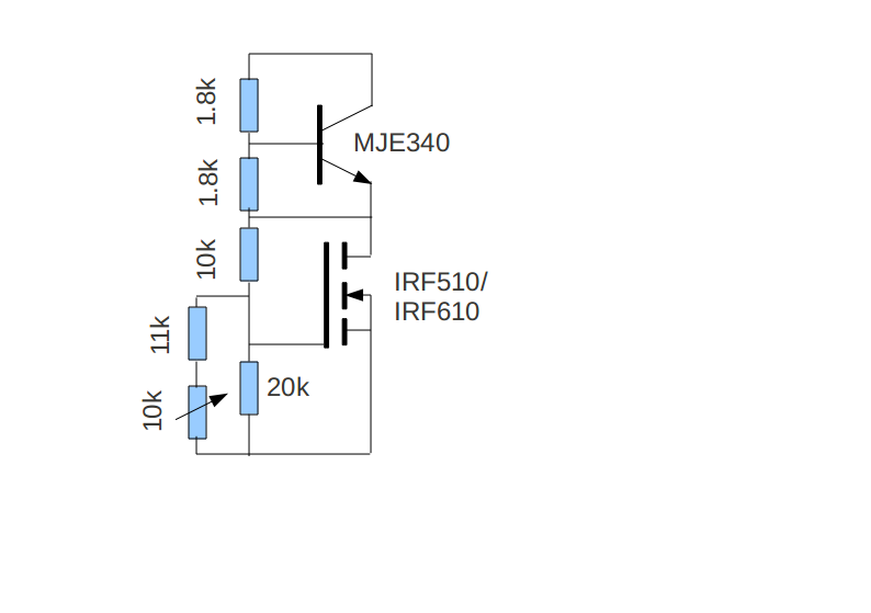

Possible bias tracking. The IRFP240 and IRFP9240 output devices also need to be matched for Vgs🙂

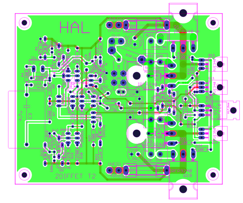

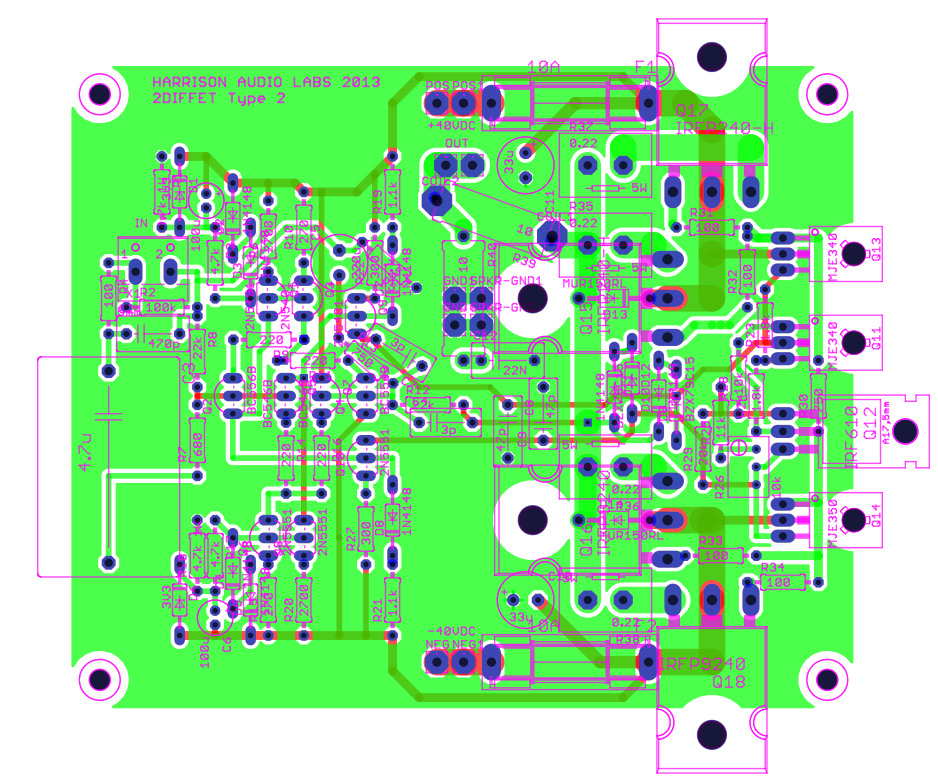

Lets have a little flavour 😎 , some mix and match ?

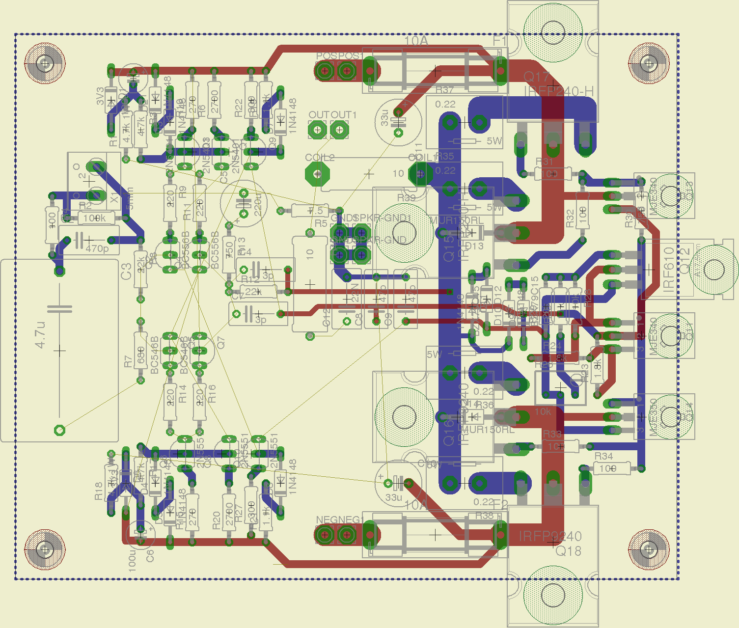

Hi Alex send me the layout files to info@harrisonaudiolabs.com
As the 100 PCBs will be serviced in batches of 20. Well the first batch can be one PCB and the next can be another 😉
kind regards,
Harrison.
Personaly I don't like the way you located the power fets.What's wrong with Alexmm his layout?
