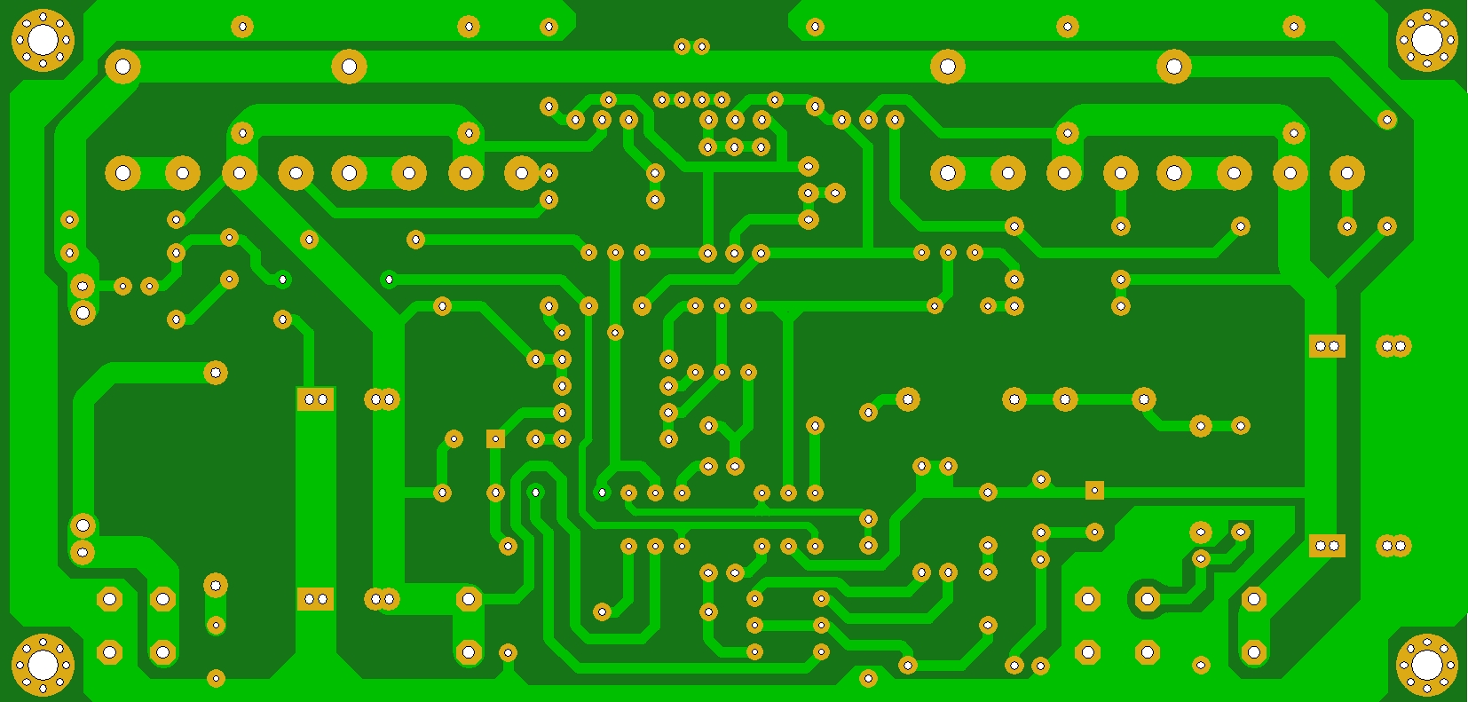

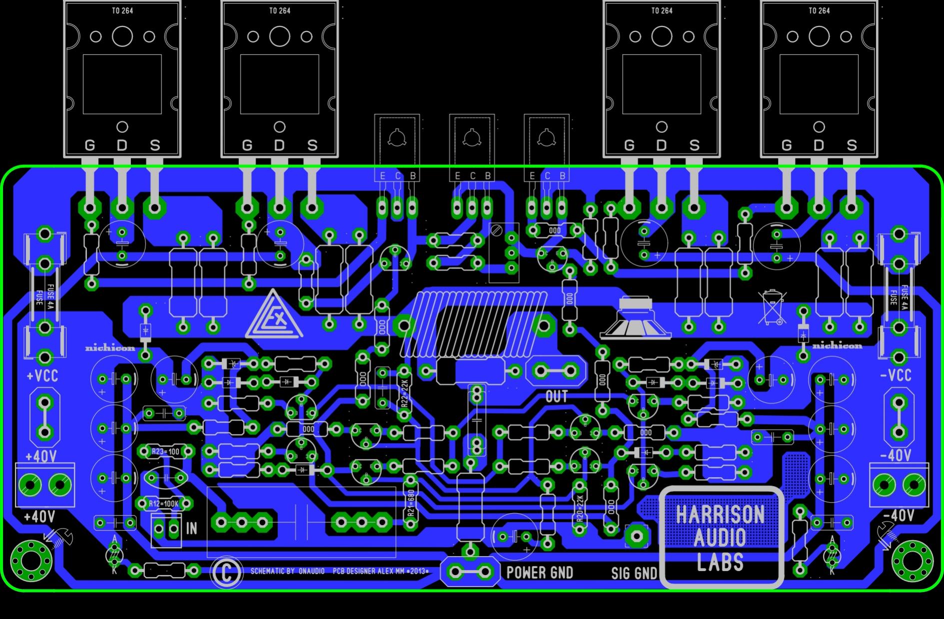

That is one very compact design 😉. Some tracks need a bit of widening to carry the supply and output current 😉. Thank you for joining the quest.:up: Kindly give me more time during weekend to have a look at it just took a peek.
Hi Holgi,
Looking good. Could it be that you have followed SYMEF PCB Type1development 😀. For 2DIFFET thermal runway should not be a problem. So only mosfets need to be on main heatsink. However if thermal/bias tracking is needed then the bias stage will have to be redesigned. Thank you for joining the quest.:up: Kindly give me more time during weekend to have a look at it just took a peek.

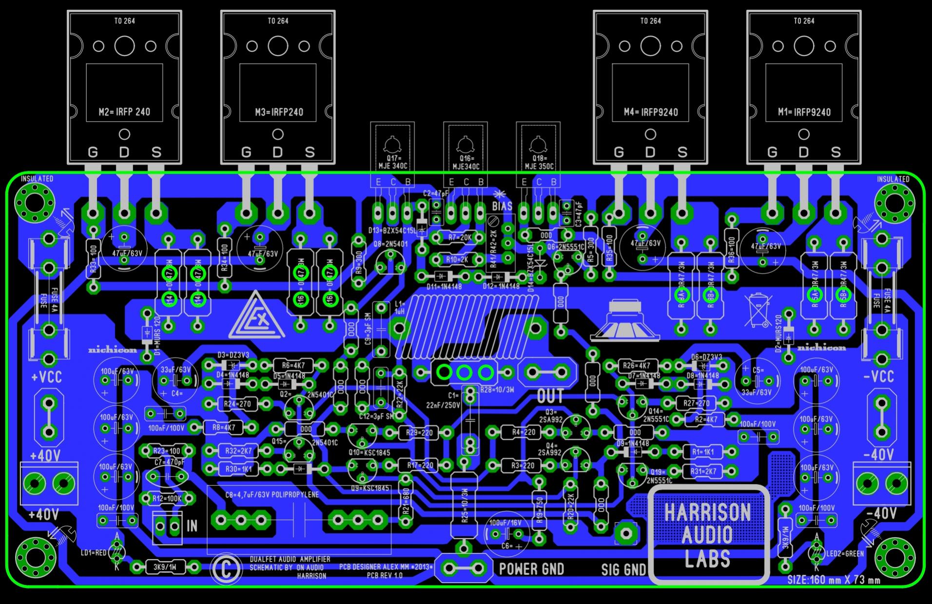

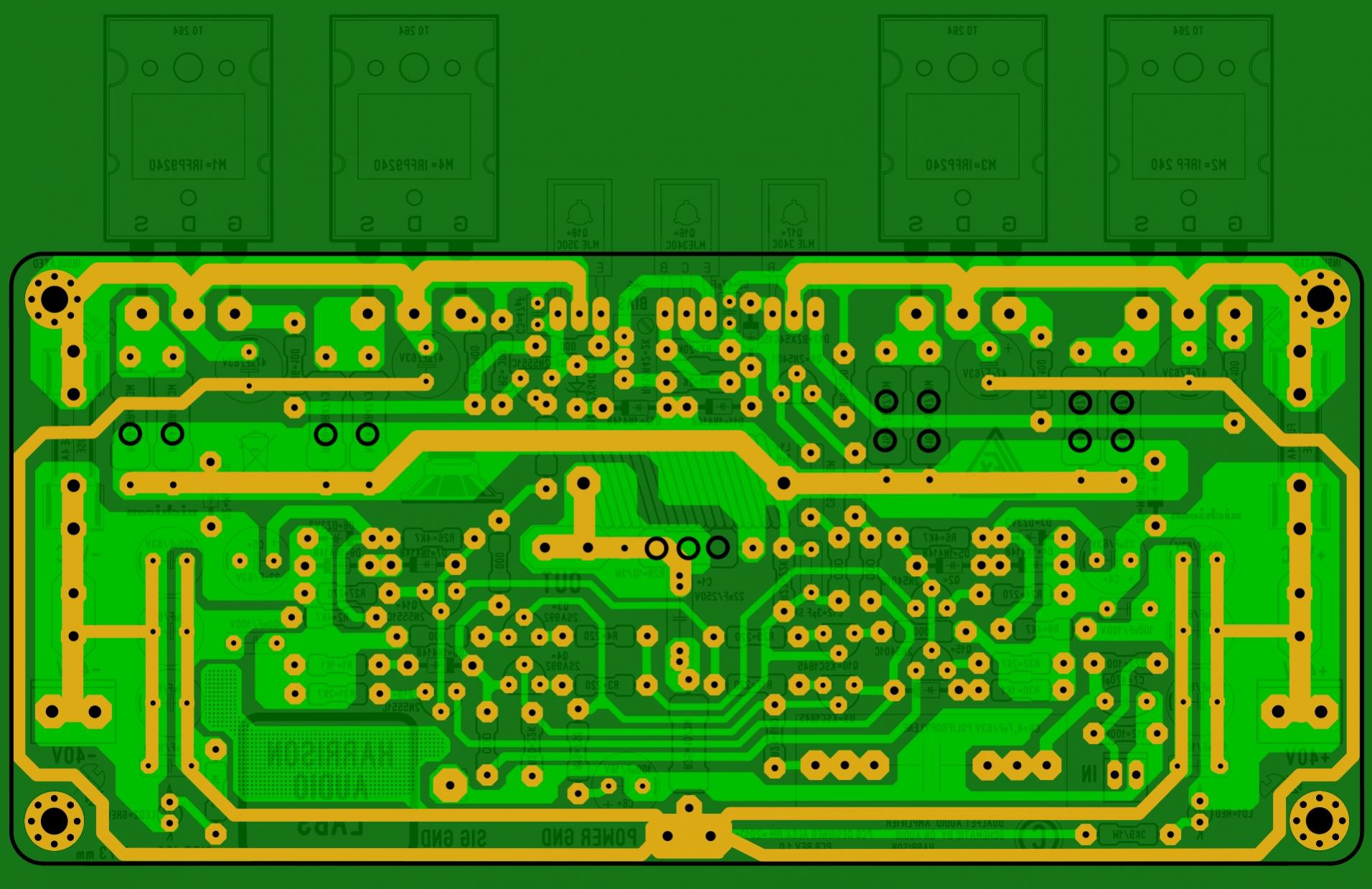

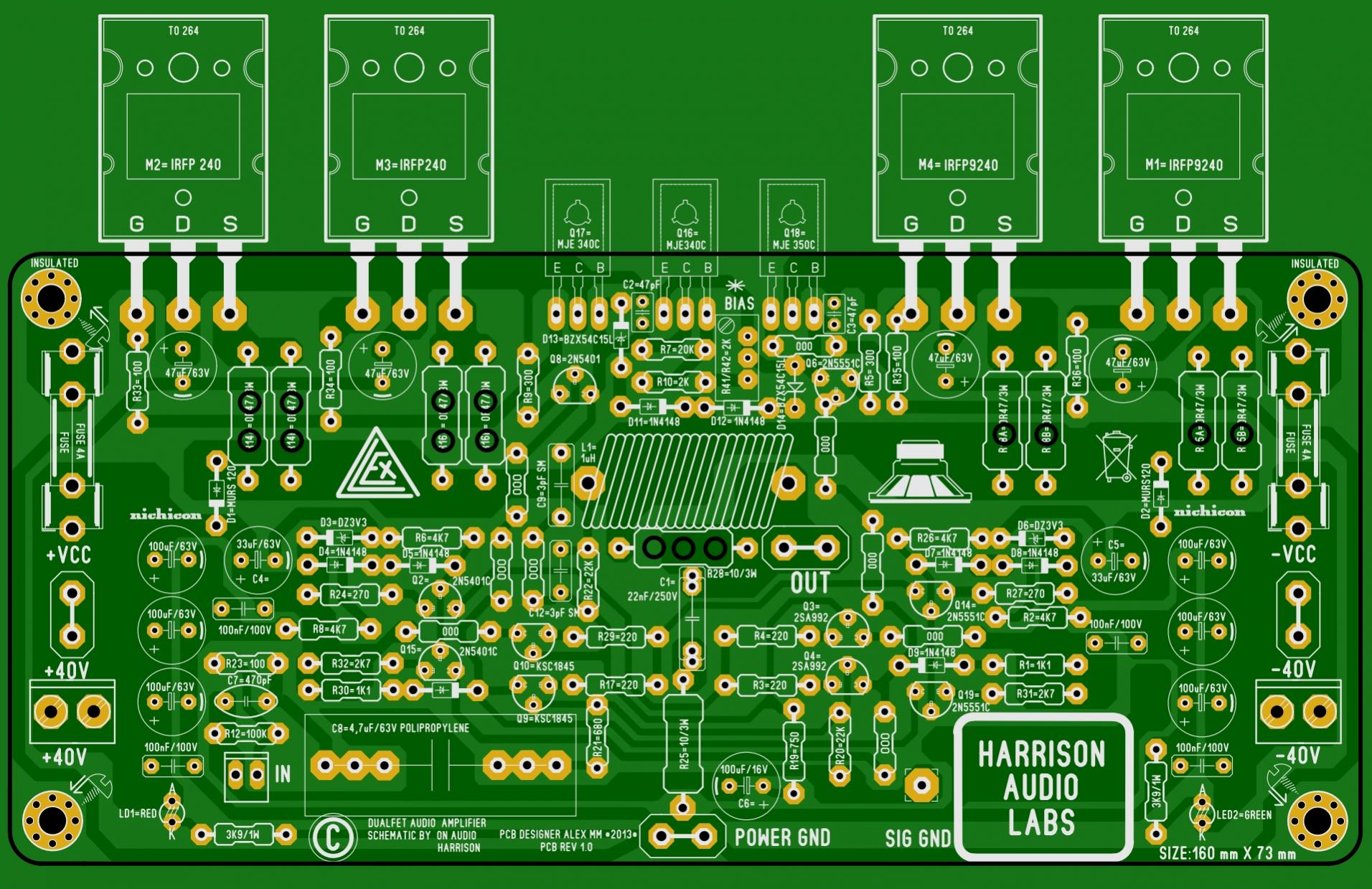

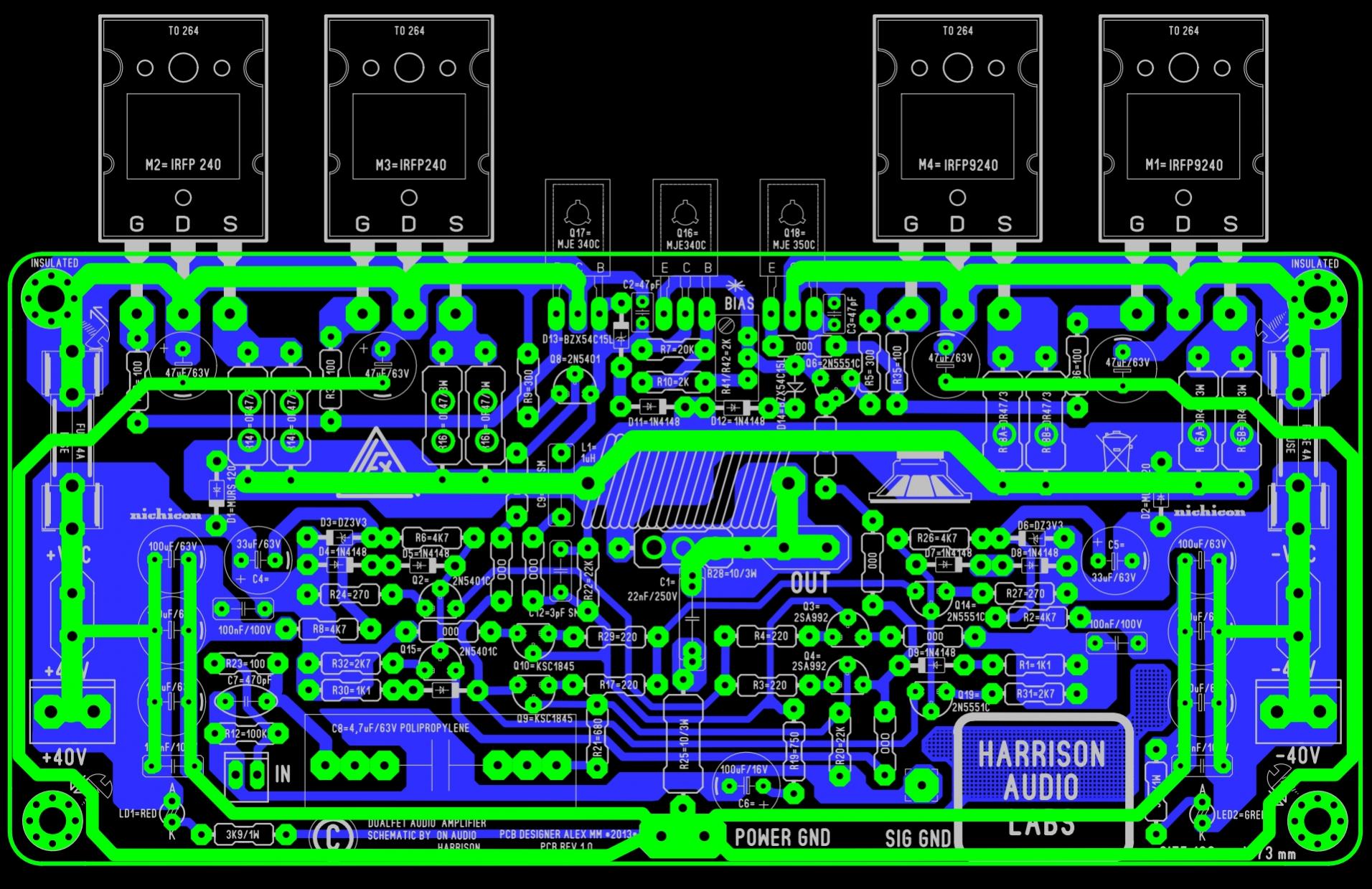

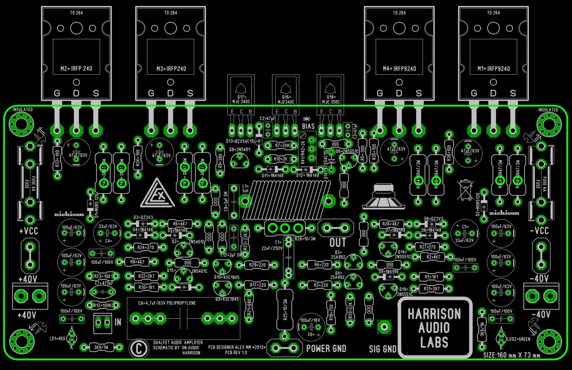

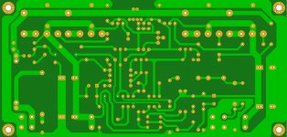

@Holgi , nice PCB have you layout 🙂 My not finished layout .......
Alex
Same compliments to you, Alex - very good layout, but different power supply strategy. I prefer reasonable onboard caps accompanied by litte 100n's directly at the collectors.
BTW: On first sight I thought you managed to create single layer layout without any wire-bridges, but then I saw and counted the 0R's 😀
BR,
Holgi

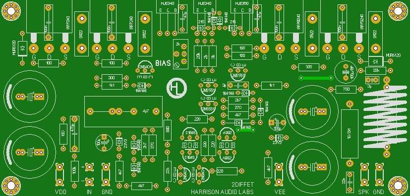

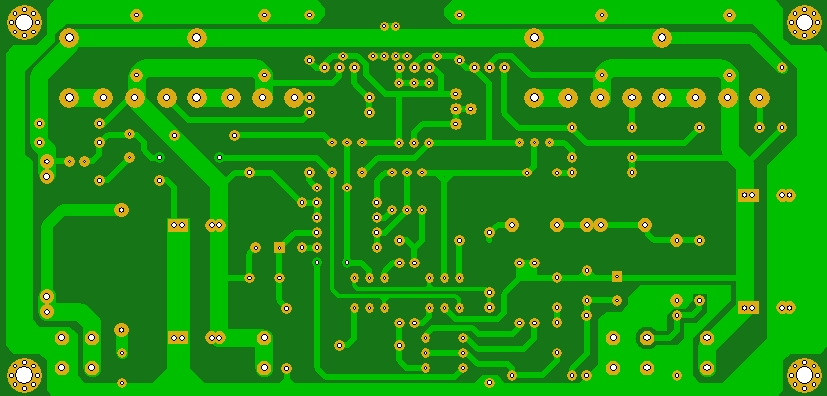

PCB rev 1.0
.......and PCB ready to be inspected by Q.C. .🙂 Comments are welcome ... 😉 :2c:.....
Regards ,Alex
