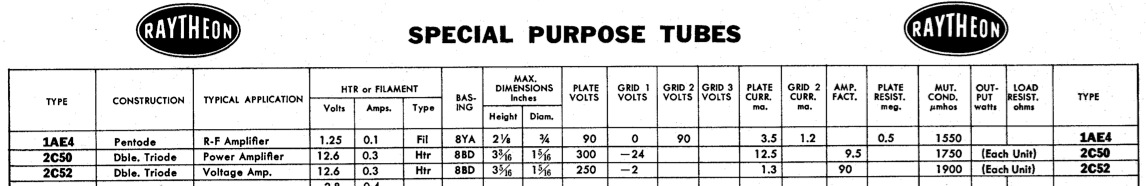

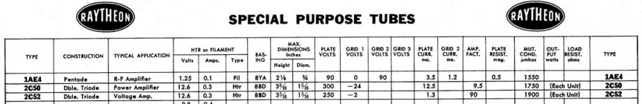

Thanks for the inputs, yes 2C52 is 8BD, same pinout as 6SL7/ECC35, 12SL7, etc. mu=90
It will be used in a diy project with two tubes connected in SRPP so if someone knows what is the filament-cathode limit..
Maybe 90V like a 12SL7 😕
