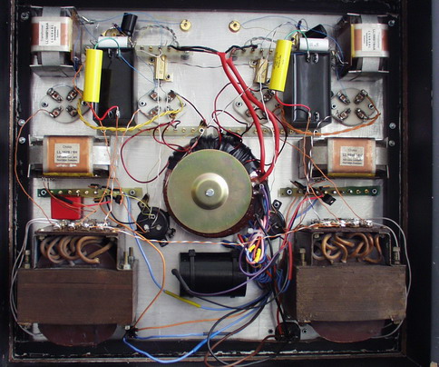

I have PP2a3 "Amity" amps driving my ME2 satellites crossed at 80Hz. They sound great, but with all lundahl iron they cost fortune too
Subs are driven by big A** Adcom Amp.
Only problem I had was faint hum and I solved it by adding hum nulling circuit from Lynn's "Karna" Amp. Basically I wound extra secondary on filament transformer giving me around 2.5V rms floating voltage and using it to compensate for hum. Now the amp is DEAD quiet. Moral of the story is that if you build PP amp with interstage transformer, add hum compensating circuitry.
