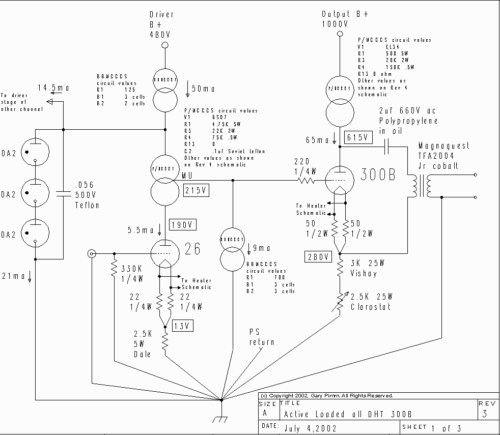

I'm not a tube fanatic, but I know that the original WE300B is very very special. A friend of mine once demonstrated real WE300B vs Japanese 300B, and there was a surprising difference. I guess 300B legend is based on the original WE tubes that surely have a magical quality.
By original I take it would mean the pre 1990s 300B? I am guessing very few people have heard those tubes 🙂
I am going to make another guess that the reason many prefer other tubes is in difficulty driving 300B. This thread is a good read. Of all 300B SET designs I've looked at Gary Pimm's is the one I'd like to hear the most.
Edit: added schematic
People here are upset with 2nd hd, but i tell you, a 5% has negligible shape distortion. I would concentrate on the odds hd. 3-5-7
Why this gets notoriously repeated? It´s like somebody years ago just made opinion from photos, and people keep saying it again. I doubt anybody compared bias points of these tubes, with other 2a3´sHi, Have question from a friend please.
if you use JJ2A3/40 at 2A3 operating points, should it sound as a 2A3 - even though it is actually a 300B with 2.5v filament

The level of intermodulation (IMD) products with 2A3 is lower than with 300Bs, but it is still enough to cause measurable and audible problems.
The trouble is that ac-heating modulates both V(grid-filament) AND V(anode - filament). A DHT amp with ac heating is usually set up by adjusting balance pot to achieve minimum hum. With the pot at its best position, the fundamental (50/60Hz) is minimized by locating a 'best fit' on the triode curves where the combination of the effective V(grid-filament) AND V(anode - filament) is symmetrical.
The mechanism that causes the hum at idle is the same one that causes filament-heating induced IMD. So the finding of the best-fit for curve symmetry usually reduces both hum and IMD.
The fly in the ointment for this approach is that the symmetry is only valid at idle - i.e. the static operating point. As soon as large signal swings are applied to the anode and grid voltage, the curve-shapes alter, and symmetry is lost.
The easy way to assess this effect is to try George's (Tubelab) test. Connect the amp to a PC soundcard and start up your favourite spectrum analyser. But instead of injecting continuous tones, connect a stringed instrument to the amp's input instead.
This way, you can see the levels of IMD while you play a single string. Often, the IMD is quite low for gentle playing, but suddenly rises above a certain input level - i.e. where the triode-curve symmetry breaks down more dramatically. And as you listen, you can hear the effect of the IMD quite clearly. It does not sound right, as you would expect for something that has no natural relationship with the music signal - and you can experiment further by swapping to dc, and see the IMD - and fuzzy sound - disappear. Using low-impedance filament heating causes different problems, but it suffices for examining the measurable effect of IMD, and the difference in sound without it.

If you run the 2A3 with a cheap OPT how can you conclude that the problem is the 2A3?
Anyway, IMHO 5K is not great for the "real" 2A3/6A3/6B4G/6C4C. If you look at some real curves (that are generally more linear than those in datasheets) you still get the typical 2A3 trademark: it is very linear up to a certain plate voltage and then it degrades quicker than other DHTs. This means that too high load impedance does not bring much benefit. For this reason I have opted for 3.5K and this is what I consider a max (nominal) primary load for good performance.
2.5K-3.5K is the range in other words.

.... and I'm quite disappointed with the sound. Very clear and transparent but it doesn't have the 300b magic in terms of timbre and tone on acoustic instruments and voices.
Andy - If you heat a 2A3 with AC, you will not get the results you are used to.
It's a difficulty seen quite often: many folks believe that the low voltage of the filament means low hum, and good sound. But 100/120Hz (and upward series) of intermodulation spurs will still show up in the output spectrum, even if the hum can be nulled out. You'll also hear the sound changing, if you use different types of AC-heat transformer - with none of them sounding quite right.
