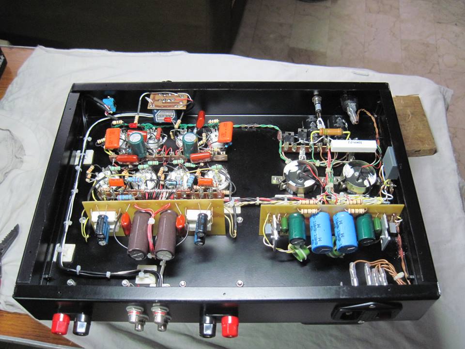

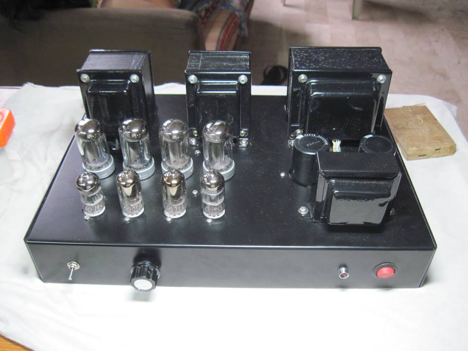

4P1L is still cheap, and easy to parallel...
yes, i did one a couple of years ago....owner was very happy, this one used dc heater supplies....all russian tubes...
dc heating used plain crc filters....
Yes - I ditched 300b, 2a3, 6C4C etc. for 4P1L outputs. Very pleased.

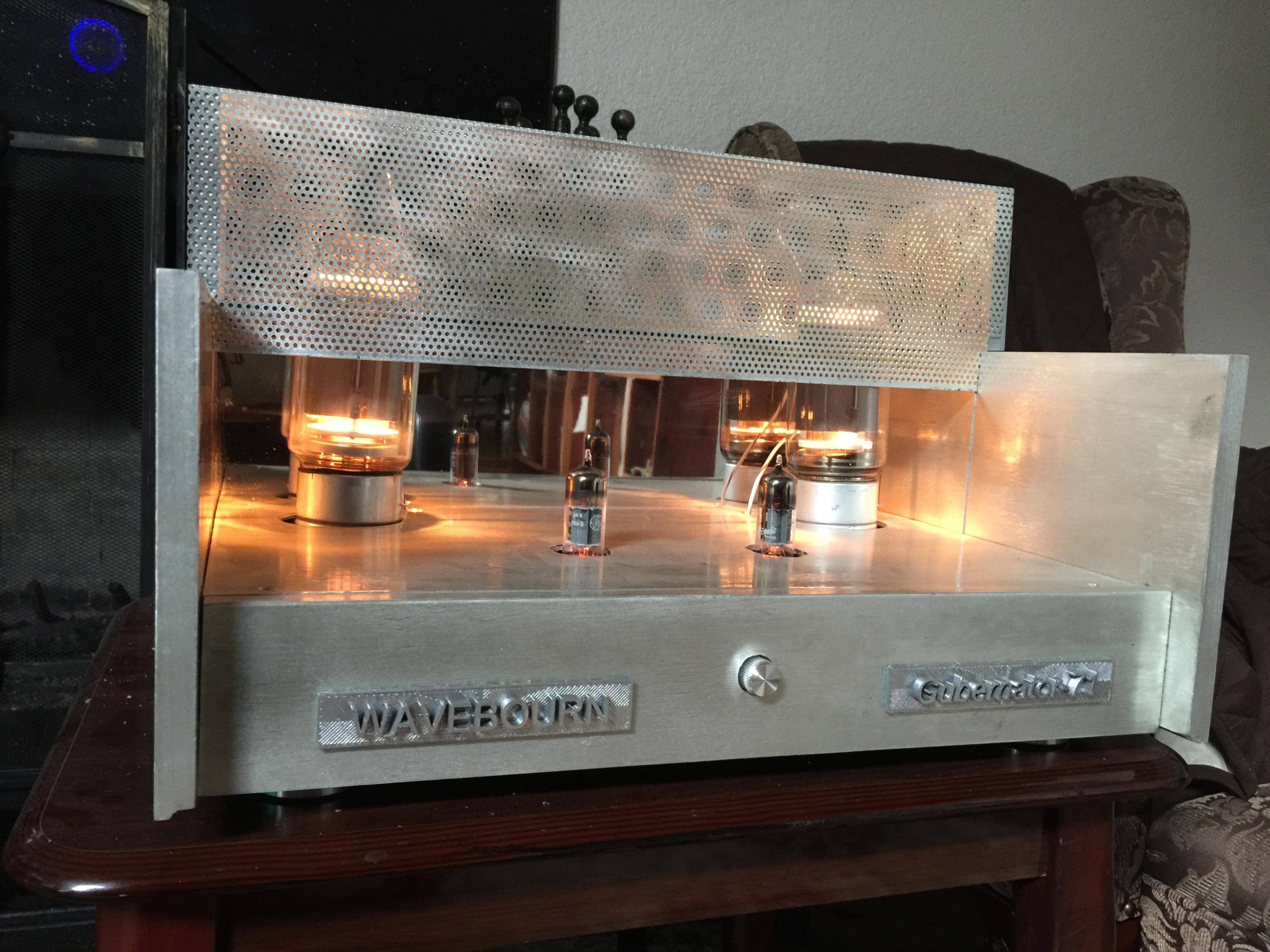

I'm curious about the GM70 and the 813 but never built with either. Really don't want to use high voltages. I'd be interested at 400v but in summer these tubes would be pretty hot....
I have a few 46 I could try out. No doubt in PSE. But not sure what the improvement would be over 4P1Ls. Maybe nothing.

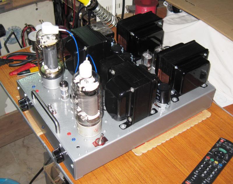

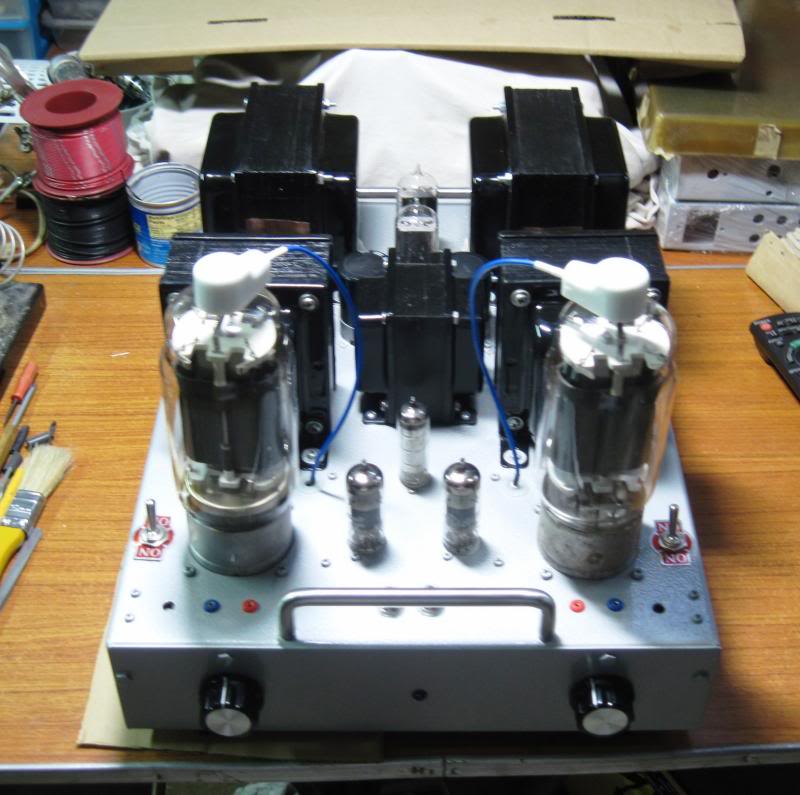

i have an 813 set built and ready, but the 1kv scares the hell out of me...
one day i will get enough courage to power it up....
When I fired up the Midlife Crisis 833C amps the first time I had a fire extinguisher next to me and I pushed the power button with a 3 foot long wooden stick. My heart rate was definitely accelerated!
Three years of reliable use later, it's like turning on the toaster to me. Works every time.
It's a waste if you don't power it up. Buy a robot that you can teach to do it for you!!😀
