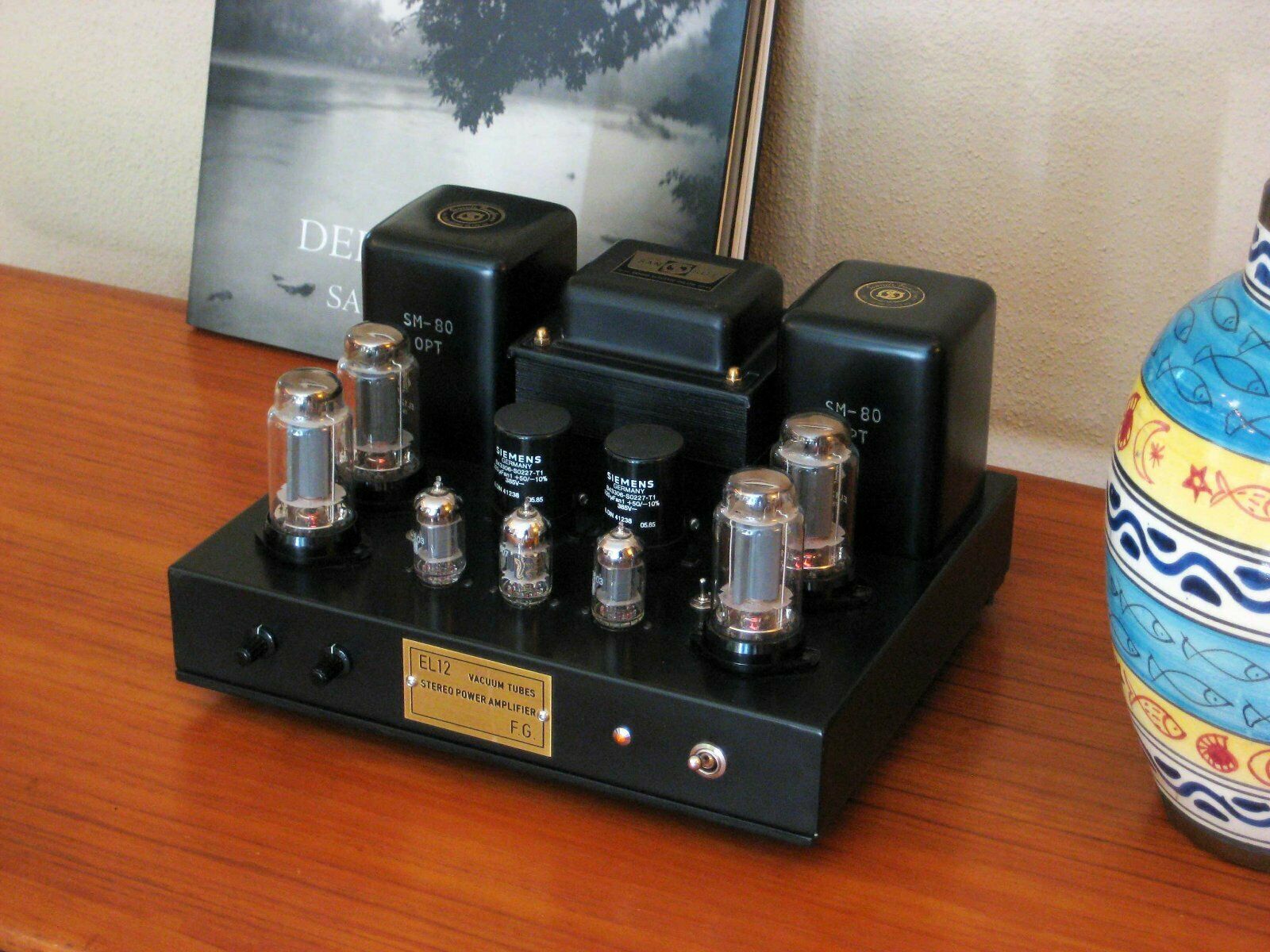

Interesting diversion into EL36 types. I don't have any EL36 but I do have some fat bottle EL38s which are very fine tubes and IMO the best of the 6L6/EL34 types. Top cap unfortunately which I don't like since you have to make it safe somehow for children with prying fingers and careless adults. But the sound is there. 25W dissipation, so much more power available. And another good one without the top cap is the EL12n, at 18W dissipation so also a bit more volume. EL38 is mu=15 in triode and EL12n is mu=18 which gives more choice for the input stage. A 6SN7 would be perfectly fine, even a DHT with mu=8 ohms.
This is a timely reminded that for a bit more power I can use a good DHT input and an EL12n. I have a few and I know they sound good, not quite as good as a EL38 fat bottle but not far behind.
