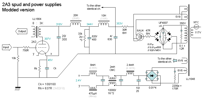

I managed to re-arrange the filtering caps of the filament supply and get a proper voltage. I got 6.2V on the 1st 10000uF cap and 5.7V on the 2nd (after a 2.4mH choke) - good for a low drop out Vreg to work, so I did it.
The CCS setup is very simple, just a 3-leg Vreg (LD1085). Final goal is 2.5V on the filament, plus 1.25V reference voltage, it leaves 1.95V for dropout, well above rated 1.5Vmax (@5A).
I use a measured-good 0.5 Ohm fixed resistor for the 1.25Vref sensing to get exact 2.5A current flow. However this give me 2.6V on the filament. So it seems the hot resistance of filament is not at precise 1 Ohm (1.04 instead). Or maybe my 0.5 Ohm and the Vref of the chip are not that precise, too. (Gee! these small numbers.... )
Later I added some more resistors (some 0.1R in parallel) to turn down the voltage. Now it's perfectly set at 2.5V. Meantime, I got an observation of the B+ vs Ia. I found higher filament voltage yeilds more Ia. In the process of tuning, the filament voltage changed in very small amount, while the Ia reflects the filament supply power very sensitively. The voltage (power) on the filament directly reflects its emission, thus the current flow.
This also got me thinking that I fiddled the operation points around was probably not a good thing. Emission is also a key point that I ignored and should not be changed widely. This factor sets the 'proper' proportion of the other 2. Who (the xxxx) am I to challenge RCA manual? So, I tuned it back to approach the text book numbers.
The 2nd observation is the noise, or how it's been attenuated. It's DEAD QUIET by this simple CCS. In previous CLCLCL filter, I had to attach the test driver to my ear to hear the very little hum. Now I get NO sound at all!

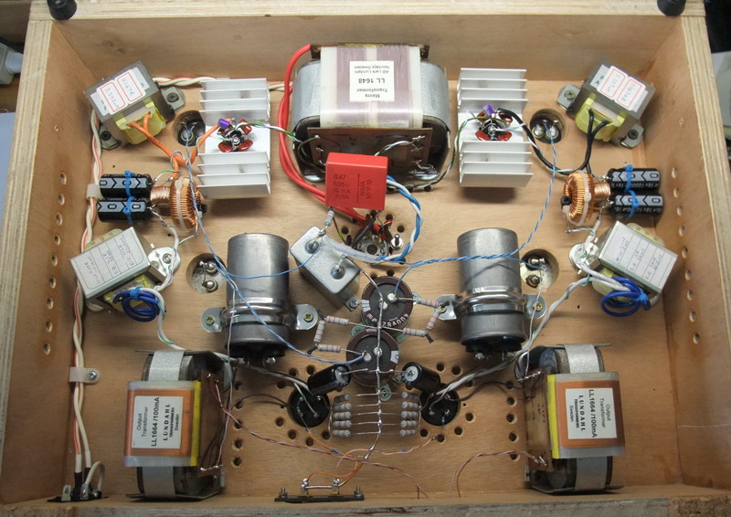

4th, they are hot! The aforementioned aluminum board and heatsink for transformer / bridge diode are as hot as before. The newly added CCS (on it's own heatsink) is at similar temperature. (on which I can only keep touching for a couple of sec.) 🙁
I didn't make the heatsinks of CCS stand out of the chassis, they're fixed inside. I just drilled some holes above it for convection. After using for a whole afternoon, they are quite hot (working perfectly with great sound, though). So I tuned the voltage again to make the drop out slightly lower to 1.65V. By calculation, it only dissipates several W each, why so hot? Strange....

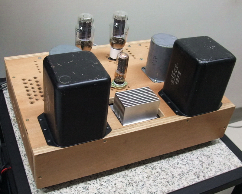

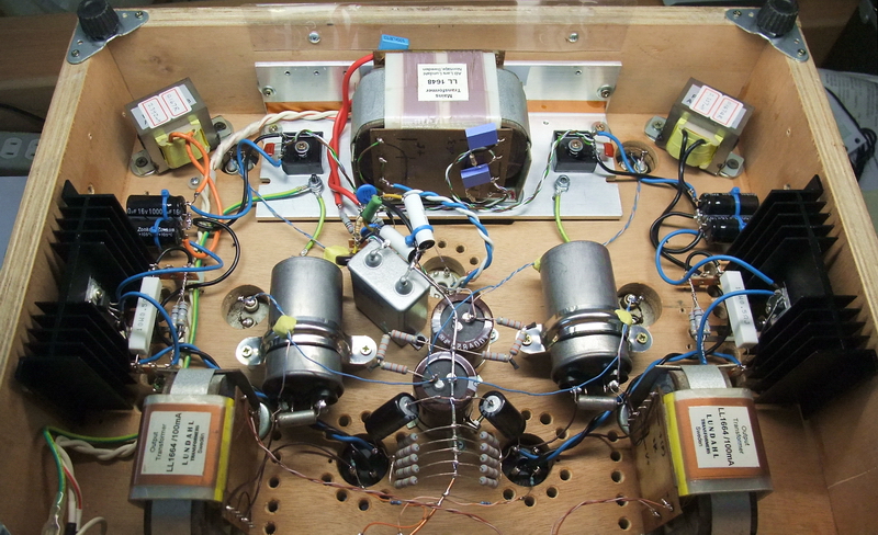

pics
Internal view with the CCS and drilled top plate of the chassis.

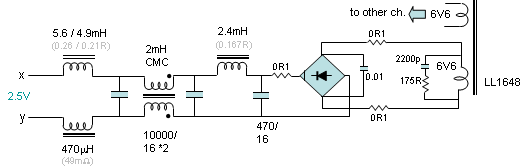

3rd discovery is, sound quality wise, I can't tell the difference between CCS (by Vreg) and choke filter. I really can't. They are equally good. I don't hear what others said. Bad hearing? I don't know. 😱
A side note for this:
The previous filter is CLCLCL --
470uF - 2.4mH - 10000uF - 2mH CMC - 10000uF - 5mH
(in fact there's another small choke at the return leg of the last C)
So there was no cap in the end. Filament saw chokes, not cap. I guess this helped somewhat.
Any comments on the hot power transformer and bridge rectifiers? 🙁
This very transformer was used in my previous 6H30 project. With a lot less current on HT and LT secondaries, it was also quite warm then. It could be touched continually, but very warm. Now it seems reasonable hotter with much more current draw. No?
The power transformer in my pre amp is also a Lundahl, same VA capacity with different voltages. It serves 4* 417A/5842 @ 16~18mA each and 2 * 1.2A for rectifier tubes, is also quite warm to touch. So maybe it's normal?
Can't compare directly, a reference though -- the power transformer in my 300B amp is also hot. The largely perforated metal top cover above it is very hot to touch, let alone the trafo itself. It's not built by me (I did some mods only). It's a commercial available product.
Another example I remember is JC Verdier 300B I had borrowed from a friend and used for a while. It's hot all over! Small chassis and 3 large (potted) transformers are all very hot to touch. Ouch!
Am I overreacting? Any inputs?

Good to know I'm not alone. Here is how I use it:
1. sec. #1 (350V): capacitor (4uF) input rectifier, DC output is 120mA
2. sec. #2&3 (5.9V): parallel and feed the heater of rectifier tube, 1.8A
3. sec. #4&5 (6.6V): capacitor (10000uF) input rectifier and current regulated at 2.5A each.
So it's 350x0.12 + 5.9x1.8 + 6.6x2.5.2 = 42 + 10.6 + 33 = 85.6 (VA) in total.
Ah~ sure this is not the real consumption. Many factors are not taken into consideration - losses here and there.... And this trafo is rated 250VA.
