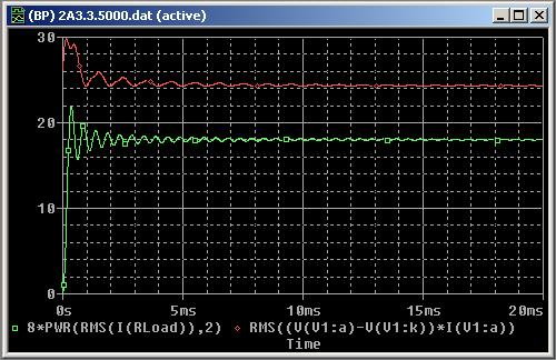

James, I already knew those curves, and, using them, I have "built", using SPICE, my PP amplifier. My problem is that I don't know the maximum plate voltage, current, power and so on ...
Everyone says that they are quite a 300B, but I cannot find anywhere anything supporting this statement.
Thanks again
FWIW JC says that the Sovtek 2A3 cathode is just a 2A3 cathode - so running at 300B currents is not a good idea. Overvoltage is a different issue. Sovtek seem very reluctant to recommend any kind of abuse which is probably understandable. I have run mine at 27-28W over extended periods of time (years) with no ill effects.
Load Lines
So, my question is: a Sovtek 2A3 "living" on these Load Lines, will die ?
It should not.
RCA 1937 says 300V maximum "Design Center". This includes allowance for utility power and other variation. In the 1950s, RCA re-rated tubes as "Design Maximum", which must not be exceeded. The "Maximum" ratings were usually 10%-20% higher than the "Center" ratings. So your 325V "should" be OK, but don't go much higher.
Your dissipation curves are low on average, but cross the original 15 Watt rating. We rarely did this in the old days. However, speech/music should not be a problem this way. The time spent around 200V 100mA 20 Watts is too short to cook the plate. And analog_sa says much higher average dissipation is possible on the Sovtek 2A3s.
But consider this. Dropping plate voltage to 300V gives a very safe operating point, with only about 1dB less power. Will you notice 1dB less power?

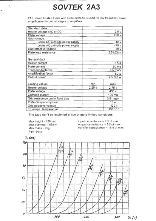

It is however insulting that New Sensor Co. puts NOWHERE some official data about the Sovtek tubes.
You can't reject them for not meeting 'spec if there is no 'spec! 😀
This "datasheet" has been lurking in my hard drive for quite some time (probably from somewhere on the internet, though I forget where). No idea how official it is. It shows Va max as 450V (more than NOS 2A3s) but Pa max is still listed as 15W.
