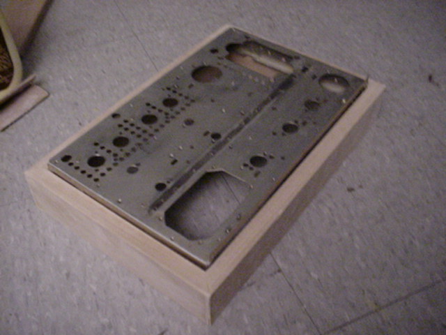

that old trio amp you have has nice power.and sound i have a trio
just a different model. i lost a tube a month ago so im rebuilding
it:D
will look better when the plate is flush with the wood;)
