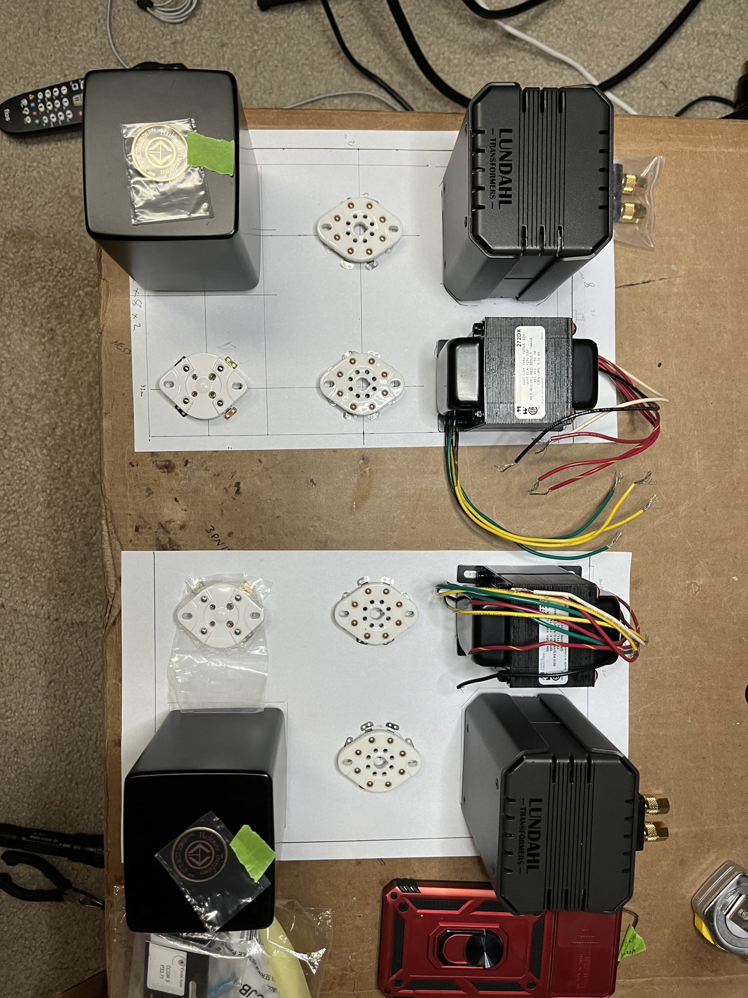

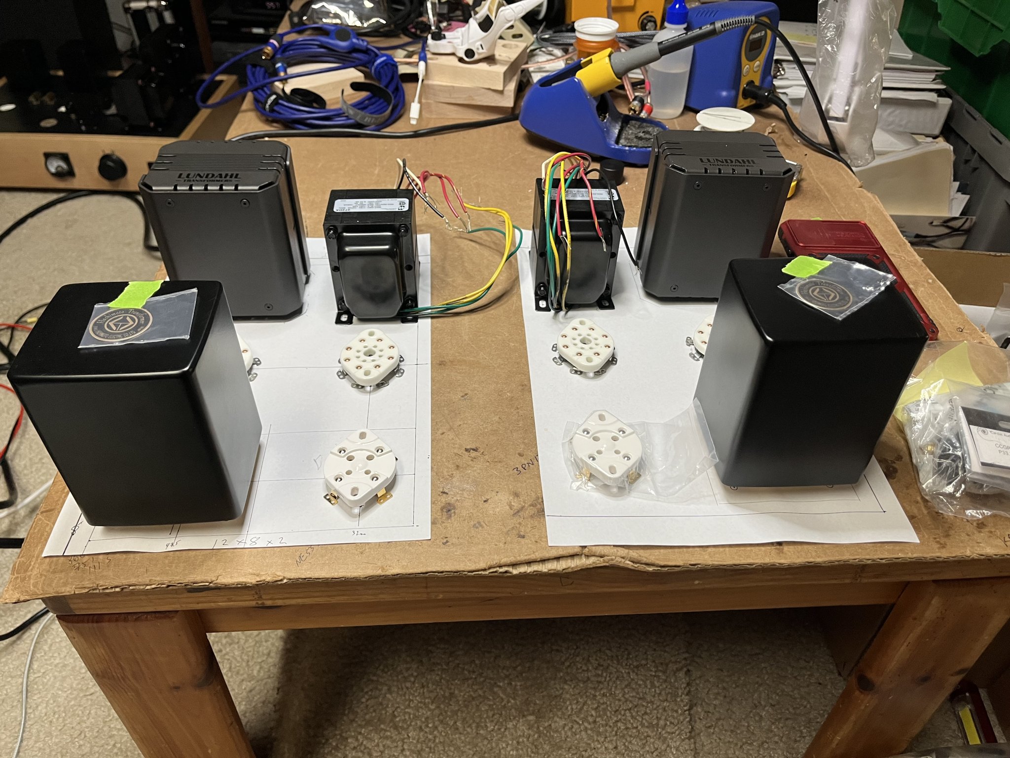

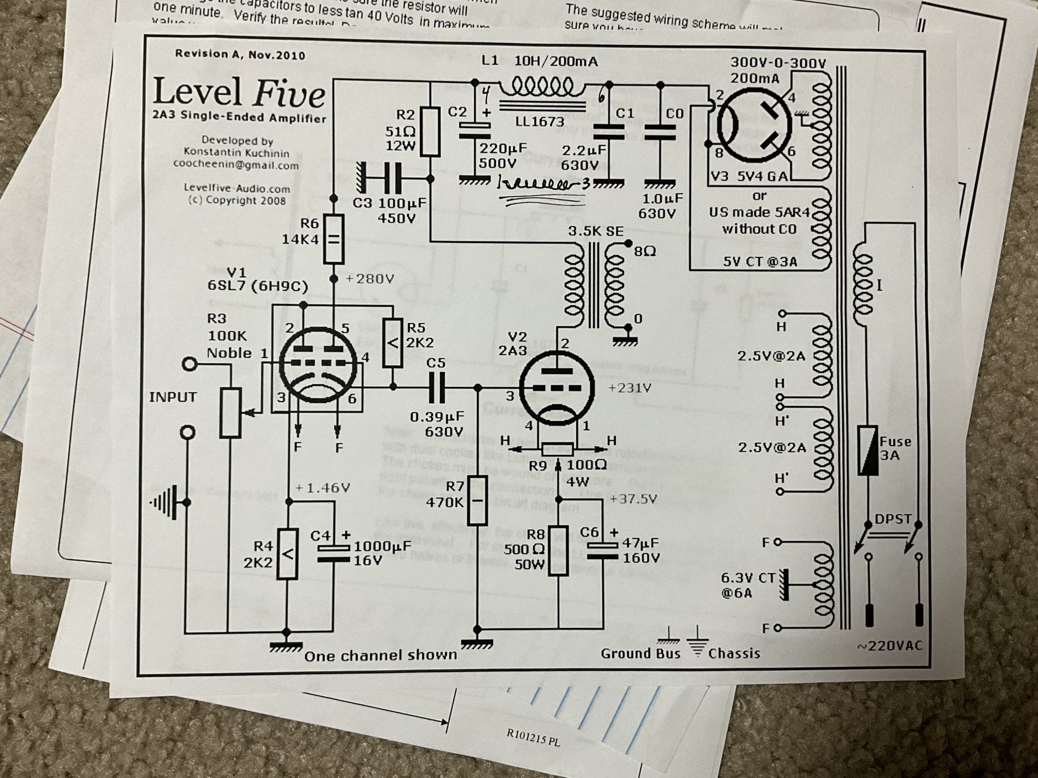

Laid this out for 12x8x2. GZ34 top left, PT to right, Lundahl 1673 choke, 6SL7 center right, 2A3 bottom left, Hashimoto H-20-7U to right.
2” height should be enough room for internal components. I’m not using those polish paper-wrapped capacitors, so the electrolytics are under 35mm diameter.
I figure input in the back, shielded into 1st stage, RCA jack to front SIDE - this will be for RIGHT channel, left channel will be mirror image.
From experiences with other amps (Tektron 2A3/50IS/300b and a homebuilt 300b, it doesn’t get THAT warm inside to worry about, but I’ll leave some space around the sockets for air flow.
Any suggestions about placement, spacing? Go with a 16x8 or 17x10?
Thanks in advance.
Norm

Hi Norm..

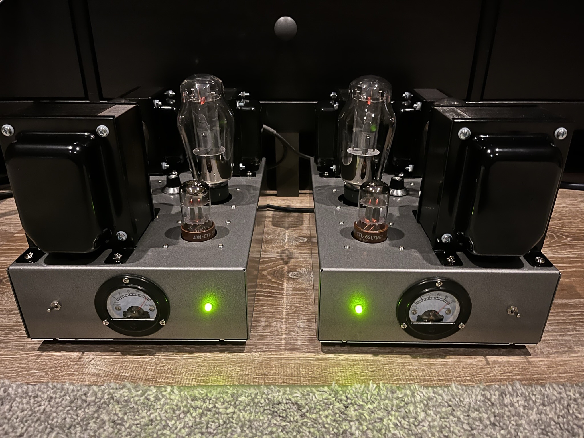

I was just in the same boat last year when I built these 2A3 direct-coupled monos based on the physically larger JJ 2A3-40. They are on 12" x 8" x 3" steel chassis, which have been working well and stay relatively cool, given the power tubes are cathode biased at 90ma. I initially started with 2" deep/tall chassis, but discovered that it was too little space.
Best of luck with your build. I will be following along.

You do nice work. I can see why you wanted the extra depth with the Solen caps and lowering the sockets on platorms for air flow. How do they sound?
Thanks for your kind words.
It s the building I enjoy almost as much as the music which eventually flows through them. I've been a fan of the 40W JJs for a while and wanted to try a direct-coupled iteration. The sound, even with the Hammond outputs, is sublime. The frequency response on the low end is as good as I could expect (down 1dB at 25Hz) but the top end drops off to nearly 3db at 20Hz. Square waves look almost too good to be true. Despite the measurements, I am astounded with the musicality and way they breath new life into my collection. On to the next project...

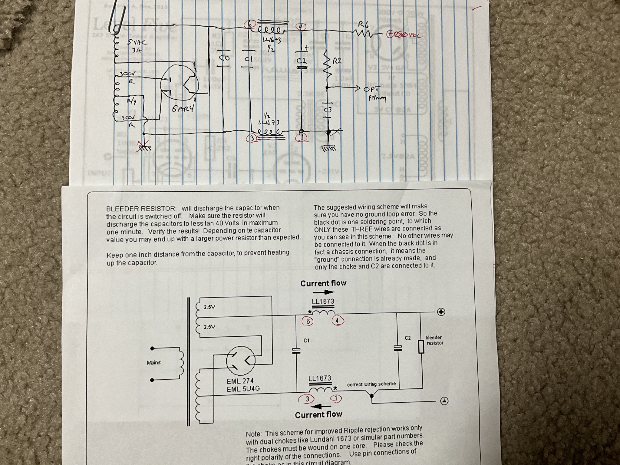

For the 2A3, I decided, after reading through I don’t know HOW many web pages, threads and several books and tube/valve experts’ writings like Morgan Jones, EJ Jurich, Aiken, Merlin Blencowe and all the commentary, opinion and blather online (you know what they say about opinions and experts), I decided to go with http://www.levelfive-audio.com/circuit.htm for design.
I’ve got pretty much all the components except the economically impossible to find ELNA Cerrafine capacitors for the power section - oh, they’re around, at around $500 EACH, used. I‘m going with AN caps instead, for now. Decided on using the Lundahl choke like so:
After redrawing Mr. Kuchinin’s schematic so I could read it left to right (ha-ha):

Speaking of which, I think the 12x8x3 is the way to go… I have no plans for installing a cooling fan. 😉

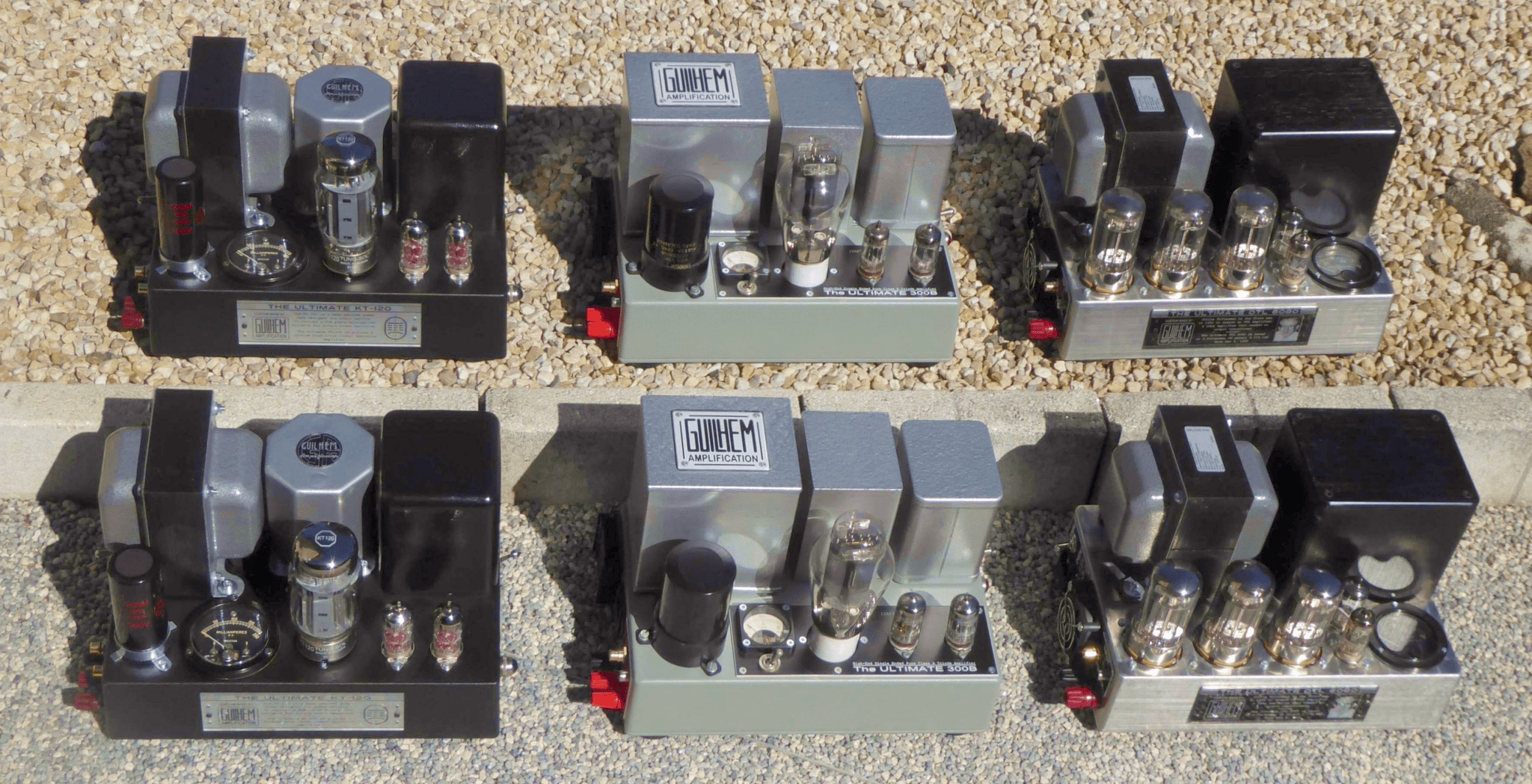

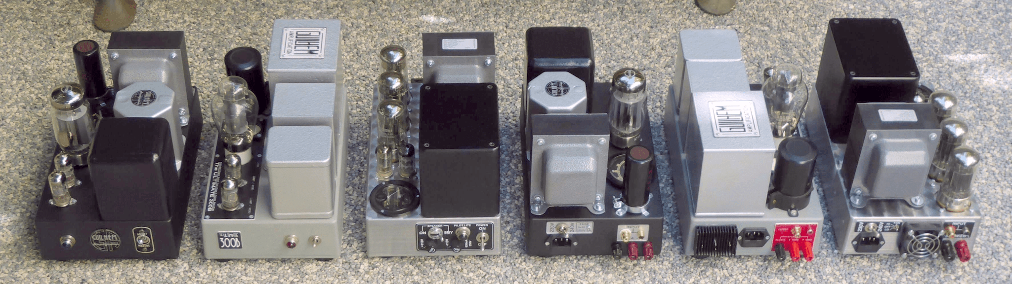

Yes, I built my amps as compact as possible - these above are "large amplifiers", these below are "small amplifiers" :
Note that among my "large amplifiers", only one model is fitted wit a fan : the U-OTL6080, in order to cool by chimney effect the 6080WA with a light and silent air flow, provided by a reduced speed fan...
T
I like compact. If I had it to do all over again I think I could make the two-channel amp about 80% its current size and an inch shorter, but it’s not a bad first effort.
Space heaters needn’t be so big. 🤣
Sure ! Just about my U-OTL6080, the temperature at the top of the bulb of the 6080WA reaches and stabilizes at 190°C after 5 minutes of operation, with the cooling fan at low speed :
