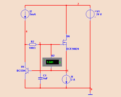

First thing I will run a VGS vs. Current test.
My sim setup in attachment.

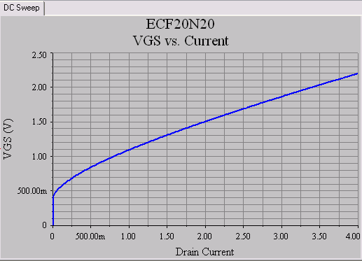

Here are the results of my VGS vs. Drain Current.
I use MultiSim DC Sweep.
At 3.75 A vgs is 2.1 Volt
At 2.00 A vgs is 1.5 Volt
At 0.25 A vgs is 0.7 Volt
So for output current 2.0 A +- 1.75 A
we get VGS
1.5V +0.6V and -0.8V

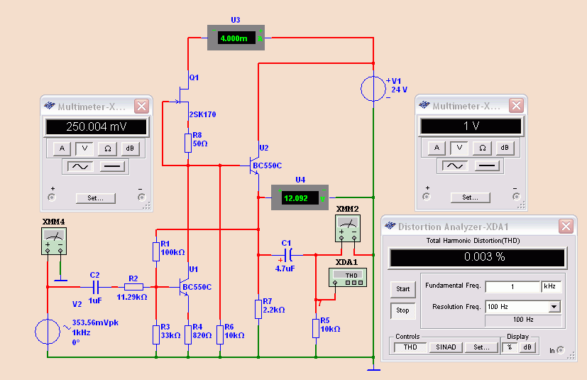

I will need one Inverted preamp.
This will match the inverted power amplifier.
And I will add some voltage gain to this preamp, x4.
This way I can reduce the voltage gain to maybe 50%
in the Lateral power amp.
Resulting in lower distortion overall.
Here is my 3 Transistor preamp with very low distortion for being such a basic circuit.
Also in this amp I use feedback back to BASE.
