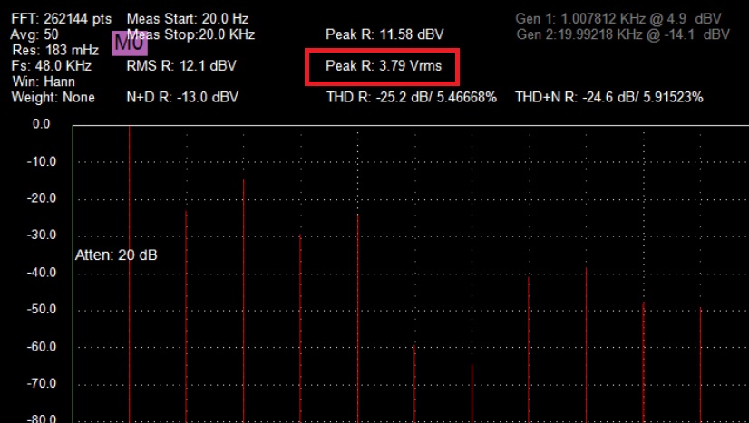

Here is an LT1364 putting 12.9v p-p into 100 ohms
Here is the same after applying EC
You appear to drop 0.25V RMS from the output in the second chart. That would be enough to drop the distortions to those levels without any "EC system".
Clipping distortions have a very abrupt threshold, in particular for an opamp stage, I'll let you figure out why. Redo the experiment with the output levels exactly matched.
Unfortunately I've been trying for a long time to turn this into a sellable product so I want to sell a few before I post a schematic.hellokotty123: I may have overlooked it already having been addressed somewhere in this thread, but can you provide or point us to some schematic or paper on the operating details of the EC circuit you are employing? Thanks.
You're right, that's only because I averaged them for different lengths of time though. The Vrms changes per tick of averaging until it levels out. The voltage was definitely the same. The current conditions I'm putting the LT1364 under are waay outside of spec. It's supposed to be able to handle 50ma into 150 ohms, I'm driving it with over 100ma into 100 ohms. The voltage discrepancy does not change the result, the opamp distorts wildly way before this point. Even if I bring the output down to 4.3vp-p which is as low as the oscillator will go at this gain, the distortion is still relatively high as shown here.You appear to drop 0.25V RMS from the output in the second chart. That would be enough to drop the distortions to those levels without any "EC system".
Here is the new result with shown matching vrms as you requested. I even let the oscillator settle in for 5min between tests to be sure. Pre EC
Post EC
Again, the post EC result is below the capability of the analyzer to display. The harmonics you see are those of the analyzer itself.
Pre EC
Post EC
Something stinks like BS here. LT1364 can't have that high distortions at 3.79V RMS output, unless the output current limiting kicks in, or you feed the opamp at something like +/-5V or less.
In both cases, these are distortions that no EC circuit/method are going to fix, since they are outside the negative feedback loop effect. How would an EC circuit linearize the current limiting circuitry? With or without EC, the current limiting will still kick in at 50mA.

It's 4.3v p-p not RMS but other than that I don't know I just reduced the oscillator output to its lowest level and re-measured the distortion. I'm feeding the LT1364 +/- 8.8v and using it in inverting mode with a 1k and 10k resistor, no bypass caps before or after EC, which may actually be a reason why its a little worse than expected now that I think about it. There's quite a bit of resistance between the power source and the power pins.Something stinks like BS here. LT1364 can't have that high distortions at 4.3V RMS output, unless the output current limiting kicks in, or you feed the opamp at something like +/-5V or less.
In any case it's sort of irrelevant because the 4.3vp-p result was examplatory as a standalone test. Even if the setup is somehow compromised causing it to have a higher distortion than normal it still doesn't take away from the result of the EC as it is relative.

I'm reading off of the scope, not the analyzer. 4.3vp-p was the output voltage of the amplifier. Considering that the oscillator has a minimum output of around 400mv that lines up.Really? 😀 You'd better find out 😀.
