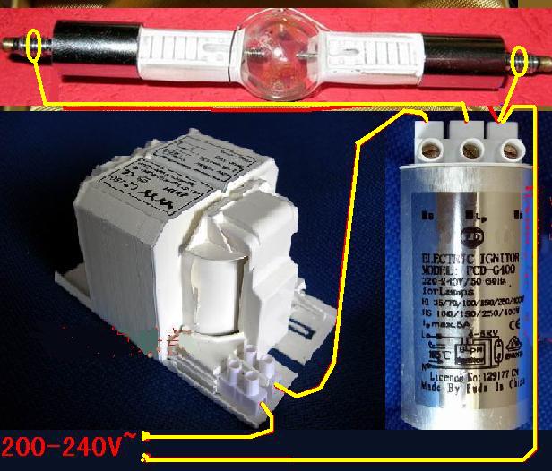

40 USD only,
270w short are lamp + infocus e-ballast + holder =100 USD .
and some thing .......
40 USD only,

270w short are lamp
Colour 7000k
Life 1500hrs
Bulb Diameter 21mm
Luminous flux 22000
Colour rendering index > 90
precondensor Diameter 70mm
focal length 95mm
Colour 7000k
Life 1500hrs
Bulb Diameter 21mm
Luminous flux 22000
focal length 95mm
400w short are lamp
Colour 7000k
Life 1000hrs
Bulb Diameter 25mm
Luminous flux 35000
Colour 7000k
Life 1000hrs
Bulb Diameter 25mm
Luminous flux 35000
