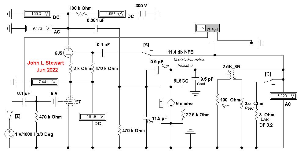

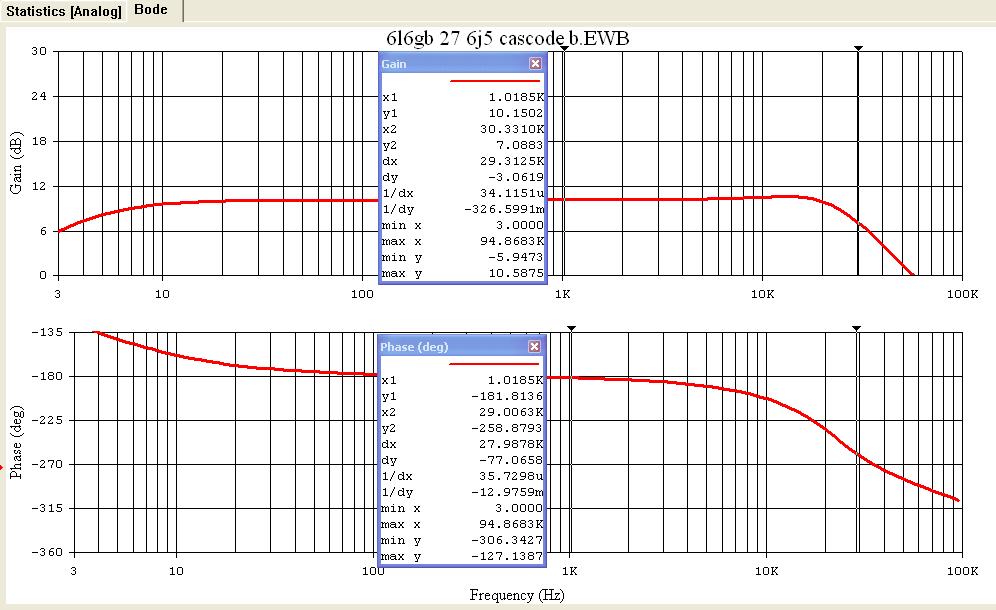

27 In Cascode Front End
Several years ago I noticed quite a few 26, 27 & 30 enthusiasts trying to use them for their supposed tonal qualities. But the best power triodes all seemed to have MU’s of ~5. There is a fundamental problem; the overall gain is too low. The way out was a third gain stage.
I wondered if anyone had tried a Cascode front end to get the required gain, a search didn’t find much. As a first pass last year I tried simulating a Cascode with a 30 on the bottom & a common medium Mu triode on top. The Cascode triodes do not have to be the same. Just need to be able to handle the plate current.
More recently I tried using a 6J5 on top of a 27 in FlaCharlies 6N6G amp. The results looked OK so in the last few days that has been modified to drive a 6L6GC in triode or pentode mode. And a bit further, it turns out the top 6J5 triode grid can be used as a NFB point. The switches in the simulations allow the calculation of NFB, Internal Resistance, DF & Sensitivity.
The resulting amp has ~11 db NFB & DF of 3.2. And with a Volt RMS at the input 6W of audio results. Refer to simulation A. I was concerned the NFB might have a loading effect on the 27 but it turns out the load is actually relieved, refer to simulations B & C. With NFB connected the signal at the plate of the 27 doubles. And its gain is ~7.5.

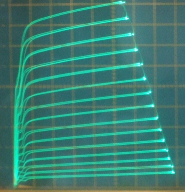

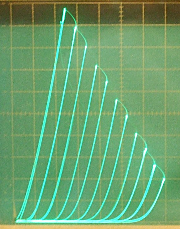

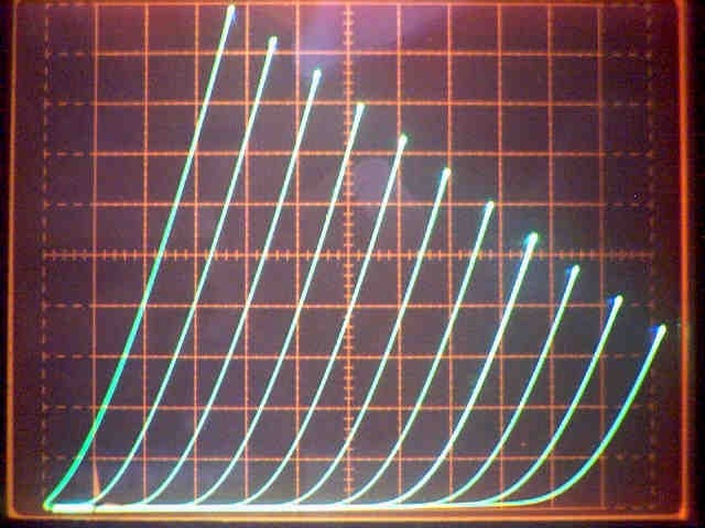

A DHP like 1E7G (in triode mode) on the bottom should give you remarkable triode curves. 1E7G in triode mode Pic below:
Another way would be to use a high quality (internal triode) pentode like 12HL7 (curve tracer selected) or the 1E7G in pentode with the N Fdbk to the screen grid (instead of the cascode arrangement). 12HL7 triode mode curves, 2nd pic below:
4P1L is another high quality and cheap DHP pentode with great triode curves, 3rd pic:
4th pic is 4P1L in pentode with +15V on grid 3 to square up the knees:

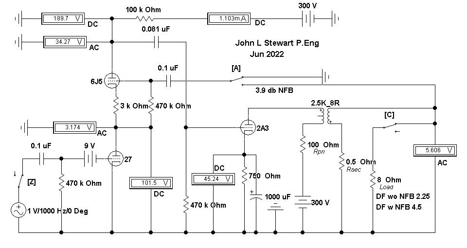

Here is the cascode driving a 2A3. One Volt RMS on the input grid drives the 2A3 to full output.
Not perfect but yet another solution of many. 🙂

I need some explanation. At 1 mA bias current (somewhat low as operating point for either 27 or 6J5), cascode's output impedance is very high. Wouldn't it cause high frequency roll off due to 2A3 Miller capacitance?
The impedance at the 6J5 plate is the Rl of 100K.
More current would help. These simulations are exploratory, looking at what might be possible. 🙂
The DHT tube would always be on the bottom, so the Htr. power problem is minimized. No top tube even needed with the pentode/screen Fdbk version.
The cascode is a way of avoiding driving the screen impedance of a common sharp cutoff pentode,
In earlier work I found that to be about 30K, something most people don't plan on.

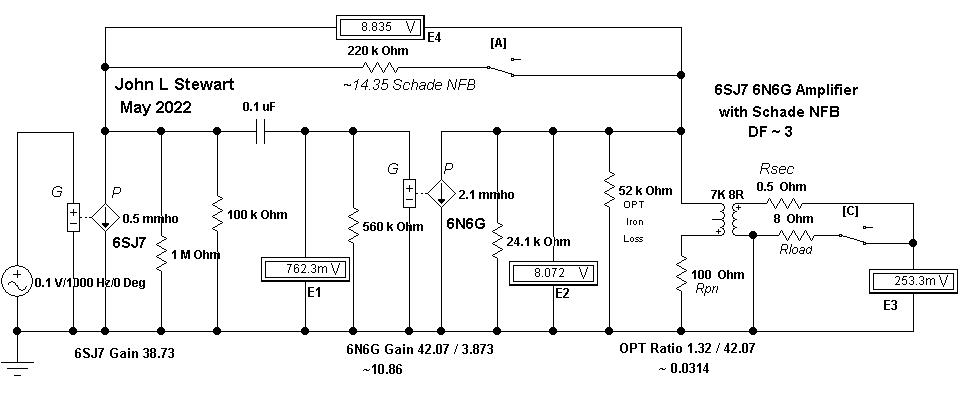

The 6SJ7/6N6G I suggested to FlaCharlie in May to solve the Gain problem is attached.
As you have pointed out One Ma won't be enough to properly drive a 2A3. In today's sims the capacitive parasitics
of the tubes are included. The sims with the 2A3 were dropping off in the middle of the audio band. The cascode current
was increased but it was almost impossible to put something together that satisfied all the requirements.

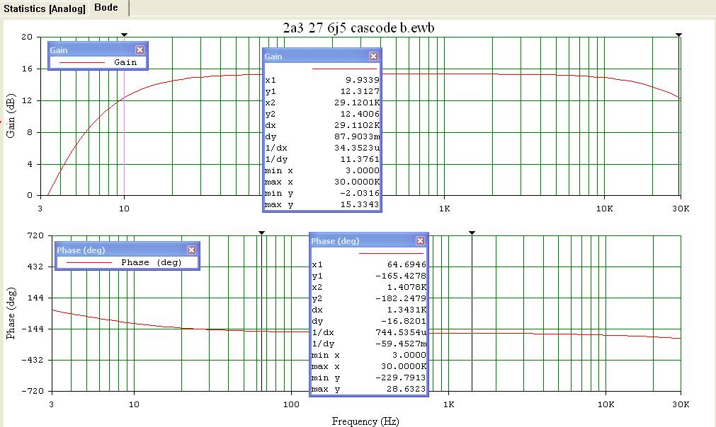

The sim where a 6L6GC is in the output performed much better, Without NFB the response is relatively flat out beyond 30 KHz.
With the NFB switched in there is a peak of ~5 db at 30 KHz, That could be fixed with an RC network across the cascode plate R.
The 6L6GC vers needs NFB, otherwise the DF is too low.
Simulations make design easy compared to what we did with pencil, paper & sliderule.
And there is no smoke or red plating. 😀 👍

Charlie, you should not take my analysis of your 6N6G amp as a criticism. The 6N6G needs only 15V on the grid for full audio output. The 26 with a gain of ~7.5 results in an amplifier that needs only a 2V input to drive to full power. The fact that you are happy with the result is the bottom line, as it should be with anyone’s amp.
While you are trying Schade NFB you will notice your amp will need more drive from whatever source you are using. For every db of NFB the input signal will have to be increased by a db. You may hear some difference in the resulting sound. And you may not.
The 6N6G has a pentode like set of plate curves. As it is for any common pentode, that results in poor damping of the speaker. When pentodes were first introduced in the early 30s, people thought they could hear a difference. That was soon attributed to the poor DF of pentodes. Quite a few observers soon called the differences triode sound vs pentode sound. The debate still goes on today.
NFB was soon used to improve DF. That brings with it other problems such as stability of the amplifier with NFB. The math to solve that was all worked out by the late 30s.
Many experimenters like to improve the DF of their amplifier. But in general that requires an increase in gain somewhere within the amp. Many use a triode to do that. But with Schade NFB the resulting increase in the plate load of the driver leads to distortion in the triode. A way out is to use a common sharp cutoff pentode such as a 6SJ7.
Schade NFB doesn’t take into account the OPT winding resistances. NFB from the OPT secondary to the driver cathode will fix that. Schade NFB also makes the amp more sensitive to PS disturbance & hum. NFB from the OPT secondary reduces PS hum.

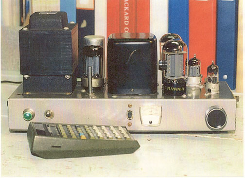

In what has become some kind of series here on DIY I’ve tried to shew the various paths an experimenter might use to get to where they want to be with their amp. Not just something nice to look at but that actually performs to the limit. Design the amp as a whole, not in pieces.

John, I didn't take it as a criticism of the amp. I was simply pointing out that I didn't feel that I had a "gain problem" and that I had no complaints.
As I've mentioned, I took your advice and connected the plate of the 6N6G's input section (a triode which is internally configured as a cathode follower) to the plate of the tube's output section (which is also a triode). Doing so did tighten up the bass a bit and, although it did reduce the output level, I don't consider it to be a problem.
Since this is exactly the effect I would expect from the addition of NFB, I assume that's what's happening. Correct?
And, since this connection does not involve the output transformer - it's plate to plate between the sections of the 6N6G with no resistor - wouldn't this be considered to be a form of Schade? Or would the connection need to go back to the 26 input tube to be considered Schade?
I did install a switch so that I could also run the plate of the input section off B+, as is normally done with this tube. That would give me more power if I was using inefficient speakers and felt that I needed it. So far I haven't felt the need. Even when it's run that way, the bass is quite solid, but I do prefer it with the plates connected.

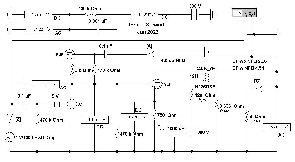

For these tests the OPT model has been corrected. For the OPT I've used the specs of a Hammond 125DSE.
That has resulted in a much better frequency response for the sim.
With no NFB full output from the 2A3 requires less than a volt at the input. Freq Response is 3 db down at 10 Hz & 30 KHz.
A few db of NFB doubles the DF.

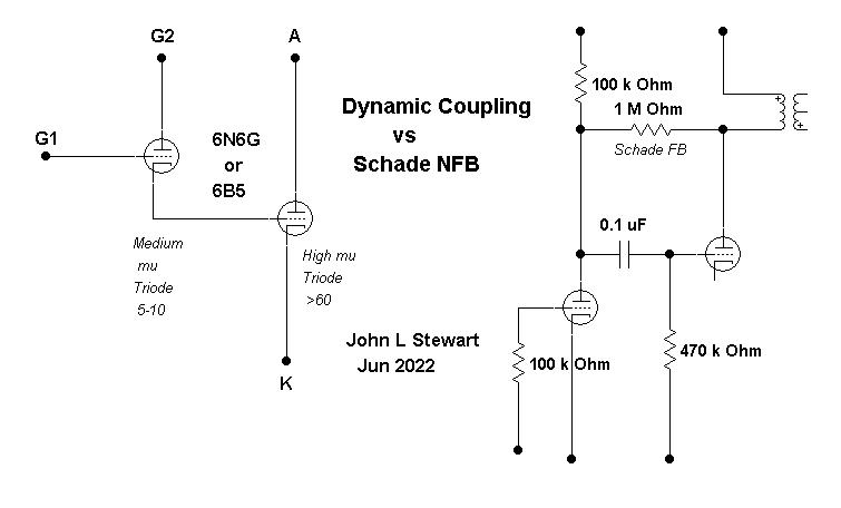

OK Charlie, the detailed data sheet covering the 6B5 you had posted on DIY a while back is very helpful. The plate family of the composite tube is included. From that it is easily seen that the loadline follows a path where the output section of the tube is always forward biased. That is completely opposite to what we normally see in audio design & appears to offer an advantage. When properly driven & loaded the tube will never clip on positive going waveforms. OTOH there might be a problem at the other end of the loadline on large signals.
While running the tests of ~20 years ago I found the composite tube to assume the mu of the driving triode when the input plate was connected to the output plate. At the time I didn’t go further with my look at this kind of tube, there were as always other things that needed attention. My income work depended on a lot of travel.
The attachment shews as best as I can the difference between the connexion of the plate as compared to Schade NFB that you had wondered about. At this late date I’m kinda wishing I’d bought a couple of those tubes for a closer look. 🙂

Thanks John, so does the direct (no resistor) connection between the plates of the 6N6G sections add negative feedback? Or would you characterize it in some other way?
Sonically, it emulates what I would expect from the addition of NFB.
It certainly is a unique tube. I'm afraid I only have a limited grasp of the technical details which are described in great detail in the original Triad 6B5 data sheet.
It is NFB in the sense that the composite tube becomes a triode of mu equal to its input triode.
When mu goes down plate resistance also goes down & DF improves a lot.
