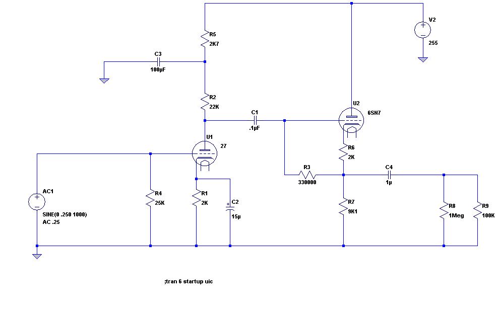

I am going to build a "simple" preamp 27 gain and some Octal follower.
What are peoples opinions on direct coupling vs. capacitor coupling?
I would like to use DC on the heaters and that pretty much means I need very low heater cathode differential on the follower.
I have heard many opinions that the 27 "likes" rather high plate voltage (180-250), this brings in the need for a cap coupling to lower the cathode voltage on 6SN7 follower.
Assuming I use high quality coupling cap is there really any distinct sound quality differences in Direct Coupling vs. Cap coupling?
One other advantage of the cap coupling will be lower B+ requirement, allowing me to use a Torroid transformer that I already own.
I think I have learned enough in LTspice to come up with this.

Sorry, all capacitors are too low!!!! ;)
Francesco.
The values he cited in the schematic are pretty consistent with good practice in tube audio design. Unless he needs to drive loads appreciably below 50K the 1uF (C4) output coupling capacitor should be fine. The 0.1uF (C1) is an acceptable choice as well, if the LF pole needs to go lower the grid bias resistor can be increased - note also that because of the configuration there is some bootstrapping going on as well as long as the output is not excessively loaded. Note that C2 probably should be larger than 15uF (hard to find) because as the ac voltage across the capacitor increases some egregious internal distortion mechanisms come into play - note if you plan to use a film cap you can ignore the preceding as it applies only to electrolytics. (I'd use 100uF here if electrolytic) I would actually recommend trying fixed grid bias via battery. (Yes an input cap will be required)
Francesco,
I am hoping that the follower will help with overcoming my lack of funds for high quality interconnects. I also at this time have not determined the physical layout of where this equipment will reside, thus I might have a long interconnect run to the next stage.
It will primarily be used to amplify a PC sound cards output to a more useable level.

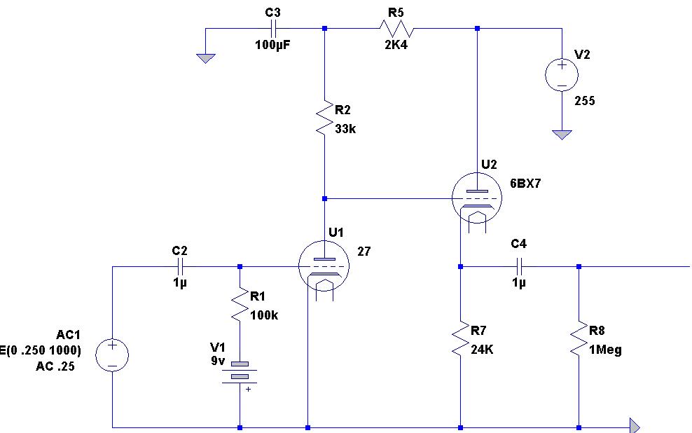

I prefer this type of layout as it is very "eligant" and "simple". I am modelling a similar cicuit with 6BX7 follower Direct Coupled to the the 27s plate output.
The less components in the signal path the better IMHO,
That is because i suggest a single stage srpp preamp: this have also reasonable output impedance.
On the other hand, my friend tell me that the sound of 6BX7 is very very good.
Francesco.
I have also heard that the 6BX7 is good. Attached is a schematic including the 6BX7 follower, direct coupling and Battery bias.

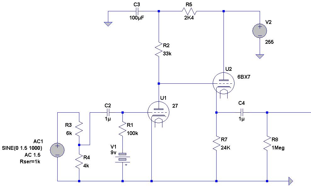

I wanted to "model" the pre-amp with this as the "source".
Since in Windows using ASIO drivers I have no volume control, I need a "master" volume control.
Could not find a "potentiometer" component in LTSpice so I modeled it as two resistors?
The data sheet indicates that the cards output is 2dBV (I assume 2V) since the driver control has the volume locked at about 75% I am safely assuming an output of 1.5V.
The sheet also indicated that the Output Z is about 1K so I specified the series resistance of the AC source to be 1K, is this a correct way to model it?
Any comments or suggestions are welcome as always!

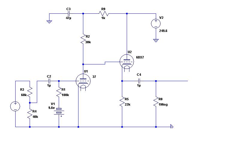

Well I revised again and came up with 37 - 6BX7.
9V Battery Bias on the grids of the 37.
Direct Coupling to the 6BX7 followers.
Power Supply is VR tube regulated.
Pict's to follow:
The sound is "OK" but the 37's are EXTREMELY MICROPHONIC!!
