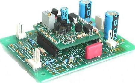

What the heck is this thing? Is it for sale? Has anyone ever seen one and what does it do.........

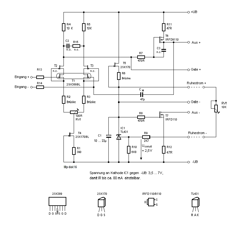

The "daughter"-PCB is a single ended class-A preamp module from UB-Elektronik:
http://www.ub-audio.de/produkte/pre.htm
The lower board is called the "Mini-pre". It`s a preamp module that can be either stuffed with different IC OP-Amps or extended with the discrete "UB-Audio-Modul" as shown in your picture .
I don`t know why the datasheet (complete construction manual with schematic, parts list, PCB layout etc.) don`t show up currently but when You`re interested I could send it (PDF 787kb) to You as I have downloaded it at a former time.

Edit: this is what the mini-pre looks like according to UB-Audio.
Hm, probably this picture is two boards, so if they have made a
redisng, maybe they are not that much different?

Hi Christer,
take a closer look. Although it is not obvious at the first glance, the "motherboard" is the same as the "Mini-pre" here (linked from the site given in my previous post) :
http://www.ub-audio.de/produkte/mp.htm
Some parts are somewhat differently stuffed at this picture but it is actually the same circuit.
The daughterboard is this one (the according picture obviously seems not to show up):
http://www.ub-audio.de/produkte/m12.htm
When the "Mini-Pre" should be configurated with the "Audio-Modul" instead of OP-Amps, the "Audio-Modul" daughter-PCB takes place right above where the OP-Amp is shown at the "Mini-Pre" picture as shown in Fred`s picture.
In the UB-Elektronik manual that I have (download from the bottom of the Audio-Modul page does not work at the moment also, at least for me) there is a picture which looks exactly like the one Fred showed above.

I ran into this by accident while looking for something else........ and yes I knew what it was, since the picture came from the website. It seems the product hasn't been released yet but is due in March I think. This design bears a basic topology resemblence to one of the DIY op amps in Mr. Pass's article. Also, the IRF mosfets it uses have been used by Mr. Pass in a published DIY project and one of the pair in the Aleph 3 I believe. I guess I was not the only one who had not seen it.............. 😕
